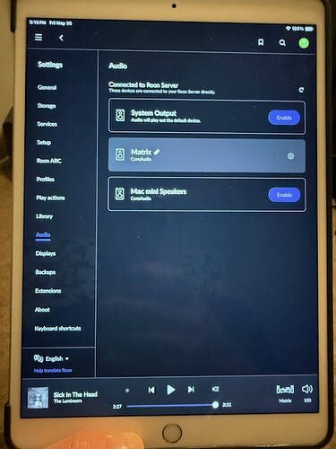

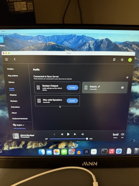

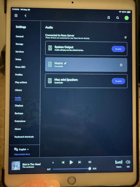

Would you kindly provide us with the screenshot of the Roon → Settings → Audio from both Mac devices.
Here you go. The one showing the mountains in the background on the screen is the endpoint.
Hi @Ted_Rushworth ,
Thanks for the screenshots. Just to confirm, you didn’t use Time Machine / Migration Assistant to restore one Mac to the other, is this correct? You can try to perform a RAATServer refresh on the Mac not showing the Schitt.
