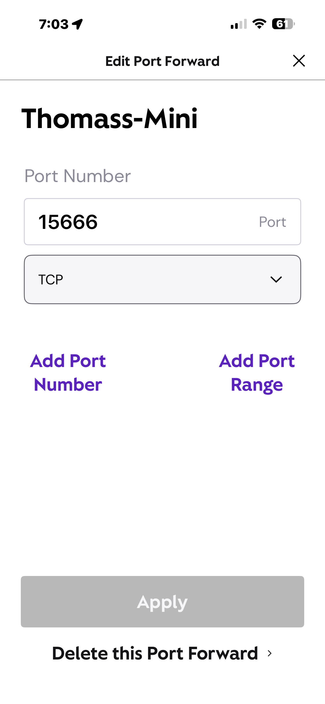

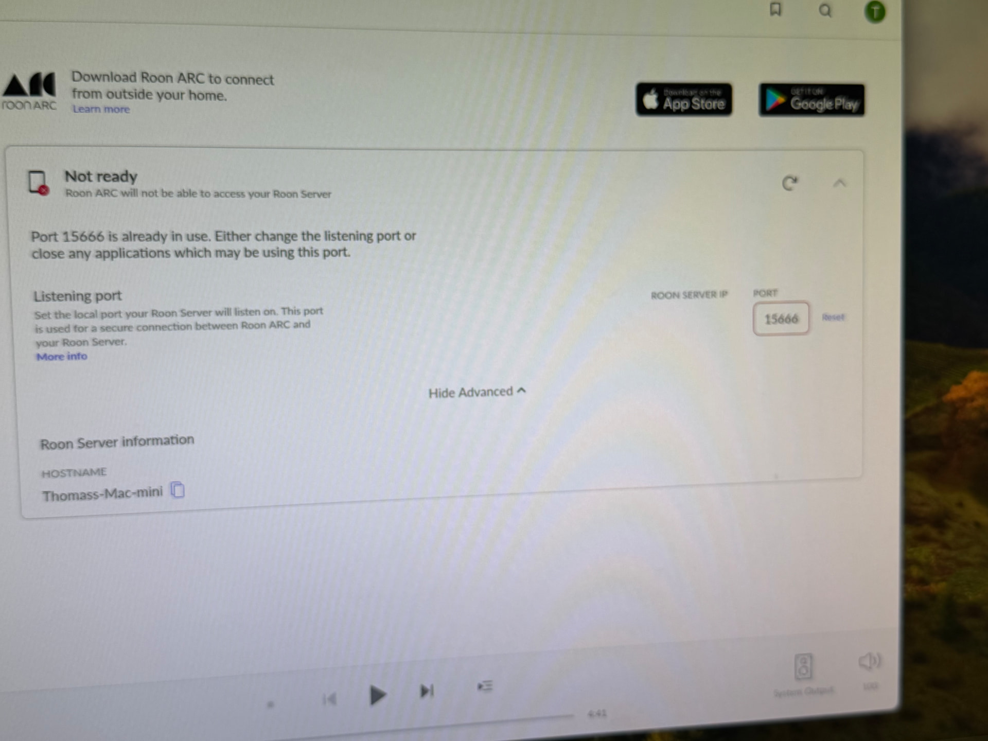

No matter what port I choose, it says port is in use. I’ve attached the photos requested. Please advise.

Thanks for the screenshots, they pointed us somewhere new.
It looks like you have a second Roon Server on your network. Your MacBook Air is running one alongside the Mac mini, and that’s almost certainly what’s behind this.
Two Roon Servers on the same network both try to claim a port mapping on your Xfinity gateway. Whichever one asks first gets it, and the other is told the port is taken, which is the message you’re seeing. It doesn’t matter which server you consider “the real one”; an inactive Roon Server still does this. That also explains why every port number you try comes back the same way. Your logs show the port jumping from 57000 to 55000 to 55002 in about twenty seconds, which is what it looks like when two servers keep re-claiming ports from each other.

One note on the screenshot from your phone: the Apply button was greyed out, so we can’t tell whether that 15666 rule was ever actually saved. Worth confirming it’s in your active port forwards once you get to step 4.
