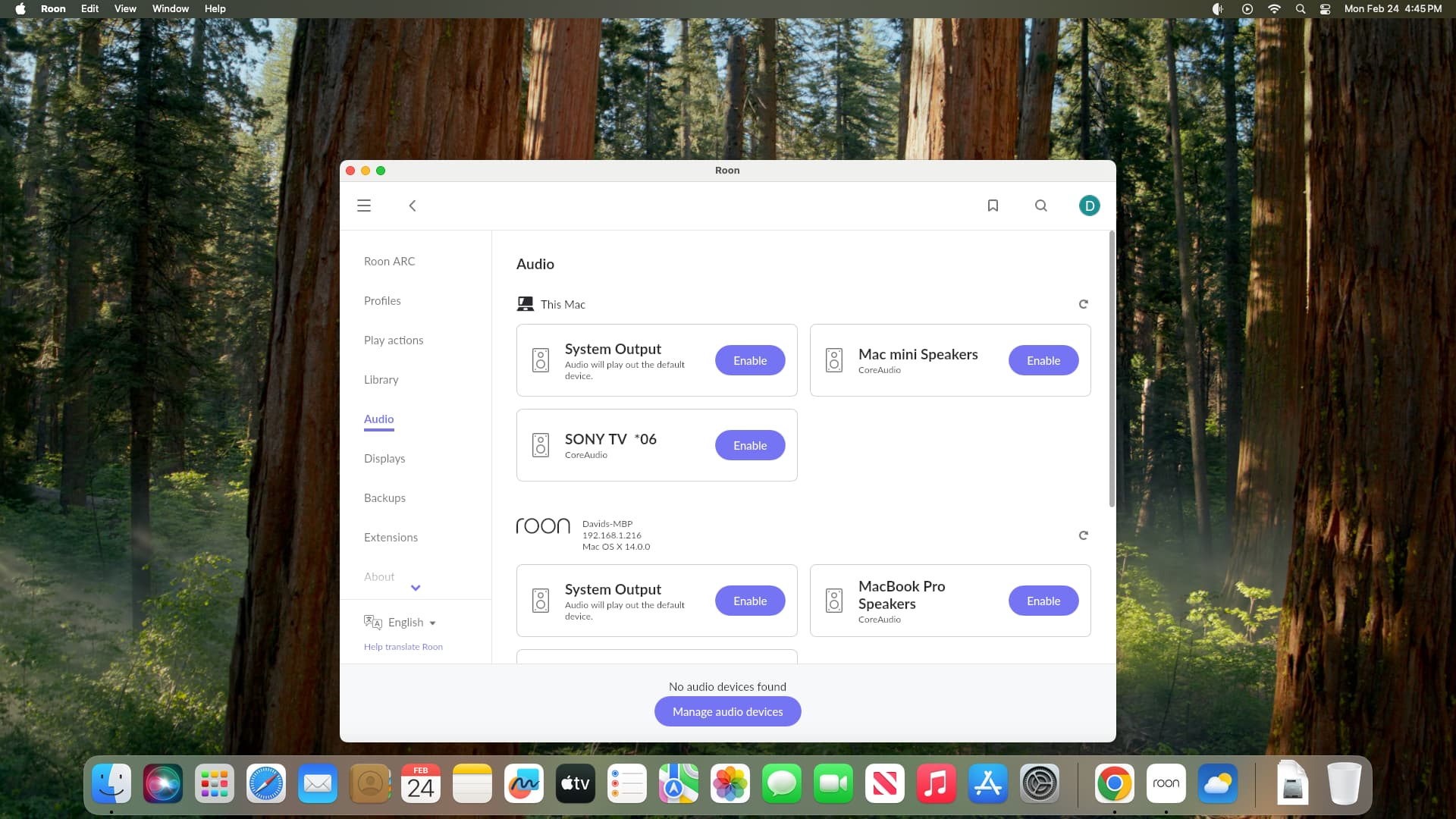

Rebooted all, and now on the Audio page in Roon, I am seeing Roon with no Enable button and an IP address associated with the Mac Mini. How do I get the Enable button back for Roon?

Screenshot of Audio Page attached.

Thanks for sharing the screenshot. I am looking over your account details and I am still seeing your dCS on a 169... address range. This usually happens when a device can’t get a proper IP address on the network. Have you made any changes regarding your network recently?
Is there any way you can try to find the IP address of them using another method (such as the dCS app)? Also please note that it is best if you reply using your @david.salsberg forum email, as you used that account to create this forum post and the troubleshooting history is properly tracked.
