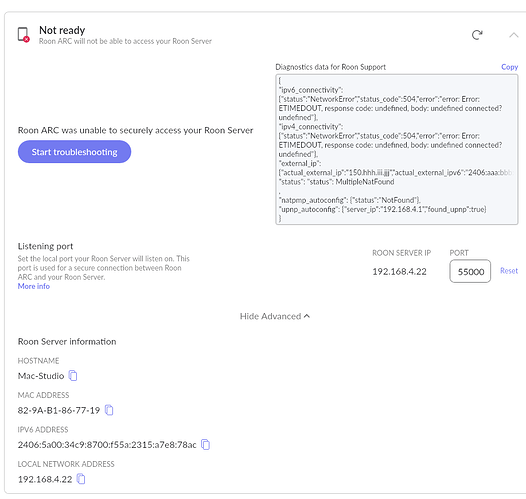

Mac unable to connect to Roon ARC (ref#Q3SQWG)
Network Setup
· My only router was provided by my ISP
ARC Status
· ARC is *Not Ready*
Roon Error Code
· “natpmp_autoconfig”: {“status”:“NotFound”}, “upnp_autoconfig”: {“status”:“NotFound”} }
Have you successfully located and enabled the UPnP or NAT-PMP settings in your router's web UI?
· I've turned UPnP/ NAT-PMP on and ARC won't connect
Select the Diagnostic Keyword or Text String
· Something else
Don't give up yet.
· I'm stuck. I'd like to create a post to ask Roon Community for help.
mac not connecting to roon arc
Mercury NZ/Eero 6+ router/wireless/mac OS 15.4.1

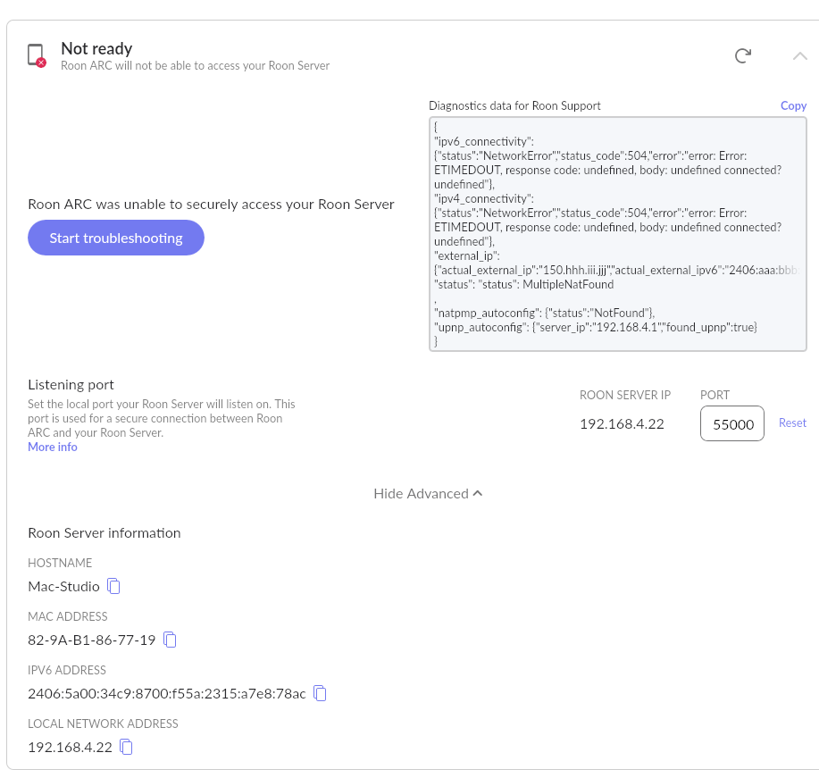

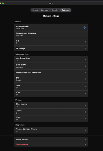

Hi, thanks for the options but nothing seems to work, I’ve attached a screenshot of my ARC settings in Roon plus my router options. Cheers
Hi @Nick_Young,
Sorry that you’re still having trouble with port forwarding. Can you show us the port forwarding rules you put into place on your router?
