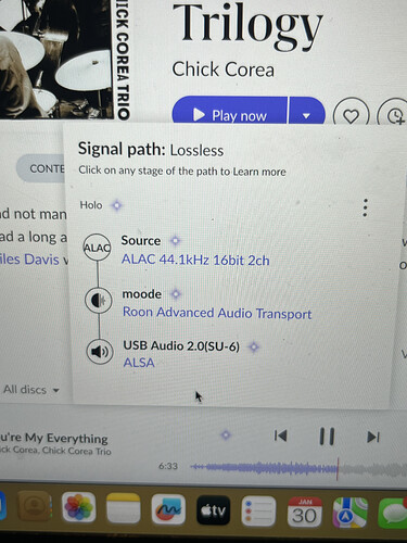

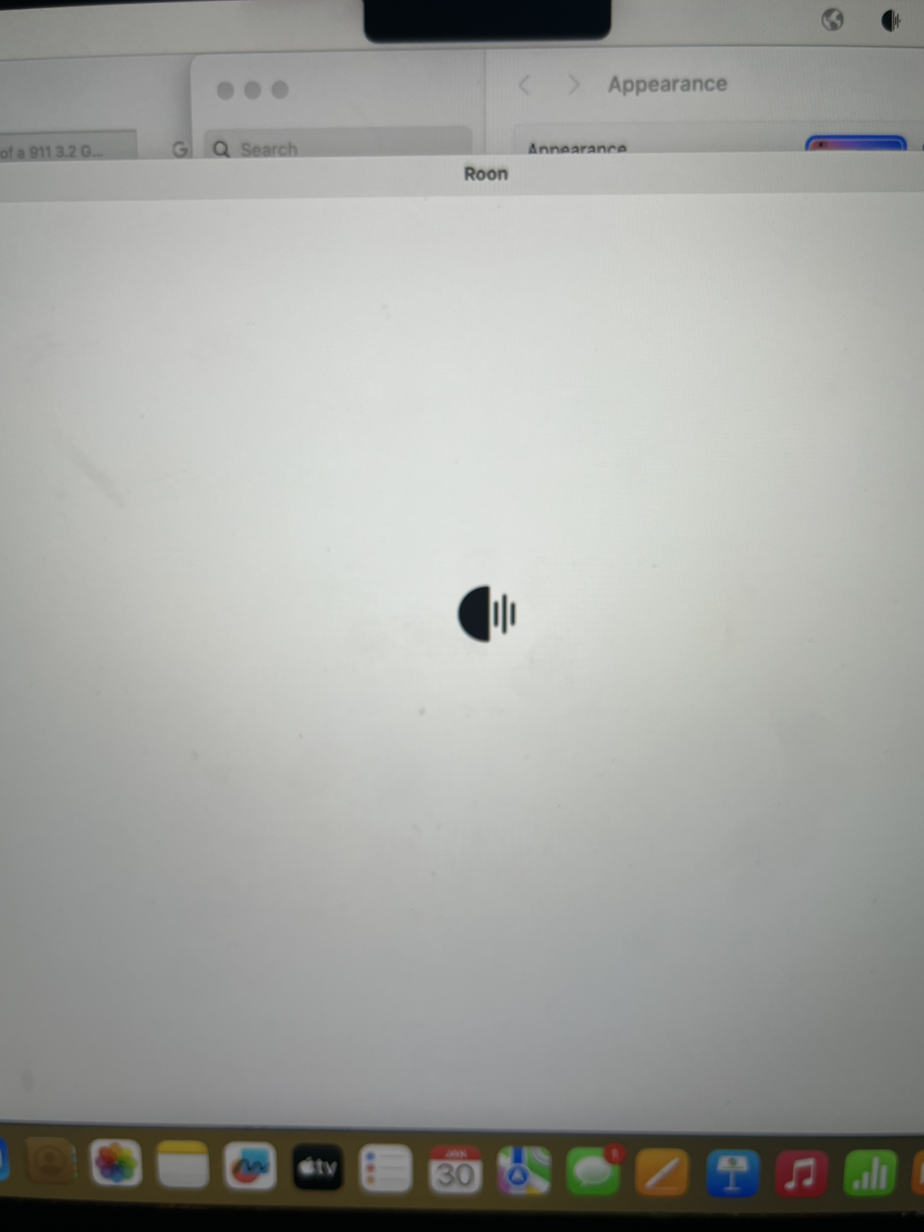

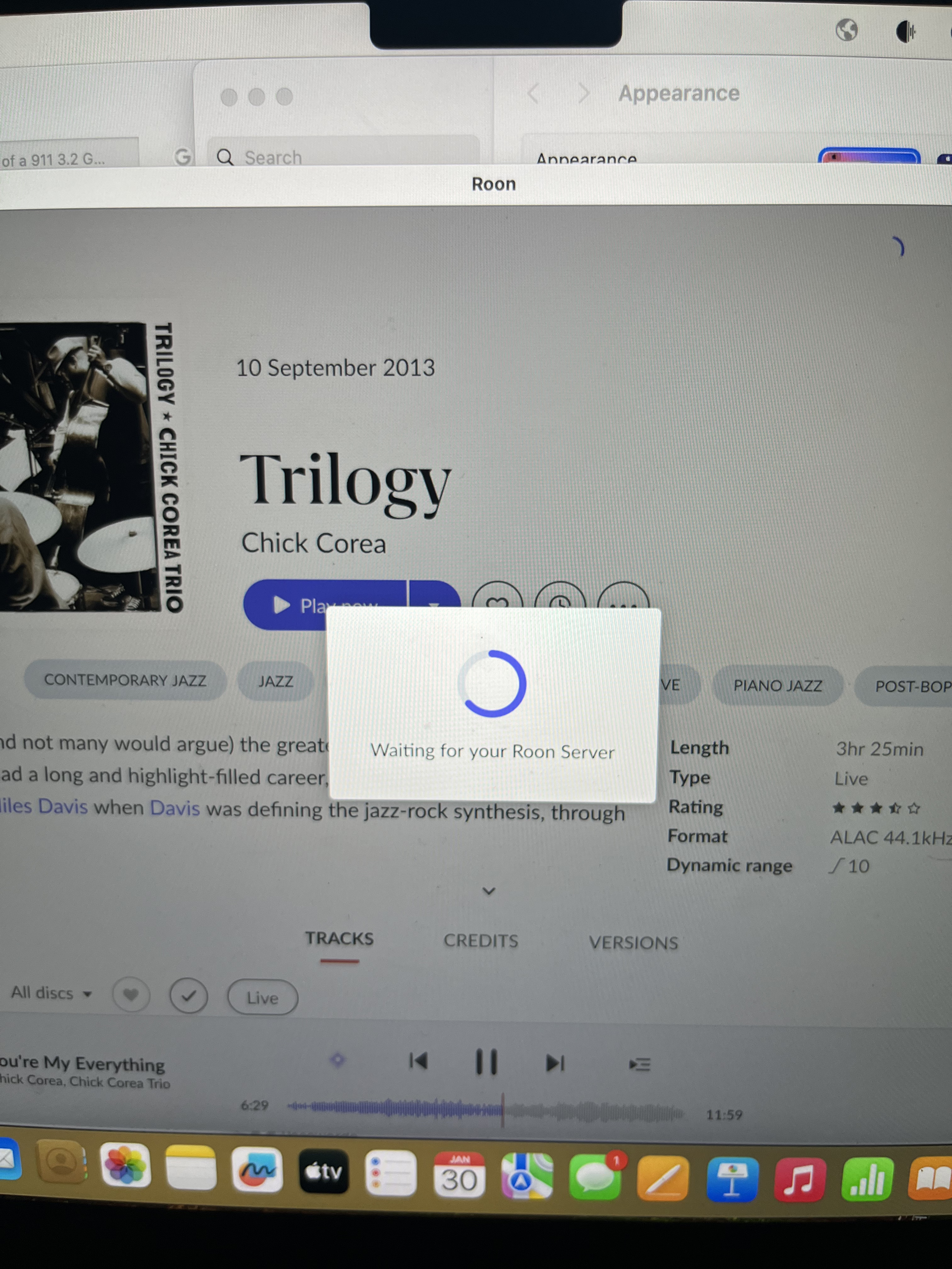

I use MacBook Air 2024 as my core and server, For many months it freezes for about a minute and says "connecting to server" then everything resets. It happens when I use my hardest in the NAS / or tidal steaming.I have no firewall, wifi is normal, I tried reinstalling and rebooting countless times. Roon has "launch on startup" turned on. I tired all your advices on the forum. It seems I am not the only one with this issue

Same freeze happened after one track
