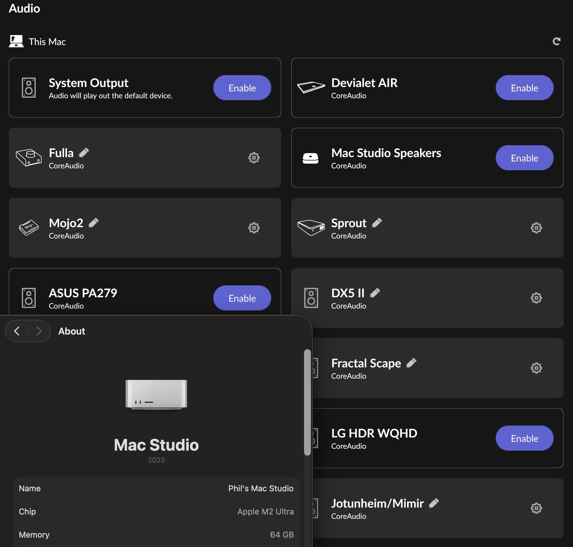

· I have several Macs running on my local network with attached endpoints. Roon confuses one of them (a MacBook Air) with the Mac Studio I use for most of my streaming; when I open Roon on the MBA, in Settings --> Audio, "This Mac" shows the devices connected to the Mac Studio and devices I connect to the MBA (DACs) don't show up in the Audio tab on either the Mac Studio or the MBA.

Did you use Time Machine to restore an image fro one device to another?
Hello @Phil_Brady ,
Thanks for reaching out. We are aware of a similar behavior when Time Machine / Migration Assistant is used to transfer one Mac over to the other. If this is what has happened here, we have sent advanced troubleshooting instructions to your private message on this forum (green “1” in top right avatar). Let us know if it helps!
I did, which I’m sure didn’t help. Though I also setup a Mac Mini from the same image and haven’t had this issue; maybe I just got lucky!
Thanks, @noris ; I’ll give it a try this afternoon.
The instructions from @noris worked great; thank you!
