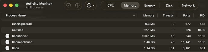

I’m using an M5 Macbook Air, which at 16GB has more RAM than the standard 8GB that the Neo has. I don’t do anything intensive on the Air that hogs memory so Roon uses the most, although it seems to be comfortably under 3GB in total.
My library is 35k, and the response I get while navigating Roon is rapid.
