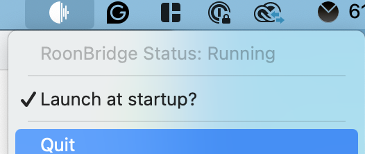

I did launch RoonBridge and see it is quickly changing from “running” to “not running” in the menu bar. Still can’t see “This Mac” on the MBP M2 running Sequoia. Nor can I see it from the MBP running Roon Core. Remote connection

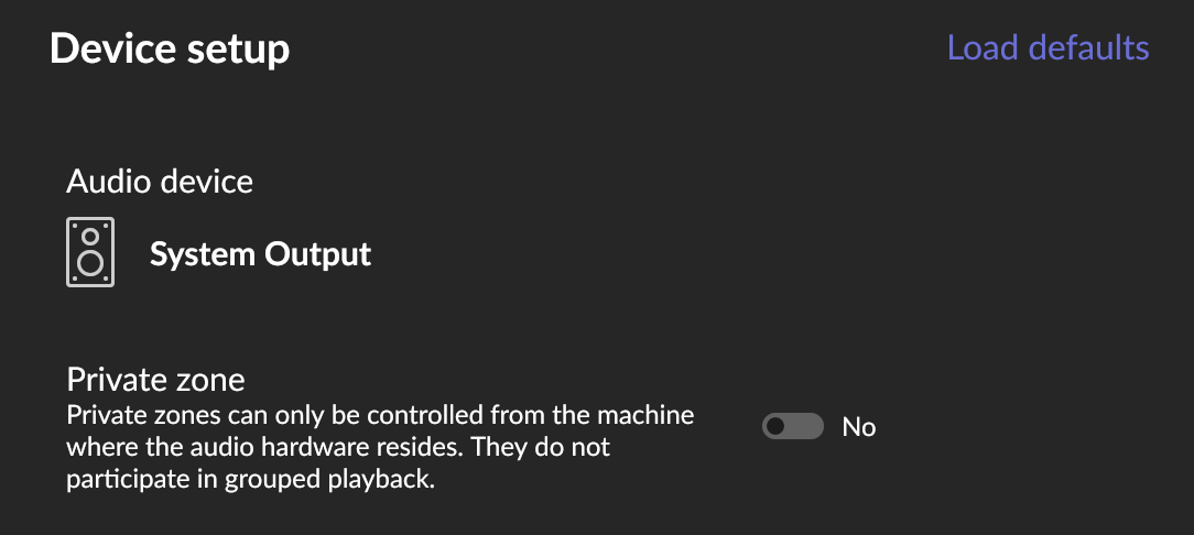

On the MacBook Pros that you want to use as endpoints, start Roon and navigate to Settings > Audio. Select the gear for the local MacBook Pro: This Mac > System Output and select Device Setup. Switch Private Zone to the off (No) position. You may need to restart the Roon apps to get the change to show up quickly.

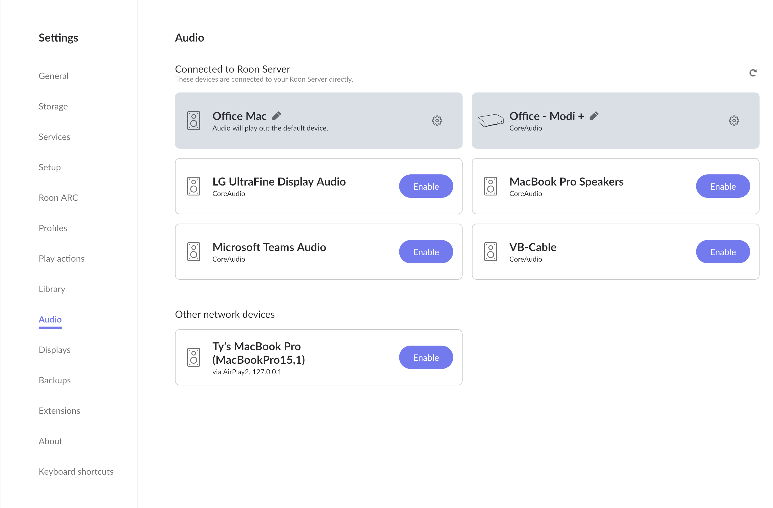

Thanks, but that’s the crux of the issue … the Mac(s) I want to use as endpoints do not show as This Mac (or local MacBook Pro, as you put it). Only the Mac hosting the Roon Server.
What you are showing is the Audio settings on the MacBook Pro running Roon Server (Office Mac). You need to start Roon on the other MacBook Pros (e.g., Ty’s MacBook Pro) and follow the instructions above to enable it as an end point. The Roon App needs to be running on the others but it will not be acting as a server for those machines.

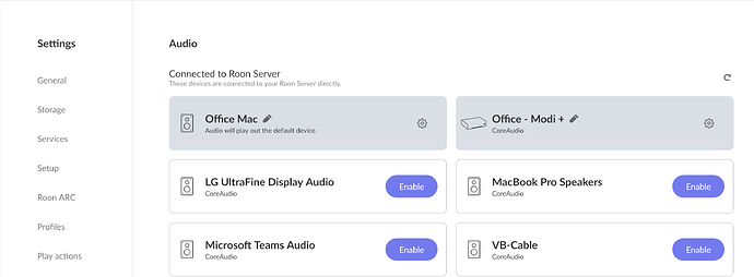

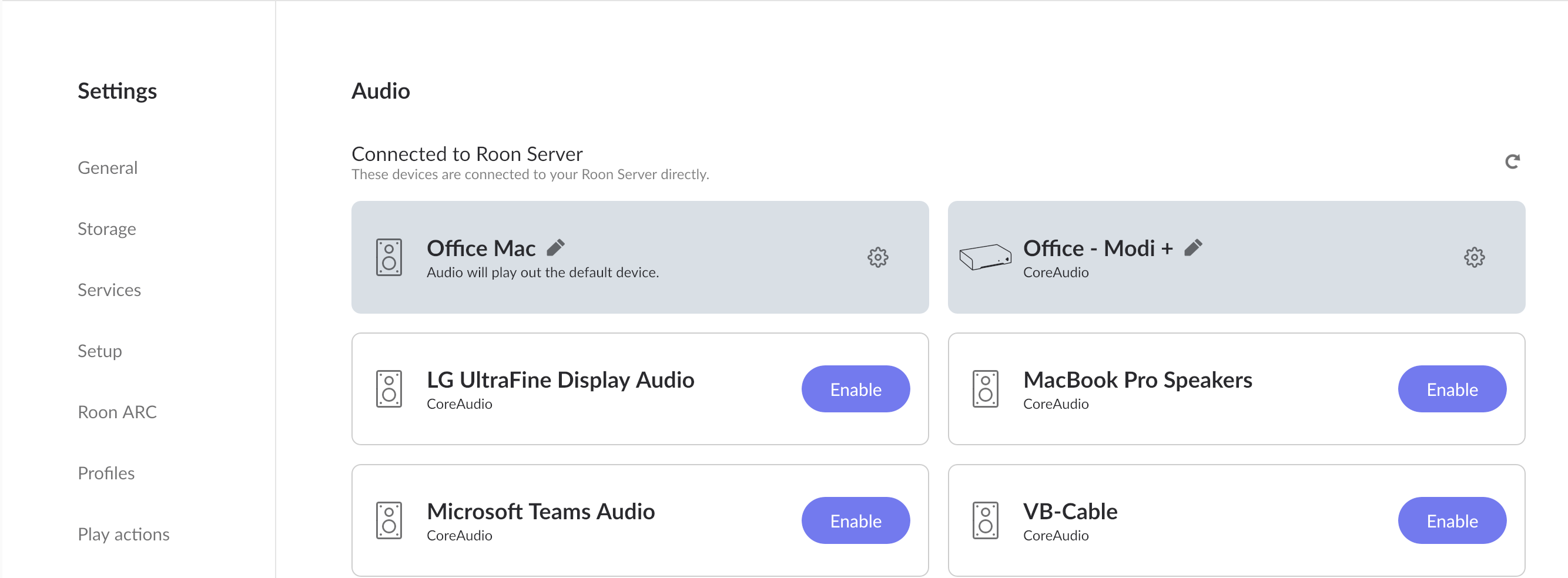

This screenshot is from the M2 MBP I want to use as an endpoint.
The Office Mac is another MBP that is running the Roon Server.
I can play from the M2 MBP but only through the MBP running the Server.
No ability to make it an endpoint or Zone.
In short, this M2 MBP is not showing up as This Mac in the Roon App running on it.

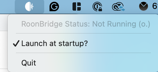

And … Roon Bridge is behaving erratically (running, not running) as showin a post above.

Hey Daniel, can you circle back on this topic? Note that I’m not getting anywhere and that RoonBridge is cycling from running and not running every second. Is that an indicator of why my M2 running Sequoia is not acting as an endpoint?
