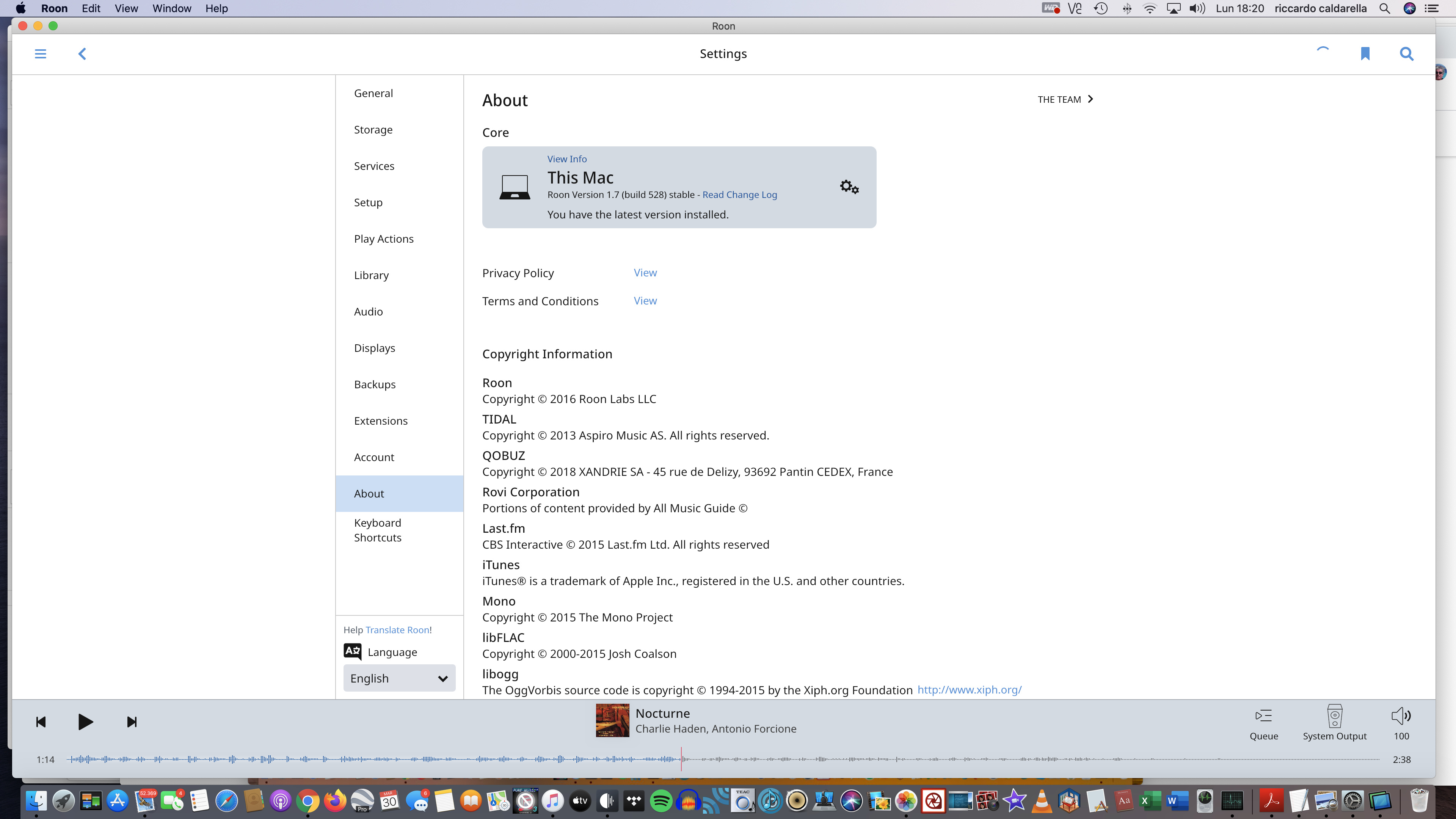

Do you see the remote Mac bridge in the about section of settings?
as you can see in screenshot of Audio settings of Core is not present Mac Bridge
No I said can you see the bridge in the ABOUT section
Like this
The thing about about is that it will show up a roon app running even if there is no DAC
Sorry for misunderstanding Roon Bridge is missing in about setting

Following screenshot is Roon Settings About page viewed on Mac Core
