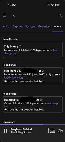

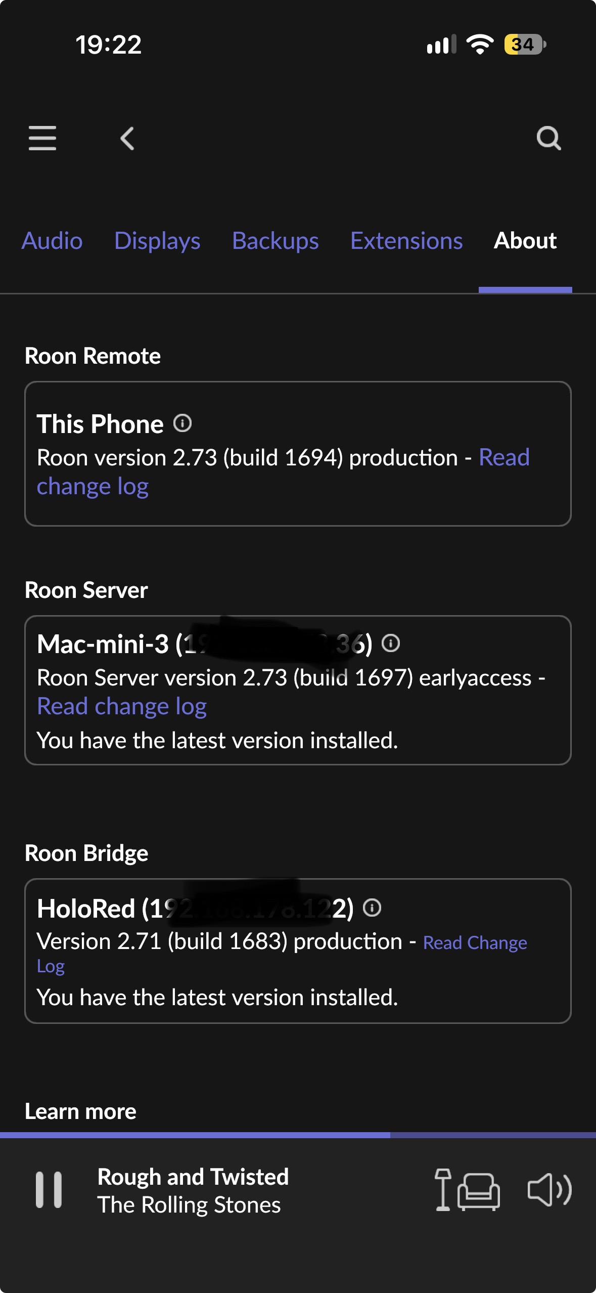

I just updated to 27.2 (beta) and Roon (2.73) (2.73.1 EA Hotfix build 1697).
No workarounds required at all. It simply just works.
2.73 or 2.73.1 (with the hotfix)?
I dunno. I just updated everything a few hours ago
Build 1697 EA is 2.73.1 … see …
I’ve updated your post.
