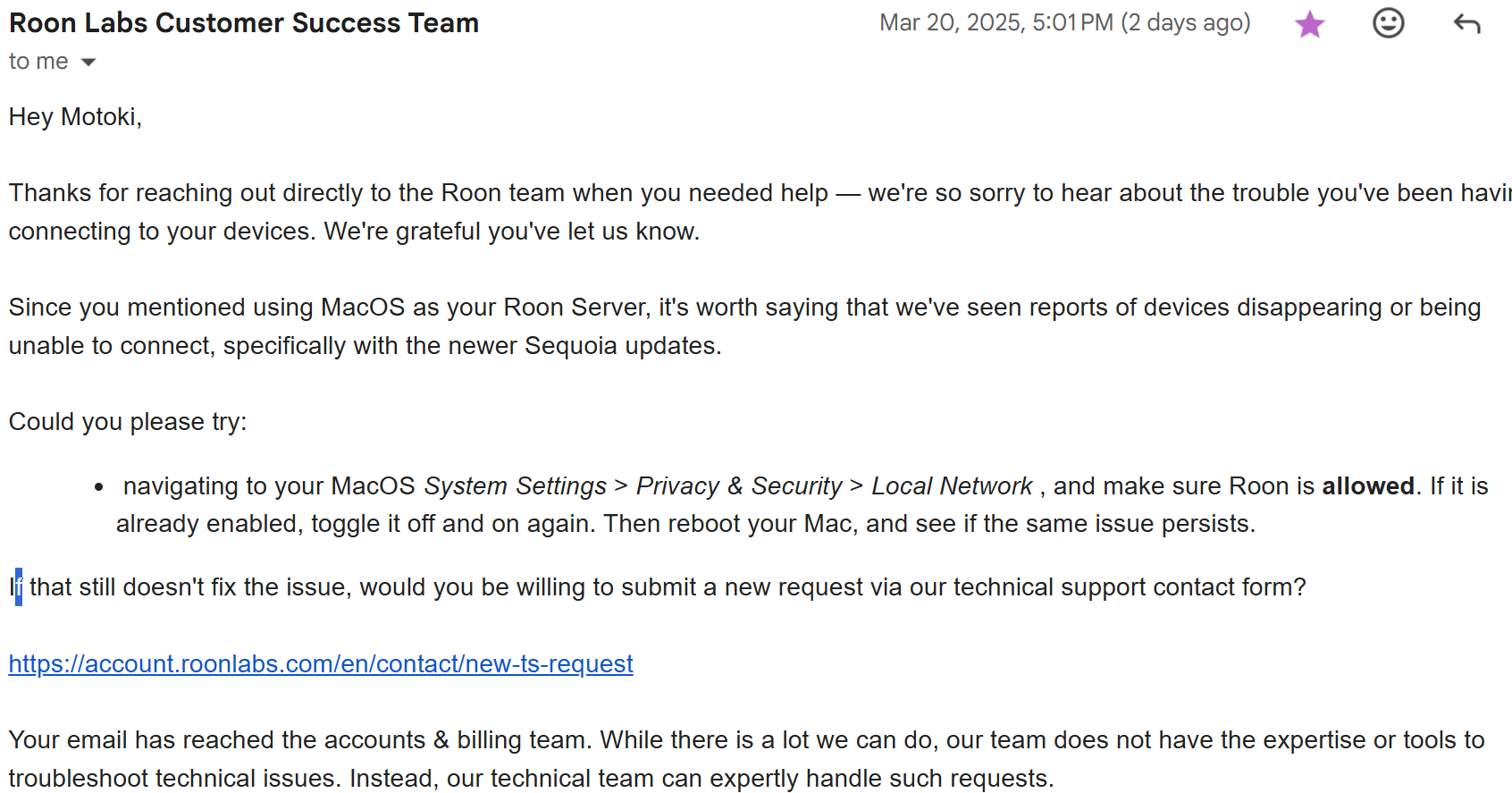

How to make roon find audio endpoints w/o toggling on/off roon allowed network access in Privacy/Security in MacOS every other day?

My Macbook pro runs on Sequoia 15.3.2. It happens almost every day when I turn it on. It was around 10 am Central Time this morning, and was about the same time yesterday. Usually I have to toggle a few times when this problem happens. For example, it did not show my roon ready devices after one toggle this morning, however it showed all other network audio devices such as roon tested, airplay, chromecast, …etc, after one toggle. I will also report to you next time when this happens with a more exact time.
Once it finds all the network audio devices, it keeps working fine all day till I turn it off and turn back on the next day.

To confirm, have you allowed Roon and Roon Server to be enabled under the ‘Full Disk Access’ setting in privacy and security?
With that, have you also added Roon and RAATServer as a firewall exception in your Mac firewall? Do you run into this issue if your Mac firewall is temporarily disabled? Here’s more info:
Lastly, it may be useful to access your Network settings (WiFi → Details) and checking whether the Mac in question is relying on a Fixed , not a rotating, Private WiFi Address.
Let me know if any of the above help! :+1:
