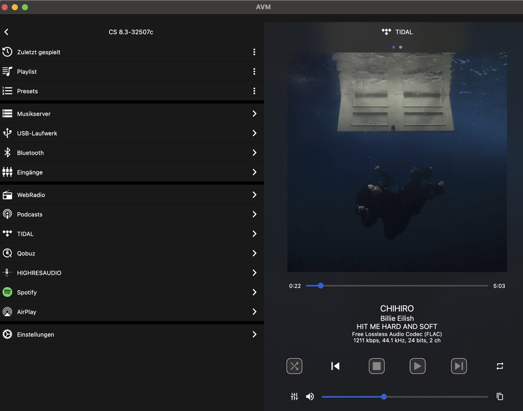

However, I have problems with the output quality:
I have your software running on a Mac Studio M2 Ultra, as output device I use AVM Ovation CS 8.3 (Roon Ready).
I play one and the same song (44.1 kHz, 24-bit) in the following ways:

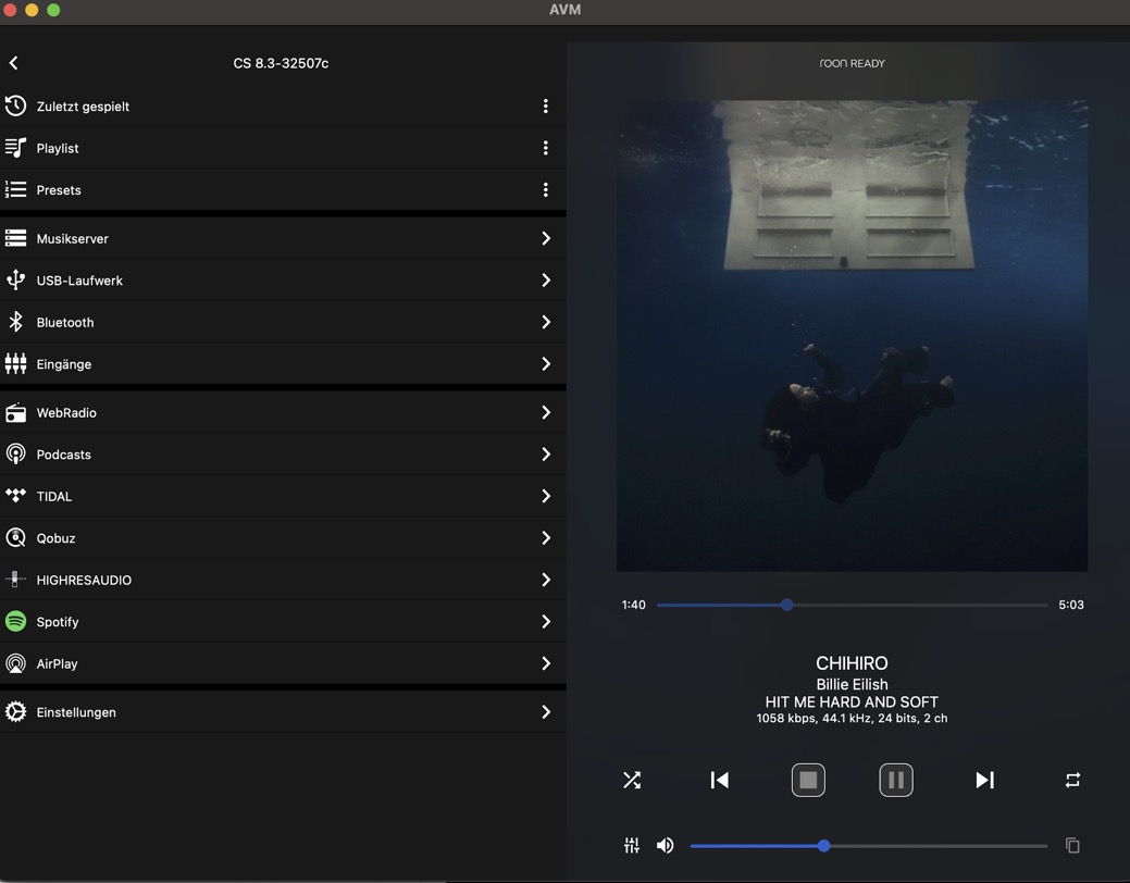

  1. via Roon Server: Data rate 1058 kbs
  2. via Tidal connect: data rate 1211 kbs
  3. direct via AVM: data rate: 1211 kbs
    The difference in sound is clearly recognizable.
Tidal connect and AVM direct sound much better than via variant 1 Roon Server.
Can you help me with this?

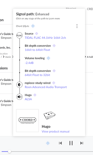

(just a Roon user) You might not get a response from Roon staff unless you file a support request on the support part of the forum. In the meanwhile, can you show the Roon signal path used in this comparison? The Roon server (whether on Mac or any other platform) does not change the digital signal in any way unless you configure it to do so, for instance with digital volume control or other DSP (digital signal processing). There is something a bit unexpected in the screenshots you shared: FLAC is a lossless compression protocol, so the bitrate from decompression on the server (as Roon does it) or on the endpoint (as the other two methods do it) should be exactly the same. This suggests that some additional processing is going on in the Roon server, such as digital volume control. Again, the signal path would tell us what’s going on.

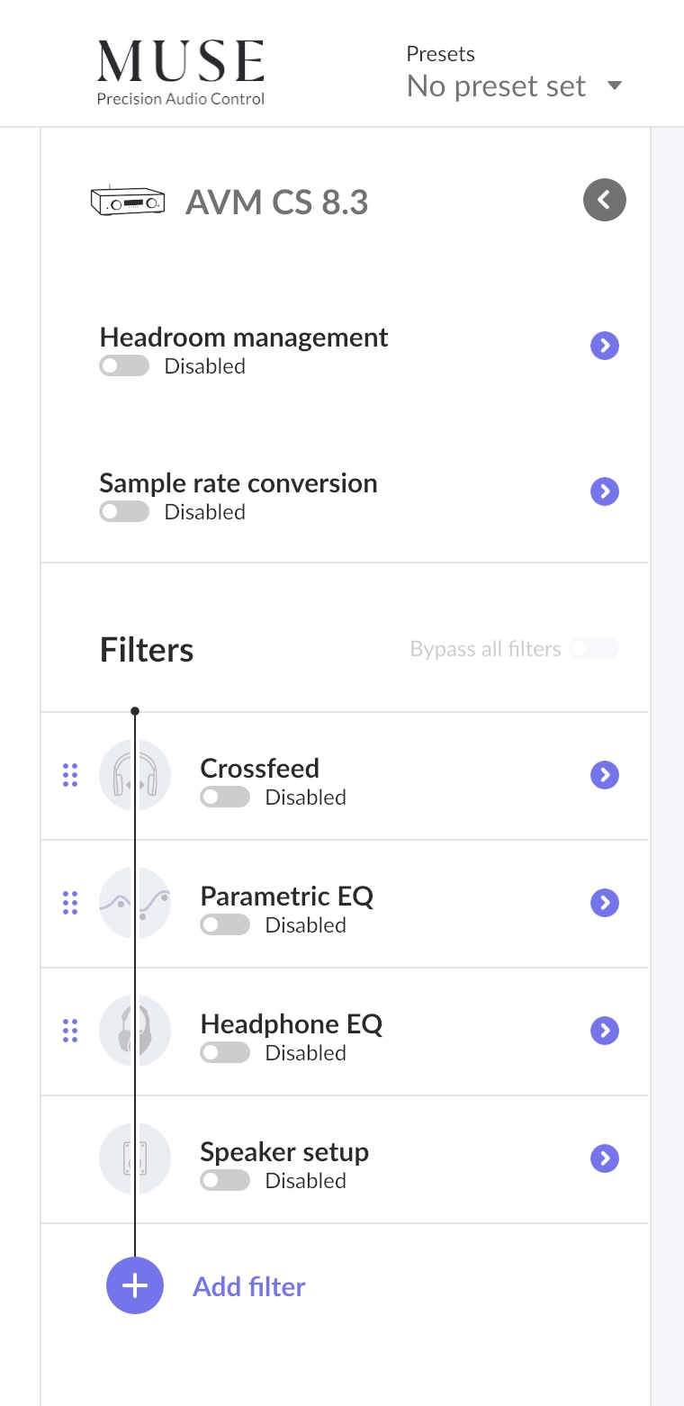

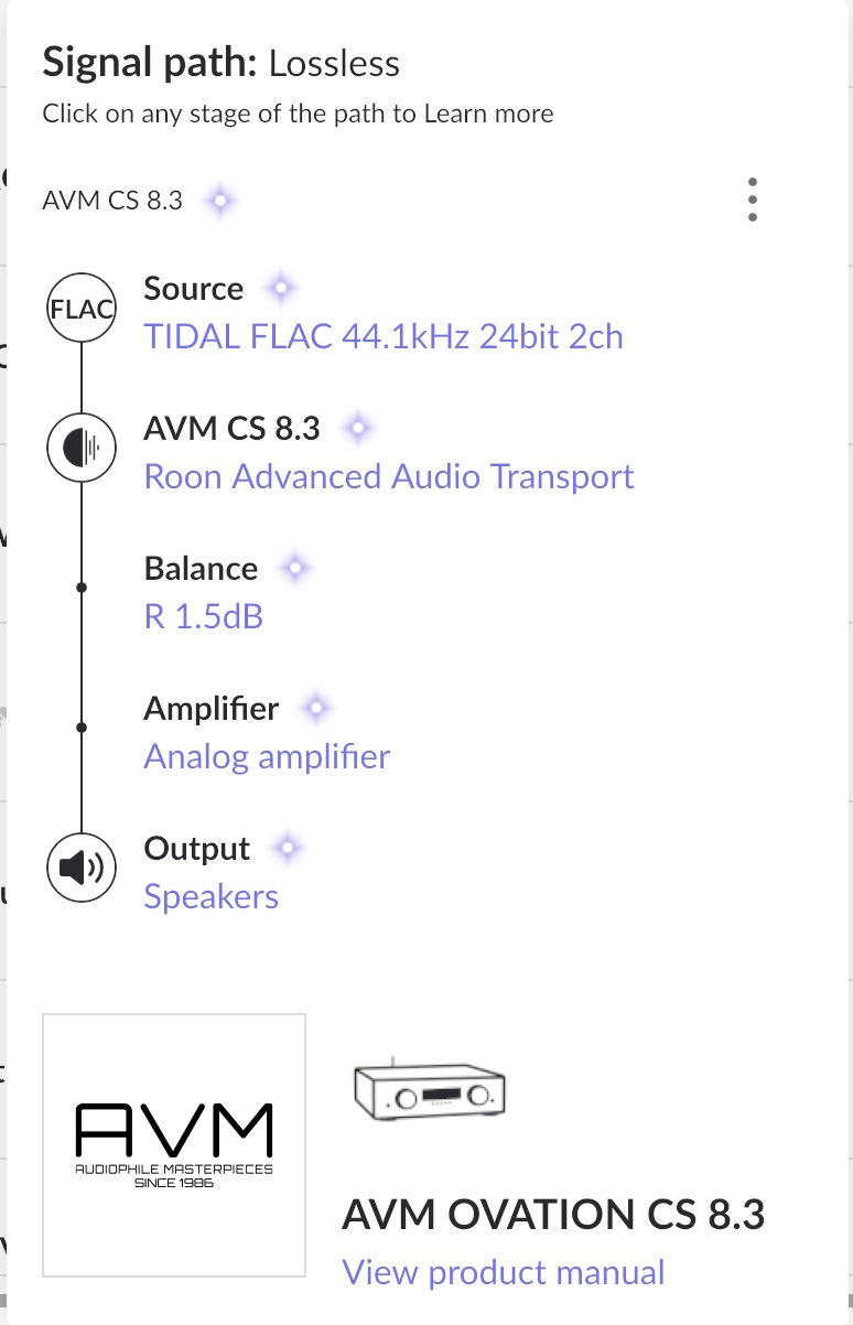

Attached are screenshots of the signal path and the MUSE settings.
First, the bit rate isn’t a relevant measure of quality for lossless media files such as FLAC. Indeed, Roon only displays bit rate for lossy codec such as MP3.
Therefore, please post the Roon signal path, as shown below.
If the same lossless FLAC file is used by both Roon and the TIDAL app, the only explanation is DSP or the sources aren’t volume matched as @Fernando_Pereira mentions. Louder music is perceived as better, which is why level matching volume is critical.
I read the data rates from the AVM CS 8.3, see screenshots in my first post.
I have sent a screenshot of the signal path.

Roon is reporting you are increasing the volume of the right channel by 1.5 db. Of course this may also be happening in the other case.
DSP to increase volume needs to be done with care. Most digital music uses the full bandwidth of the signal - and so even a very small volume increase is likely to cause nasty sounding digital clipping. This might be what you can hear. To do this safely you would need to do some DSP first to reduce the volume and give you a little headroom. However this then makes it difficult to compare different sources - because even a very small volume increase is perceived as sounding better.
You could remove the balance adjustment and see if this helps.
If this AVM is doing this in analogue the the abve doesn’t matter.
All three streaming methods report 24bit stereo at 44.1kS/s. This corresponds to a bit rate of 2116.8kbps. So if the Ovation is reporting 24bit 44.1kS/s, then that is the bit rate actually received at the DAC - not 1058kbps (Roon reported) or 1211kbps(Tidal reported)
These reduced bit rates obviously relate to the compressed stream bit rates which would be the flac file itself in the case of the two Tidal methods but may be the RAAT data rate in the case of Roon to a Roon Ready streamer. It could also be that the Tidal numbers are the actual file data including the Flac sample record overhead whilst the Roon number is just the bit rate associated with the sample data itself (and is thus smaller).

Hi, Try deleting all filters not just disabling. If you need them later you can add them back in. I have found this gets Roon much closer to the sound of me running my LUMIN X1 thru the native application.
