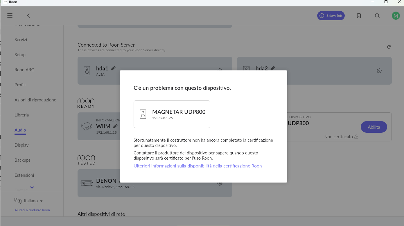

I installed roon server on NAS QNAP TS251A but when I go to enable the devices it sees my MAGNETAR UDP800 MKII but it does not let me enable it because it says that for this device there is a problem because the manufacturer of the device has not completed the certification
It’s showing as certified on the Partner page, so it should work. Have you got the latest firmware installed in it?
Magnetar Roon Ready Devices - Compatible Audio Equipment

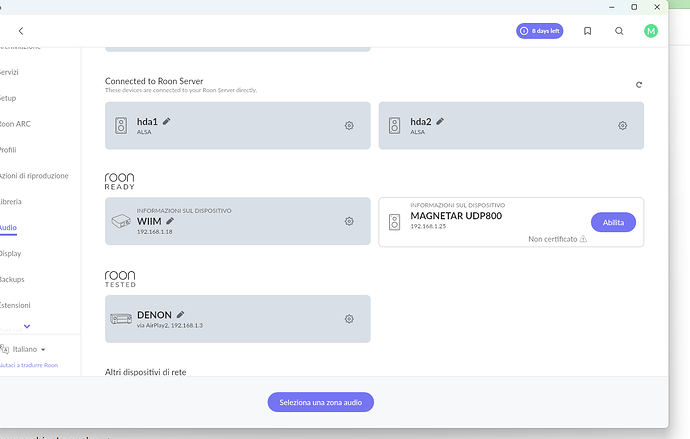

Yes, the installed firmware is the latest one, from December 2025. The strange thing is that I performed an initial installation of the server and it saw the device as HD Ready certified, but then I had to redo the installation because the SSD HD was not formatted correctly and after reinstalling the server, it sees the device as not certified. While all the other devices, like the Wi-Fi Ultra, are seen correctly and I was able to enable them.
Here’s what you see
Hello @Marco_Cacioli,
Thank you for reaching out to Roon Support.
It appears that Magnetar has updated advertisement and now lists this device simply as MAGNETAR UDP800, rather than MAGNETAR UDP800 MKII. This naming change caused the discrepancy you noticed.
We’ve already escalated this to our partners team so they can align the device listing and ensure everything is displayed correctly going forward.
Please let us know if you notice anything else that doesn’t look right.
