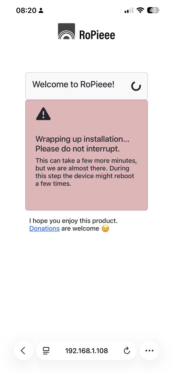

Dear all,
After several years of proper using the device,
I have stucked with the problem of updating my roppie xl software to the last version (the previous one was from 2024, so i need for reflesh my micro sd card).
SD to MANO it started installation, but after installation nothing happens (parltly logs from stage 5 and printscreen attached).
According to log files I am stuck on “leaving stage 5” (Besides that, How many stages are there?!)

Jan 23 10:10:05 ropieee systemd[1]: Starting Create Static Device Nodes in /dev...
Jan 23 10:10:05 ropieee kernel: EXT4-fs (mmcblk0p3): re-mounted 45f48e9c-efc3-4371-9b44-660affb06f08 r/w.
Jan 23 10:10:05 ropieee systemd[1]: Finished Remount Root and Kernel File Systems.
Jan 23 10:10:05 ropieee systemd[1]: Platform Persistent Storage Archival was skipped because of an unmet condition check (ConditionDirectoryNotEmpty=/sys/fs/pstore).
Jan 23 10:10:05 ropieee systemd[1]: Starting Load/Save OS Random Seed...
Jan 23 10:10:05 ropieee systemd[1]: Finished Load/Save OS Random Seed.
Jan 23 10:10:05 ropieee systemd[1]: First Boot Complete was skipped because of an unmet condition check (ConditionFirstBoot=yes).
Jan 23 10:10:05 ropieee systemd[1]: Finished Create Static Device Nodes in /dev.
Jan 23 10:10:05 ropieee systemd[1]: Reached target Preparation for Local File Systems.
Jan 23 10:10:05 ropieee systemd[1]: Starting Rule-based Manager for Device Events and Files...
Jan 23 10:10:05 ropieee systemd[1]: Finished Coldplug All udev Devices.
Jan 23 10:10:05 ropieee systemd-udevd[174]: Using default interface naming scheme 'v257'.
Jan 23 10:10:05 ropieee systemd-resolved[161]: Positive Trust Anchors:
Jan 23 10:10:05 ropieee systemd-resolved[161]: . IN DS 20326 8 2 e06d44b80b8f1d39a95c0b0d7c65d08458e880409bbc683457104237c7f8ec8d
Jan 23 10:10:05 ropieee systemd-resolved[161]: . IN DS 38696 8 2 683d2d0acb8c9b712a1948b27f741219298d0a450d612c483af444a4c0fb2b16
Jan 23 10:10:05 ropieee systemd-resolved[161]: Negative trust anchors: home.arpa 10.in-addr.arpa 16.172.in-addr.arpa 17.172.in-addr.arpa 18.172.in-addr.arpa 19.172.in-addr.arpa 20.172.in-addr.arpa 21.172.in-addr.arpa 22.172.in-addr.arpa 23.172.in-addr.arpa 24.172.in-addr.arpa 25.172.in-addr.arpa 26.172.in-addr.arpa 27.172.in-addr.arpa 28.172.in-addr.arpa 29.172.in-addr.arpa 30.172.in-addr.arpa 31.172.in-addr.arpa 170.0.0.192.in-addr.arpa 171.0.0.192.in-addr.arpa 168.192.in-addr.arpa d.f.ip6.arpa ipv4only.arpa resolver.arpa corp home internal intranet lan local private test
Jan 23 10:10:05 ropieee systemd-resolved[161]: Using system hostname 'ropieee'.
Jan 23 10:10:05 ropieee systemd[1]: Started Network Name Resolution.
Jan 23 10:10:05 ropieee systemd[1]: Reached target Host and Network Name Lookups.
Jan 23 10:10:05 ropieee systemd[1]: Started Rule-based Manager for Device Events and Files.
Jan 23 10:10:05 ropieee systemd[1]: Starting Network Configuration...
Jan 23 10:10:05 ropieee systemd[1]: Mounting /var/log...
Jan 23 10:10:05 ropieee systemd[1]: Mounting /var/tmp...
Jan 23 10:10:05 ropieee systemd[1]: Mounted /var/log.
Jan 23 10:10:05 ropieee systemd[1]: Mounted /var/tmp.
Jan 23 10:10:05 ropieee kernel: cfg80211: Loading compiled-in X.509 certificates for regulatory database
Jan 23 10:10:05 ropieee kernel: Loaded X.509 cert 'benh@debian.org: 577e021cb980e0e820821ba7b54b4961b8b4fadf'
Jan 23 10:10:05 ropieee kernel: Loaded X.509 cert 'romain.perier@gmail.com: 3abbc6ec146e09d1b6016ab9d6cf71dd233f0328'
Jan 23 10:10:05 ropieee kernel: Loaded X.509 cert 'sforshee: 00b28ddf47aef9cea7'
Jan 23 10:10:05 ropieee kernel: Loaded X.509 cert 'wens: 61c038651aabdcf94bd0ac7ff06c7248db18c600'
Jan 23 10:10:05 ropieee ropieee-usb_plugin_device[199]: ADD DWC_OTG_Controller, /devices/platform/soc/3f980000.usb/usb1
Jan 23 10:10:06 ropieee systemd-networkd[180]: lo: Link UP
Jan 23 10:10:06 ropieee systemd-networkd[180]: lo: Gained carrier
Jan 23 10:10:06 ropieee systemd[1]: Started Network Configuration.
Jan 23 10:10:06 ropieee kernel: rpi-gpiomem 3f200000.gpiomem: window base 0x3f200000 size 0x00001000
Jan 23 10:10:06 ropieee kernel: rpi-gpiomem 3f200000.gpiomem: initialised 1 regions as /dev/gpiomem
Jan 23 10:10:06 ropieee systemd[1]: Found device /dev/disk/by-partuuid/1d777da4-bd68-4630-81d9-7df978f20ba2.
Jan 23 10:10:06 ropieee ropieee-usb_plugin_device[210]: ADD 9514, /devices/platform/soc/3f980000.usb/usb1/1-1
Jan 23 10:10:06 ropieee ropieee-uboot[212]: U-Boot state partition detected...
Jan 23 10:10:06 ropieee systemd[1]: Reached target Network.
Jan 23 10:10:06 ropieee systemd[1]: Mounting RoPieee Data Directory...
Jan 23 10:10:06 ropieee ropieee-usb_plugin_device[219]: ADD ec00, /devices/platform/soc/3f980000.usb/usb1/1-1/1-1.1
Jan 23 10:10:06 ropieee systemd[1]: Starting Flush Journal to Persistent Storage...
Jan 23 10:10:06 ropieee systemd[1]: Starting Enable Persistent Storage in systemd-networkd...
Jan 23 10:10:06 ropieee ropieee-uboot[221]: ROPIEEE STAGE PTR: 5
Jan 23 10:10:06 ropieee systemd-journald[116]: Runtime Journal (/run/log/journal/803792fabd7740f397ed2cce57109126) is 2.5M, max 18.2M, 15.7M free.
Jan 23 10:10:06 ropieee systemd-journald[116]: Received client request to flush runtime journal.
Jan 23 10:10:06 ropieee kernel: smsc95xx 1-1.1:1.0 end0: renamed from eth0
Jan 23 10:10:06 ropieee systemd-networkd[180]: eth0: Interface name change detected, renamed to end0.
Jan 23 10:10:06 ropieee systemd[1]: Finished Flush Journal to Persistent Storage.
Jan 23 10:10:06 ropieee systemd[1]: Finished Enable Persistent Storage in systemd-networkd.
Jan 23 10:10:06 ropieee systemd-networkd[180]: end0: Configuring with /etc/systemd/network/10-ropieee-wired.network.
Jan 23 10:10:06 ropieee kernel: Console: switching to colour dummy device 80x25
Jan 23 10:10:06 ropieee kernel: smsc95xx 1-1.1:1.0 end0: hardware isn't capable of remote wakeup
Jan 23 10:10:06 ropieee kernel: smsc95xx 1-1.1:1.0 end0: Link is Up - 100Mbps/Full - flow control off
Jan 23 10:10:06 ropieee kernel: vc4-drm soc:gpu: bound 3f400000.hvs (ops vc4_hvs_ops [vc4])
Jan 23 10:10:06 ropieee kernel: vc4-drm soc:gpu: bound 3f004000.txp (ops vc4_txp_ops [vc4])
Jan 23 10:10:06 ropieee kernel: vc4-drm soc:gpu: bound 3f206000.pixelvalve (ops vc4_crtc_ops [vc4])
Jan 23 10:10:06 ropieee kernel: vc4-drm soc:gpu: bound 3f207000.pixelvalve (ops vc4_crtc_ops [vc4])
Jan 23 10:10:06 ropieee kernel: vc4-drm soc:gpu: bound 3f807000.pixelvalve (ops vc4_crtc_ops [vc4])
Jan 23 10:10:06 ropieee kernel: vc4-drm soc:gpu: bound 3fc00000.v3d (ops vc4_v3d_ops [vc4])
Jan 23 10:10:06 ropieee systemd-networkd[180]: end0: Link UP
Jan 23 10:10:06 ropieee systemd-networkd[180]: end0: Gained carrier
Jan 23 10:10:06 ropieee kernel: [drm] Initialized vc4 0.0.0 for soc:gpu on minor 0
Jan 23 10:10:06 ropieee kernel: vc4-drm soc:gpu: [drm] Cannot find any crtc or sizes
Jan 23 10:10:06 ropieee kernel: EXT4-fs (mmcblk0p7): mounted filesystem 8aca9d95-185a-4ae4-9924-76c7efc96e10 r/w with journalled data mode. Quota mode: none.
Jan 23 10:10:06 ropieee systemd[1]: Mounted RoPieee Data Directory.
Jan 23 10:10:06 ropieee systemd[1]: Reached target Local File Systems.
Jan 23 10:10:06 ropieee systemd[1]: Starting Save Transient machine-id to Disk...
Jan 23 10:10:06 ropieee systemd[1]: Starting Create System Files and Directories...
Jan 23 10:10:06 ropieee systemd[1]: Update is Completed was skipped because no trigger condition checks were met.
Jan 23 10:10:06 ropieee systemd[1]: Finished Save Transient machine-id to Disk.
Jan 23 10:10:06 ropieee systemd[1]: etc-machine\x2did.mount: Deactivated successfully.
Jan 23 10:10:06 ropieee systemd-networkd[180]: end0: DHCPv4 address 192.168.1.108/24, gateway 192.168.1.1 acquired from 192.168.1.1
Jan 23 10:10:06 ropieee systemd[1]: Finished Create System Files and Directories.
Jan 23 10:10:06 ropieee systemd[1]: Reached target System Initialization.
Jan 23 10:10:06 ropieee systemd[1]: Started ropieee-mount.path.
Jan 23 10:10:06 ropieee systemd[1]: Started Run RoPieee-analytics.
Jan 23 10:10:06 ropieee systemd[1]: Reached target Path Units.
Jan 23 10:10:06 ropieee systemd[1]: Reached target Timer Units.
Jan 23 10:10:06 ropieee systemd[1]: Listening on Avahi mDNS/DNS-SD Stack Activation Socket.
Jan 23 10:10:06 ropieee systemd[1]: Listening on D-Bus System Message Bus Socket.
Jan 23 10:10:06 ropieee systemd[1]: Listening on mpd.socket.
Jan 23 10:10:06 ropieee systemd[1]: Listening on Hostname Service Socket.
Jan 23 10:10:06 ropieee systemd[1]: Reached target Socket Units.
Jan 23 10:10:06 ropieee systemd[1]: Reached target Basic System.
Jan 23 10:10:06 ropieee systemd[1]: Manage Sound Card State (restore and store) was skipped because of an unmet condition check (ConditionPathExists=/etc/alsa/state-daemon.conf).
Jan 23 10:10:06 ropieee systemd[1]: Starting Avahi mDNS/DNS-SD Stack...
Jan 23 10:10:06 ropieee systemd[1]: Starting Mosquitto MQTT Broker...
Jan 23 10:10:06 ropieee systemd[1]: Starting Dispatcher daemon for systemd-networkd...
Jan 23 10:10:06 ropieee systemd[1]: Starting RoPieee Early...
Jan 23 10:10:06 ropieee systemd[1]: Starting RoPieee Prepare Reboot...
Jan 23 10:10:06 ropieee systemd[1]: Starting D-Bus System Message Bus...
Jan 23 10:10:06 ropieee systemd[1]: Finished RoPieee Prepare Reboot.
Jan 23 10:10:07 ropieee avahi-daemon[249]: Found user 'avahi' (UID 100) and group 'avahi' (GID 101).
Jan 23 10:10:07 ropieee avahi-daemon[249]: Successfully dropped root privileges.
Jan 23 10:10:07 ropieee avahi-daemon[249]: avahi-daemon 0.8 starting up.
Jan 23 10:10:07 ropieee systemd[1]: Started RoPieee LED Control.
Jan 23 10:10:07 ropieee systemd[1]: ropieee-early.service: Deactivated successfully.
Jan 23 10:10:07 ropieee systemd[1]: Finished RoPieee Early.
Jan 23 10:10:07 ropieee mosquitto[269]: 1769159407: mosquitto version 2.0.22 starting
Jan 23 10:10:07 ropieee mosquitto[269]: 1769159407: Config loaded from /etc/mosquitto/mosquitto.conf.
Jan 23 10:10:07 ropieee mosquitto[269]: 1769159407: Opening ipv4 listen socket on port 1883.
Jan 23 10:10:07 ropieee mosquitto[269]: 1769159407: Opening ipv6 listen socket on port 1883.
Jan 23 10:10:07 ropieee mosquitto[269]: 1769159407: mosquitto version 2.0.22 running
Jan 23 10:10:07 ropieee systemd[1]: Started Mosquitto MQTT Broker.
Jan 23 10:10:07 ropieee systemd[1]: Starting RoPieee API...
Jan 23 10:10:07 ropieee systemd[1]: Started D-Bus System Message Bus.
Jan 23 10:10:07 ropieee dbus-broker-launch[256]: Ready
Jan 23 10:10:07 ropieee systemd[1]: Started Avahi mDNS/DNS-SD Stack.
Jan 23 10:10:07 ropieee avahi-daemon[249]: Loading service file /etc/avahi/services/ropieee-web.service.
Jan 23 10:10:07 ropieee avahi-daemon[249]: Loading service file /etc/avahi/services/ropieee.service.
Jan 23 10:10:07 ropieee avahi-daemon[249]: *** WARNING: Detected another IPv4 mDNS stack running on this host. This makes mDNS unreliable and is thus not recommended. ***
Jan 23 10:10:07 ropieee avahi-daemon[249]: Joining mDNS multicast group on interface end0.IPv4 with address 192.168.1.108.
Jan 23 10:10:07 ropieee avahi-daemon[249]: New relevant interface end0.IPv4 for mDNS.
Jan 23 10:10:07 ropieee avahi-daemon[249]: Network interface enumeration completed.
Jan 23 10:10:07 ropieee avahi-daemon[249]: Registering new address record for 192.168.1.108 on end0.IPv4.
Jan 23 10:10:07 ropieee ropieee-api[288]: --- STARTING UP ---
Jan 23 10:10:07 ropieee systemd-networkd[180]: end0: Gained IPv6LL
Jan 23 10:10:08 ropieee avahi-daemon[249]: Server startup complete. Host name is ropieee.local. Local service cookie is 1727329364.
Jan 23 10:10:08 ropieee ropieee-api[288]: [     0.480633 INFO  helpers] listenForOsReleaseFile() watcher added for /etc/os-release
Jan 23 10:10:08 ropieee ropieee-api[288]: [     0.658824 INFO  main] version: 785b5ded58522fbf629f1b2ef38aee0967ea8a89
Jan 23 10:10:08 ropieee ropieee-api[288]: [     0.659118 INFO  main] running on: "RoPieee 2026.01 (3177)"
Jan 23 10:10:08 ropieee ropieee-api[288]: [     0.659140 INFO  main] init() start time: 2026-01-23 10:10:07.724389269 +0100 CET m=+0.056329792
Jan 23 10:10:08 ropieee ropieee-api[288]: [     0.674599 INFO  main] init() application path: /opt/RoPieee/apps/go-api
Jan 23 10:10:08 ropieee ropieee-api[288]: [     0.674741 INFO  state] creating single State object
Jan 23 10:10:08 ropieee ropieee-api[288]: [     0.674932 INFO  state] readStage() setting stage state to 5
Jan 23 10:10:08 ropieee ropieee-api[288]: [     0.674968 INFO  state] updateState() state changed!
Jan 23 10:10:08 ropieee ropieee-api[288]: [     0.675050 INFO  state] RoPieee is INITIALISING
Jan 23 10:10:08 ropieee ropieee-api[288]: [     0.675082 INFO  state] updateState() state changed!
Jan 23 10:10:08 ropieee ropieee-api[288]: [     0.675151 INFO  state] RoPieee is INSTALLING
Jan 23 10:10:08 ropieee ropieee-api[288]: [     0.675201 INFO  state] updateState() state changed!
Jan 23 10:10:08 ropieee ropieee-api[288]: [     0.675312 INFO  state] web interface is DOWN
Jan 23 10:10:08 ropieee ropieee-api[288]: [     0.675361 INFO  state] time is UNSYNCED
Jan 23 10:10:08 ropieee ropieee-api[288]: [     0.675463 INFO  state] configure is *NOT* RUNNING
Jan 23 10:10:08 ropieee ropieee-api[288]: [     0.675551 INFO  state] update is *NOT* INHIBITED
Jan 23 10:10:08 ropieee ropieee-api[288]: [     0.675562 INFO  state] finished creating single State object
Jan 23 10:10:08 ropieee ropieee-api[288]: [     0.675624 INFO  config] creating single Config object
Jan 23 10:10:08 ropieee ropieee-api[288]: [     0.728024 INFO  config] openDB() database opened!
Jan 23 10:10:08 ropieee ropieee-api[288]: [     0.733867 INFO  config] readConfig(): rows found: 91
Jan 23 10:10:08 ropieee ropieee-api[288]: [     0.733933 INFO  config] closeDB()
Jan 23 10:10:08 ropieee ropieee-api[288]: [     0.734325 INFO  config] ExportConfig()
Jan 23 10:10:08 ropieee ropieee-api[288]: [     0.741437 INFO  config] ExportConfig() db exported...
Jan 23 10:10:08 ropieee ropieee-api[288]: [     0.741494 INFO  config] finished creating single Config object
Jan 23 10:10:08 ropieee ropieee-api[288]: [     0.741723 INFO  dbus] creating single dbus object
Jan 23 10:10:08 ropieee ropieee-api[288]: [     0.741753 INFO  dbus] finished creating single dbus object
Jan 23 10:10:08 ropieee ropieee-api[288]: [     0.741771 INFO  mqtt] connect()
Jan 23 10:10:08 ropieee ropieee-api[288]: [     0.741862 INFO  config] Start()
Jan 23 10:10:08 ropieee ropieee-api[288]: [     0.742866 INFO  mqtt] received 'ConfigUpdate' signal...
Jan 23 10:10:08 ropieee ropieee-api[288]: [     0.742939 INFO  state] Start()
Jan 23 10:10:08 ropieee ropieee-api[288]: [     0.742955 WARN  mqtt] can't update config on bus - not connected!
Jan 23 10:10:08 ropieee ropieee-api[288]: [     0.743269 INFO  wsserver] creating single wsserver object
Jan 23 10:10:08 ropieee ropieee-api[288]: [     0.743343 INFO  wsserver] finished creating single wsserver object
Jan 23 10:10:08 ropieee ropieee-api[288]: [     0.743355 INFO  wsserver] listenOnChannel()
Jan 23 10:10:08 ropieee ropieee-api[288]: [     0.743521 INFO  avahi] creating single avahi object
Jan 23 10:10:08 ropieee ropieee-api[288]: [     0.743538 INFO  avahi] finished creating single avahi object
Jan 23 10:10:08 ropieee ropieee-api[288]: [     0.743574 INFO  avahi] Start()
Jan 23 10:10:08 ropieee ropieee-api[288]: [     0.743678 INFO  state] watchStateFiles() watcher added
Jan 23 10:10:08 ropieee ropieee-api[288]: [     0.743966 INFO  wsserver] ListenAndServe() 8081
Jan 23 10:10:08 ropieee mosquitto[269]: 1769159408: New connection from 127.0.0.1:39024 on port 1883.
Jan 23 10:10:08 ropieee ropieee-api[288]: [     0.771785 INFO  dbus] connect() connected!
Jan 23 10:10:08 ropieee ropieee-api[288]: [     0.771828 INFO  avahi] received 'DBusConnected' signal...
Jan 23 10:10:08 ropieee mosquitto[269]: 1769159408: New client connected from 127.0.0.1:39024 as ropieee-api-288 (p2, c1, k30).
Jan 23 10:10:08 ropieee ropieee-api[288]: [     0.773401 INFO  mqtt] connectHandler() connected!
Jan 23 10:10:08 ropieee ropieee-api[288]: [     0.775190 INFO  main] Let's GO!!!
Jan 23 10:10:08 ropieee ropieee-api[288]: [     0.775235 INFO  updater] Start()
Jan 23 10:10:08 ropieee ropieee-api[288]: [     0.776429 INFO  updater] checkRepository() timer set... 1h0m0s
Jan 23 10:10:08 ropieee ropieee-api[288]: [     0.777724 INFO  helpers] SystemManagerReady() enable systemd watchdog timer: 1m0s
Jan 23 10:10:08 ropieee systemd[1]: Started RoPieee API.
Jan 23 10:10:08 ropieee ropieee-api[288]: [     0.786222 INFO  systemd] fetchActiveState() for service avahi-daemon.service resulted in: active
Jan 23 10:10:08 ropieee ropieee-api[288]: [     0.786266 INFO  avahi] createService() created systemd service: avahi-daemon.service
Jan 23 10:10:08 ropieee ropieee-api[288]: [     0.790040 INFO  avahi] listenForSignals() start listening...
Jan 23 10:10:08 ropieee systemd[1]: Started RoPieee Bootstrap.
Jan 23 10:10:08 ropieee ropieee-api[288]: [     0.793763 INFO  avahi] update_units()
Jan 23 10:10:08 ropieee ropieee-api[288]: [     0.794429 WARN  avahi] listenForSignals() ignore unhandled signal: org.freedesktop.DBus.NameAcquired org.freedesktop.DBus
Jan 23 10:10:08 ropieee ropieee-api[288]: [     0.794630 INFO  dbus] connect() start keep-alive
Jan 23 10:10:08 ropieee systemd[1]: Starting RoPieee Sync...
Jan 23 10:10:08 ropieee systemd[1]: Starting RoPieee Web Page...
Jan 23 10:10:08 ropieee ropieee-sync[331]: *** ROPIEEE: WAITING for SYNC... ***
Jan 23 10:10:08 ropieee ropieee-api[288]: [     0.927876 INFO  avahi] listenForSignals() received ITEM_NEW: &{:1.2 /Client0/ServiceBrowser1 org.freedesktop.Avahi.ServiceBrowser.ItemNew [2 0 ropieee [RoPieee] _ropieee._tcp local 12] 12}
Jan 23 10:10:08 ropieee bootstrap[330]: *** bootstrapping ***
Jan 23 10:10:08 ropieee avahi-daemon[249]: Service "ropieee [RoPieee]" (/etc/avahi/services/ropieee.service) successfully established.
Jan 23 10:10:08 ropieee avahi-daemon[249]: Service "ropieee [RoPieee]" (/etc/avahi/services/ropieee-web.service) successfully established.
Jan 23 10:10:08 ropieee ropieee-api[288]: [     1.123674 INFO  avahi] browseItemNew() adding new unit: ropieee [RoPieee]
Jan 23 10:10:08 ropieee ropieee-api[288]: [     1.123718 INFO  avahi] browseItemNew() this is ME
Jan 23 10:10:09 ropieee bootstrap[355]: [prio_irqs] set prio for IRQ kernel process 92... done
Jan 23 10:10:09 ropieee ropieee-web[336]: --- STARTING UP ---
Jan 23 10:10:09 ropieee bootstrap[330]: ... exporting config db ...
Jan 23 10:10:09 ropieee bootstrap[330]: ... config export: fast path! ...
Jan 23 10:10:09 ropieee bootstrap[330]: ... config loaded ...
Jan 23 10:10:09 ropieee systemd[1]: Started Dispatcher daemon for systemd-networkd.
Jan 23 10:10:09 ropieee ropieee-api[288]: [     2.052138 INFO  api] Get_Version_info_v1()
Jan 23 10:10:09 ropieee ropieee-web[336]: [     0.652480 INFO  apiclient] GetVersion() done
Jan 23 10:10:09 ropieee ropieee-web[336]: [     0.652637 INFO  helpers] API connected, version: RoPieee 2026.01 (3177)
Jan 23 10:10:09 ropieee ropieee-api[288]: [     2.058627 INFO  api] Get_Version_v2()
Jan 23 10:10:09 ropieee ropieee-web[336]: [     0.791826 INFO  apiclient] GetVersionInfo() done
Jan 23 10:10:09 ropieee ropieee-web[336]: [     0.791919 INFO  helpers] API connected, version: RoPieee 2026.01 (3177)
Jan 23 10:10:10 ropieee bootstrap[330]: *** stage 5 ***
Jan 23 10:10:10 ropieee bootstrap[330]: ... Setting up Internet connection ...
Jan 23 10:10:10 ropieee bootstrap[330]: ... MAKE SURE ROPIEEE IS ABLE TO MAKE AN INTERNET CONNECTION ...
Jan 23 10:10:10 ropieee bootstrap[330]: ... waiting for internet connection ...
Jan 23 10:10:10 ropieee bootstrap[330]: ... CONNECTED! ...
Jan 23 10:10:11 ropieee bootstrap[330]: ... ready to leave stage 5 ...
Could it be on some HAT problem? as shh disabled and i don’t know how to dig dipper into the case.
Besides that, instalation of diet_pie went flawlessly and i was able to reach webGUI with the same IP adress.
Please, any ideas of step by step examination…
Thank you in advance!

@Leonid_Kravchuk
What RPI is inside your Mano Ultra mkIII?
Is it an RPI 4 or an RPI 5?
And have you downloaded the correct RoPieee-version for that type of RPI?
Kind regards, Frank.
Dear Frank, first of all thank you for promt reply!
according to logs it is Machine model: Raspberry Pi 3 Model B Rev 1.2
and i was lucky to contact Jos and Rob from Mano Hi-Fi who helped me to choose the correct image file. So i was damn lucky to install the proper one image.
regards,
Leo
Hi Leo,
I presume that you have a Ethernet-cable connected, so that you are not using WiFi, as I see that RoPieee is able to connect to the internet.
So in that case, I would restart the whole installation again, starting with flashing the “ropieee_pi3-2026.1.0-stable.20260123.3177.bin” file back onto your SD-card with the application Belana Etcher.
If that is not working, please use another SD-card. (I use SD-cards of 8GB).
Please keep us up to date how it went.
P.S. I think that there are in total 9 stages.
I have this streamer, with a Pi5. Love it! Magna know what they’re doing. Nice to come across another owner on here.
Dear Mr. Harry ten Berge (@spockfish) any ideas where to check regarding stuck on the stage 5 of wraping the ropieee 2026.01?
After stage 5 external software is being downloaded (Roon Bridge). That requires (amongst others) time synchronization. Do you have outgoing traffic blocked in your firewall or something?
Thank you for prompt reply Mr. Harry ten Berge, i also was thinking in that way of NAT or time sync, smth. at my network->dns->internet.
I will report as soon as i will check out in that direction.
Warm regards,
Leo
