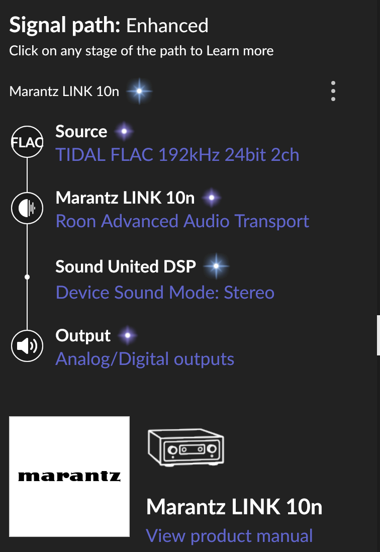

Marantz LINK 10n signal path shows Enhanced mode with Sound United DSP (ref#WPOHFR)
· Marantz LINK 10n signal path shows Enhanced — "Sound United DSP / Device Sound Mode: Stereo" (HEOS 3.139.173)
· ubiquiti ethernet
Same issue as the closed MODEL 40n thread ( Marantz MODEL 40n Signal Path Change to Enhanced (ref#NB65KH) [HEOS firmware update] ), confirming it also affects the LINK 10n — so this now spans the full Hi-Fi network line up to the flagship.
Setup: Roon Server on Nucleus Titan (Ethernet), LINK 10n as Roon Ready endpoint over RAAT. No Roon DSP enabled. Local FLAC and TIDAL etc, all affected.
Symptom: signal path changed from Lossless to Enhanced within the July 22 – Aug 5 HEOS rollout window, with “Sound United DSP / Device Sound Mode: Stereo” appearing between the RAAT stage and Output. Firmware confirmed as 3.139.173 via HEOS System Diagnostics.
Additional data point on the Source Direct question from the 40n thread: I run the LINK 10n’s fixed LINE OUT connectors, where per the manual Source Direct doesn’t apply to the output path at all — and the Enhanced label shows regardless. Consistent with this being status reporting from the HEOS module rather than anything in the audio path.
Like the 40n, the LINK 10n exposes no Sound Mode setting anywhere in HEOS or on the unit, so there is no way to change what’s reported.
Request: either whitelist a bare “Stereo” mode on two-channel units as non-enhancing, or take it up with D&M — as it stands, the label makes the signal path display less informative on these devices, and removes the at-a-glance Lossless confirmation that’s one of Roon’s best features.
Screenshot attached.
Confirming on my Link10n the direct path is not reflected - the Sound United DSP info is I believe misleading.

Thanks for the detailed report. We were able to pull and review a fresh set of server logs, which let us trace exactly where the “Enhanced” tag is coming from, and I want to be clear about that up front: it’s originating on the LINK 10n itself, not in Roon.
A bit of background on how the signal path works. Roon doesn’t decide on its own that a stage is “Enhanced”, it displays what a Roon Ready endpoint reports back about its own internal processing over RAAT. Roon is not inserting any DSP here; there’s no Roon-side processing anywhere in your path (no volume, headroom, sample-rate conversion, or EQ). What you’re seeing is Roon faithfully rendering what the device tells us about itself.
And here’s what the LINK 10n is telling us during playback, straight from the logs:
{"sub_type":"sound_mode","type":"sound_united","quality":"enhanced","mode":"stereo"},
{"method":"analog_digital","type":"output","quality":"lossless"}
Since the recent HEOS firmware, the unit is reporting an internal “Sound United, Sound Mode: Stereo” stage and self-tagging it as quality: enhanced. That’s the stage you see in the UI as “Sound United DSP → Device Sound Mode: Stereo.” Once any single stage in the chain is marked non-lossless, Roon’s headline for the whole path drops to “Enhanced” and every stage turns purple, which is why it shows on every source, including bit-perfect FLAC where nothing is actually being converted.
So to answer the underlying question directly: this is the device over-reporting a plain passthrough as an enhancing stage. It’s not something in your Roon configuration, and it’s not a DSP you can toggle off, which also matches your finding that the LINK 10n exposes no Sound Mode control.
The important part: your audio is unaffected. The stream leaves your Nucleus bit-perfect and the unit’s output reports as lossless, this is a labeling issue in the signal path, not a change to the sound.
The proper fix belongs on the firmware side: a bare “Stereo” mode with no processing applied should report as lossless (or not emit the stage at all). We’re raising this with the appropriate team, and we’ll separately look at whether Roon should treat a plain Sound United “Stereo” mode as non-enhancing on our end as an interim measure. I’ll keep this thread posted as we make headway. :+1:

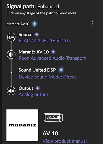

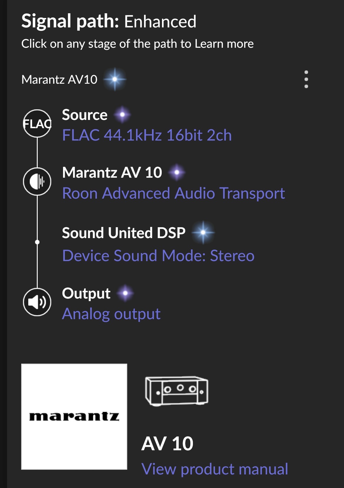

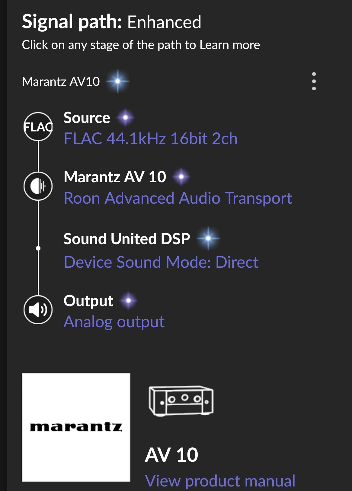

My AV10 all of a sudden

The issue - it’s the fact it says enhanced and it’s impossible to tell (without clicking on signal path every time) if that is because a DSP has been added or volume leveling et al - or it’s this incorrrct flag and is in fact direct which as u know is just as important in this space.
