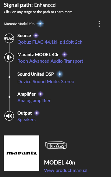

I'm seeing my Marantz MODEL 40n's signal path change from Lossless to Enhanced, with "Sound United DSP" / "Device Sound Mode: Stereo" showing as the active stage. I think this started after I updated to Roon 2.70. Nothing has changed on the amp itself in that time.
What I've already checked and ruled out:
MUSE: all filters removed, all toggles off (parametric EQ, crossfeed, volume leveling, balance, headroom management, sample rate conversion, speaker setup)
HEOS app: no EQ, sound mode, or DSP-related setting that would explain this
Source Direct: enabled on the amp (this only affects the analog tone stage, not network streaming)
Firmware: HEOS app reports "Firmware Current"
Source of material: tested both Qobuz streaming and local library FLAC files — same result in both cases, so this isn't specific to the streaming service
Setup: Roon Server running on Windows 11 PC, Marantz MODEL 40n connected via Roon Advanced Audio Transport, output confirmed as Stereo speakers.
Given the timing lines up with the 2.70 update rather than anything on the amp, and the issue is consistent across both local and streamed sources, I'd appreciate it if you could check whether this is a known/reported issue, or take a look at what might have changed in how Roon reads/reports the 40n's signal path.
Happy to send logs or screenshots if useful.
Thanks

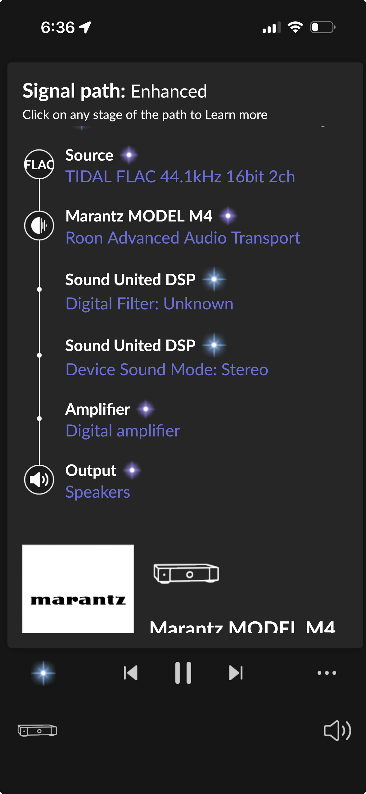

Just checked on the path showing for my M4 which is more analogous in having only the two filters which are controlled in the HEOS app - similar to the 40n, according to the manual. I seem to show 2 Sound United DSP processes. This may be truthful but not clearly informative- and I personally don’t think is an improvement. Not sure if this is a ROON or a HEOS decision!

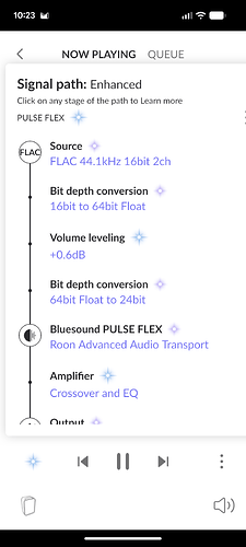

DSP is always shown as enhanced. For example, …
This shows DSP I enable in Roon (volume levelling) and inside a Roon Ready device.)
So, this is what should be expected. Roon is presenting an honest signal path. Is the Enhanced section an addition or a change of status?
