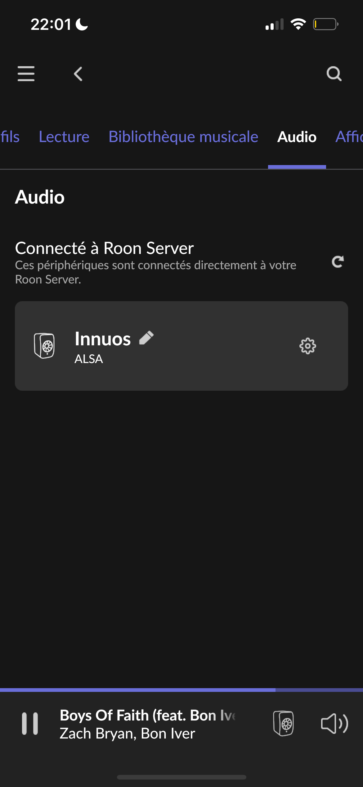

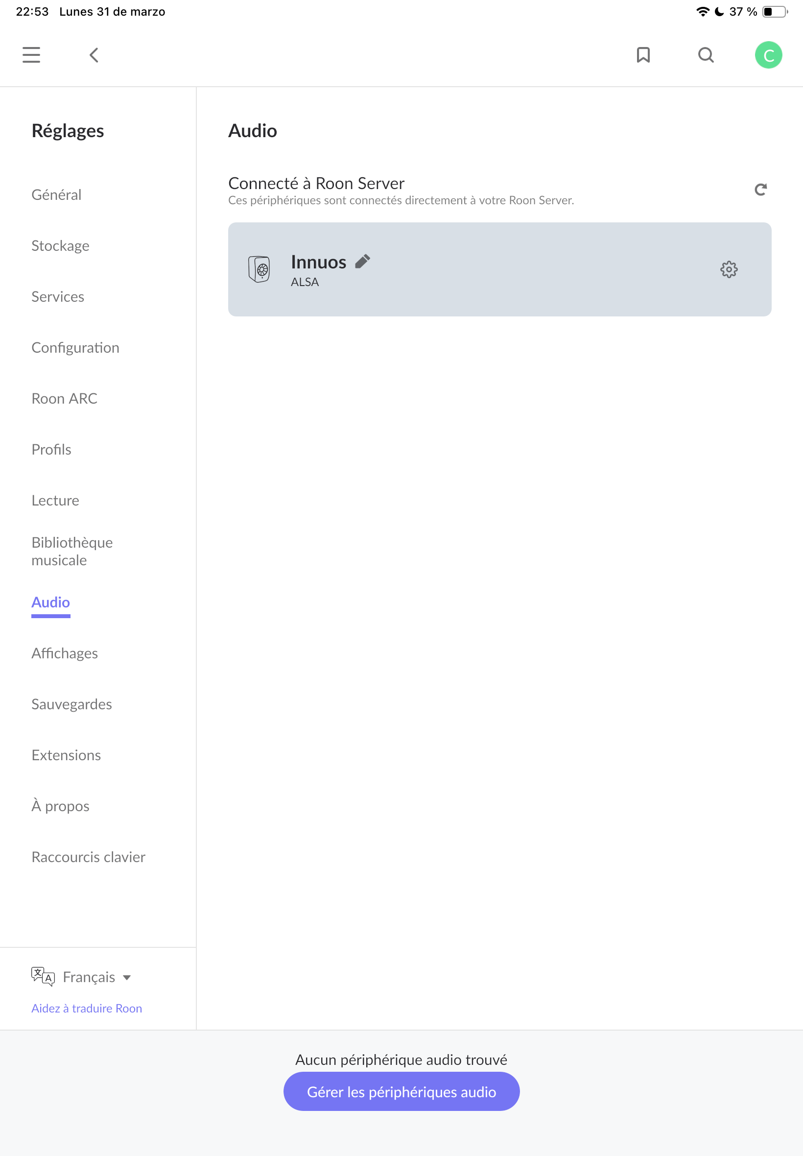

Can you also review your audio settings from another remote device outside of your mobile device, and see if your Marantz is listed properly? I see you have an iPad available - let me know your results. Thank you! :raised_hands:
Hello,

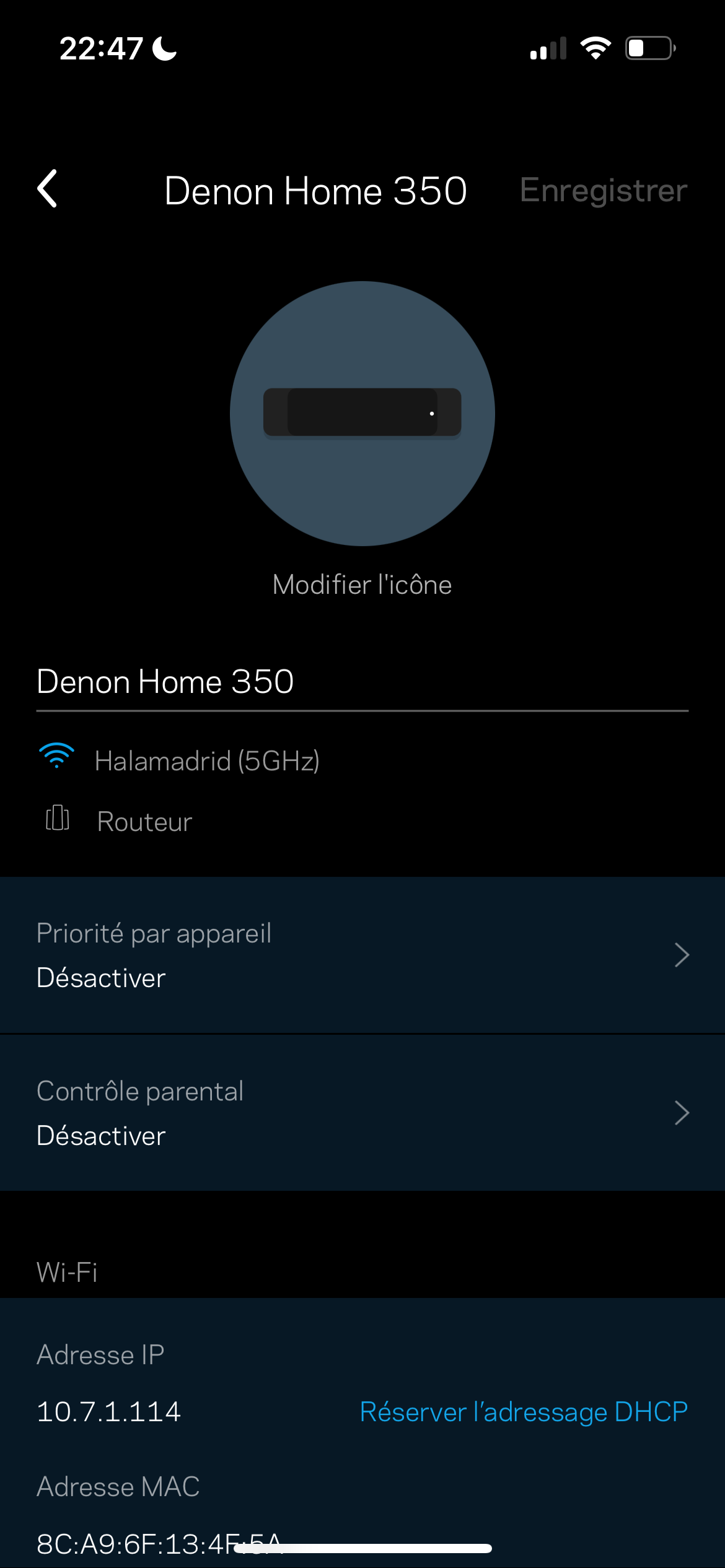

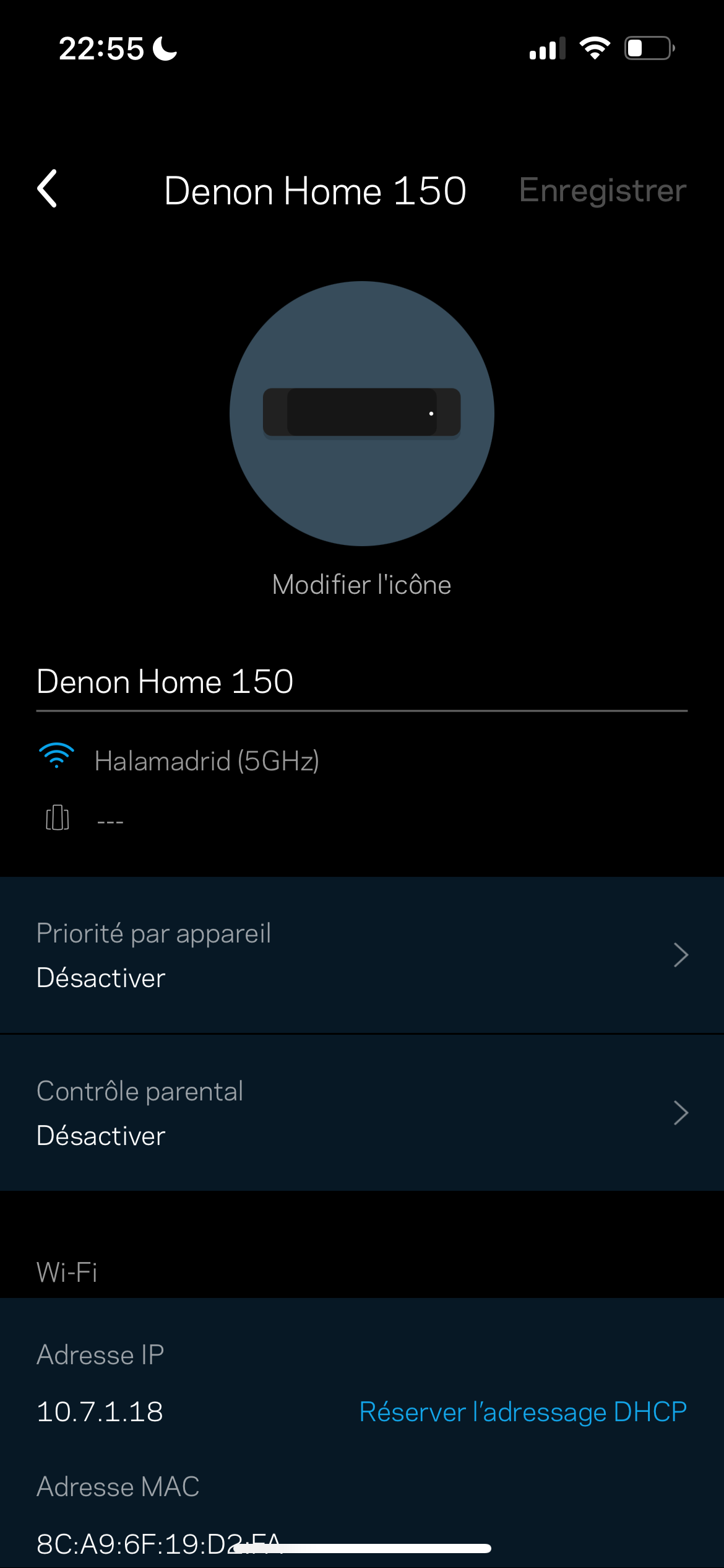

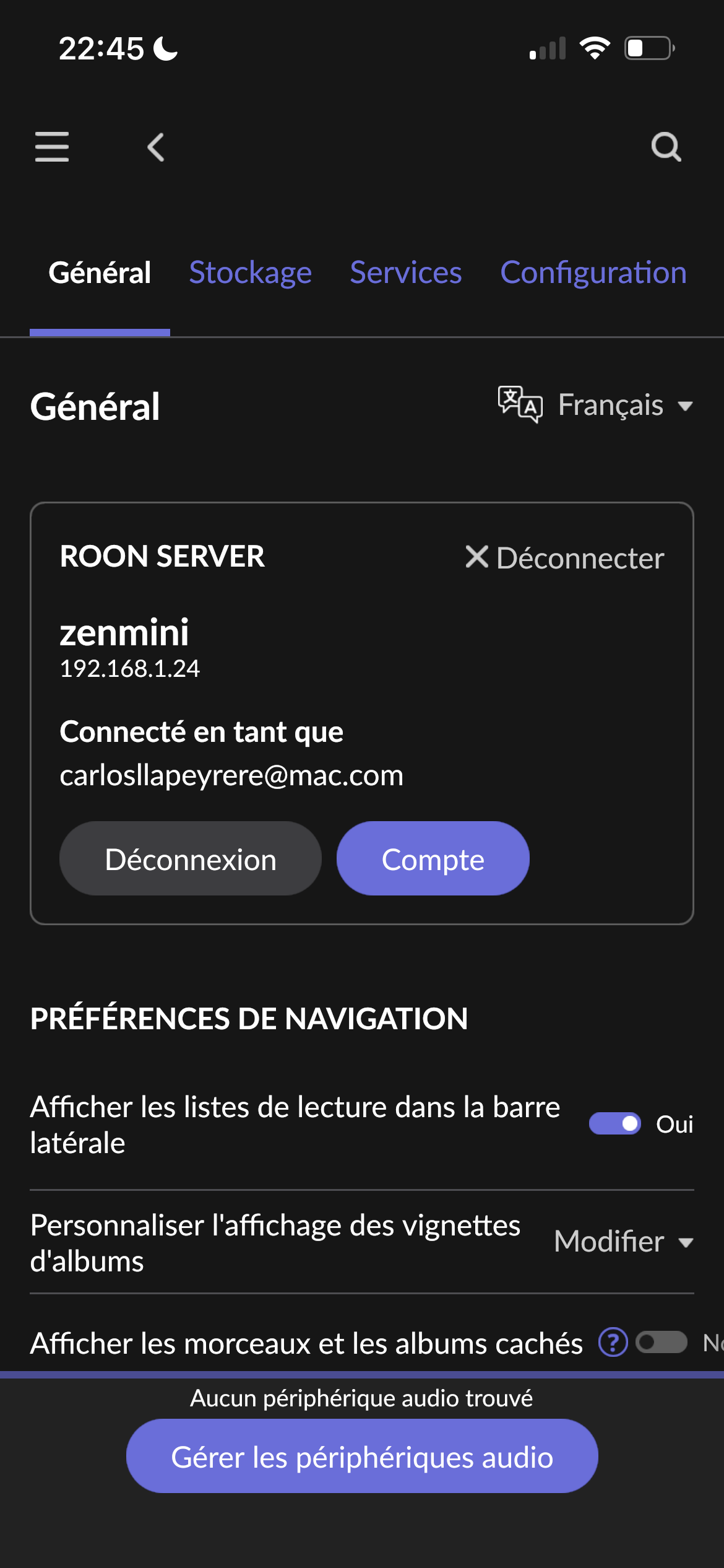

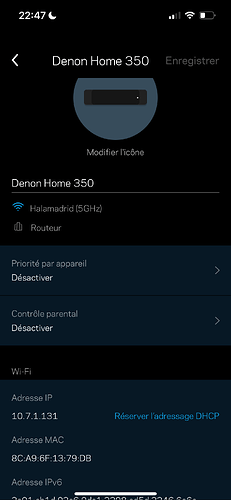

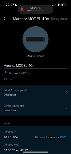

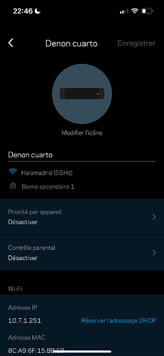

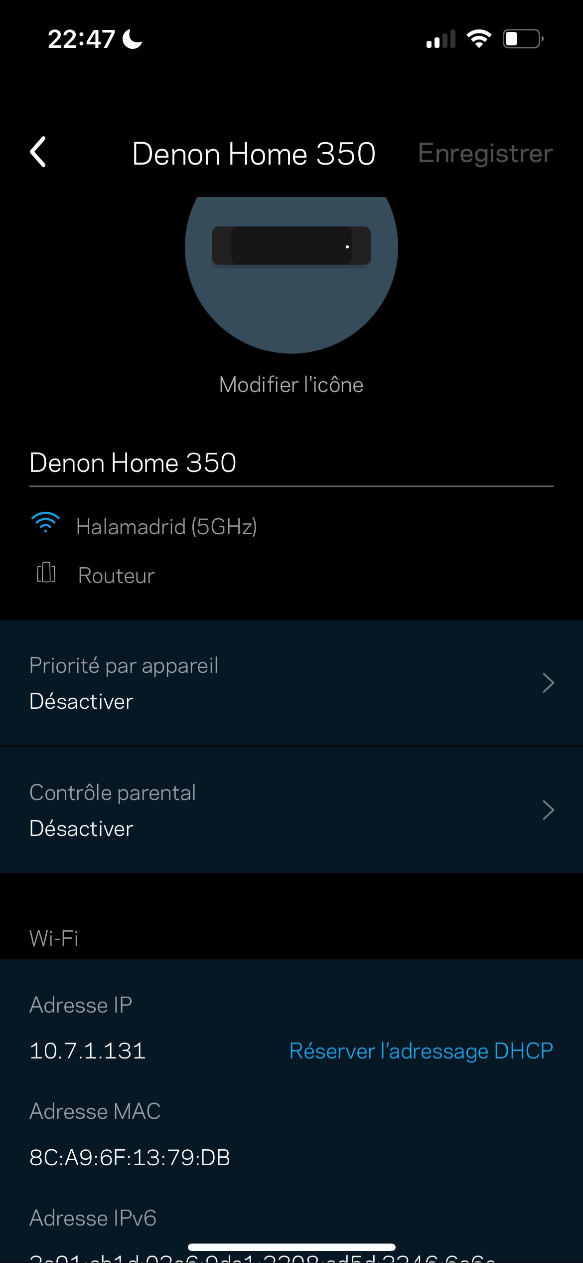

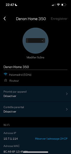

Thank you very much for your help. I am sending you screenshots of my devices and the screenshot from an iPad (Marantz does not appear in Roon’s Audi options).
Hello @Carlos_Lopez1 ,
Based on your screenshots above, it looks like the Zen Mini is on a 192.168.1.XYZ subnet while your Denon/Marantz is on a 10.7.1.XYZ subnet. For Roon to work properly, the devices need to be on the same subnet. Do you have an additional router in your network setup?

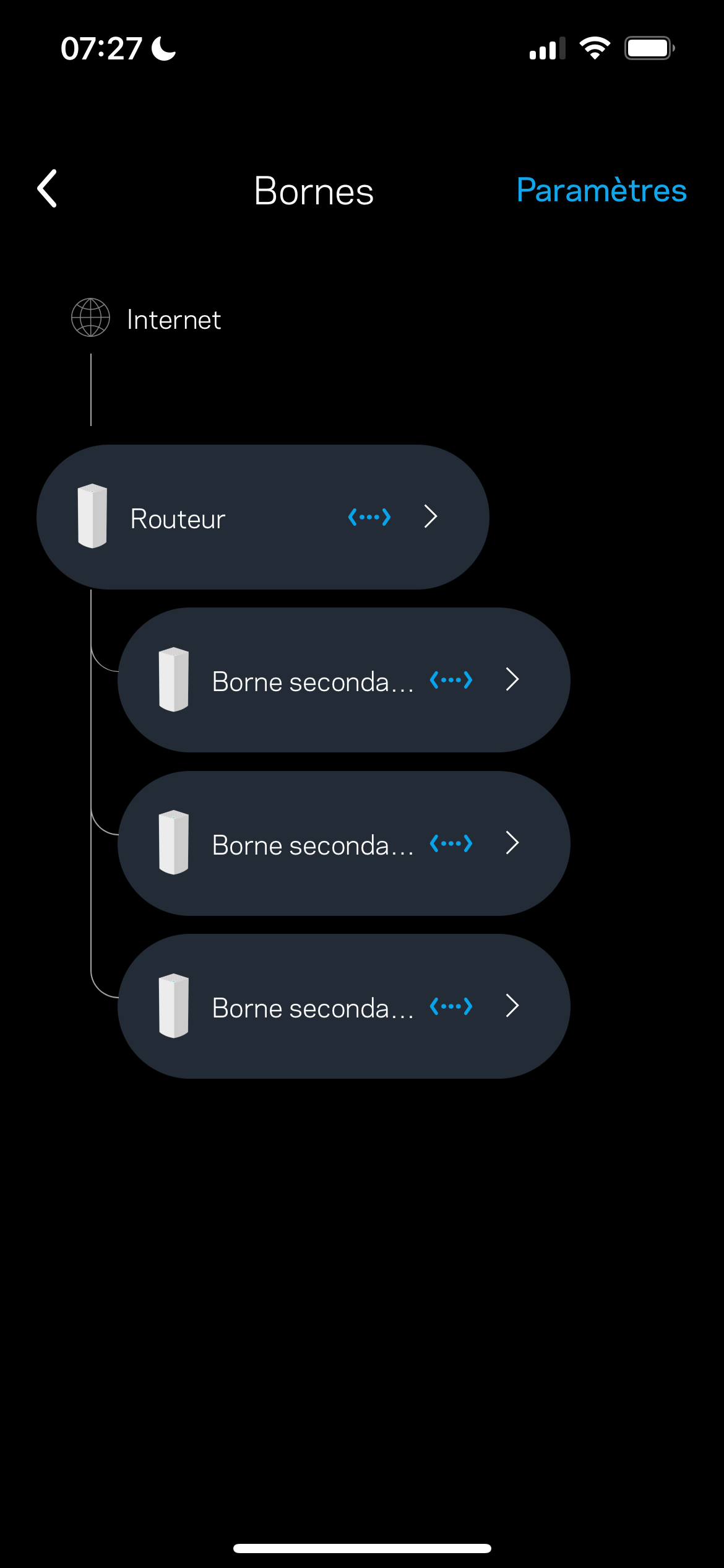

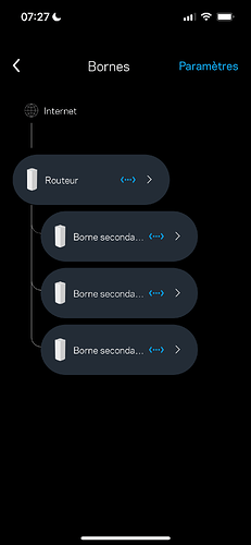

Yes, the innuos is connected directly to the box via an ethernet cable. The denon and marantz by wifi on terminals.
I have a router connected to the box and then from the router to a Switch for an extended wifi network called Halamadrid. All the appliances in the house are connected to this network.
I have the innuos connected directly to the box.
The Livebox wifi network I don’t use for wifi, as the signal is weak far away.

Hi @Carlos_Lopez1,
Based on your network setup, it appears that you’re running two local subnets, which is what I mentioned in my first response - unfortunately, Roon cannot function across multiple subnets.
As a next step, I’d connect your innous to your switch as well, and see if you can get all your devices on the same subnet.
Note that wifi extenders typically don’t allow for the best overall experience with Roon and hi resolution audio playback - you may encounter network dropouts and poor connectivity. None the less, it may still be worth testing.
