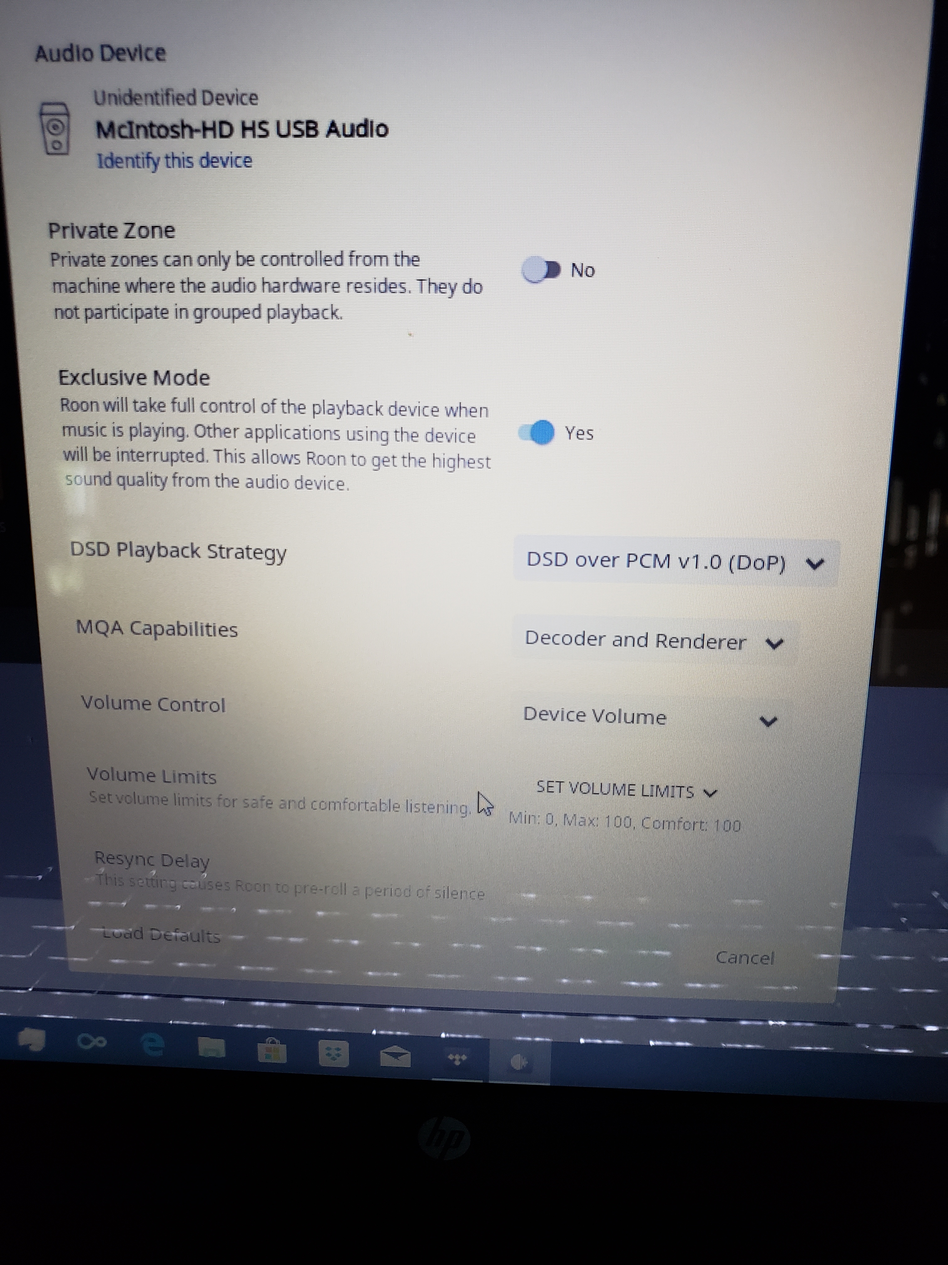

PS I am using wifi as before! I also switched from ASIO TO WASAPI AND BACK NO CHANGE.
Here are my settings…
Hi @Paul_Ishman,
As far as I can tell the McIntosh C2600 is not an MQA DAC, so will want Roon to handle the first MQA unfold. To do this, you can set the MQA Capabilites to “No MQA Support” and then press “Show Advanced” and set “Enable MQA Core Decoder” to yes.
As for the DSD aspect of this, I gather that you were likely using Roon’s DSP Engine to perform the up-sampling. I would access the DSP engine menu by right-clicking the zone in the zone picker (bottom right-hand corner of Roon) -> DSP. There, you will have the option to enable Sample Rate Conversion and set the DSD upsampling to DSD128 like so:
