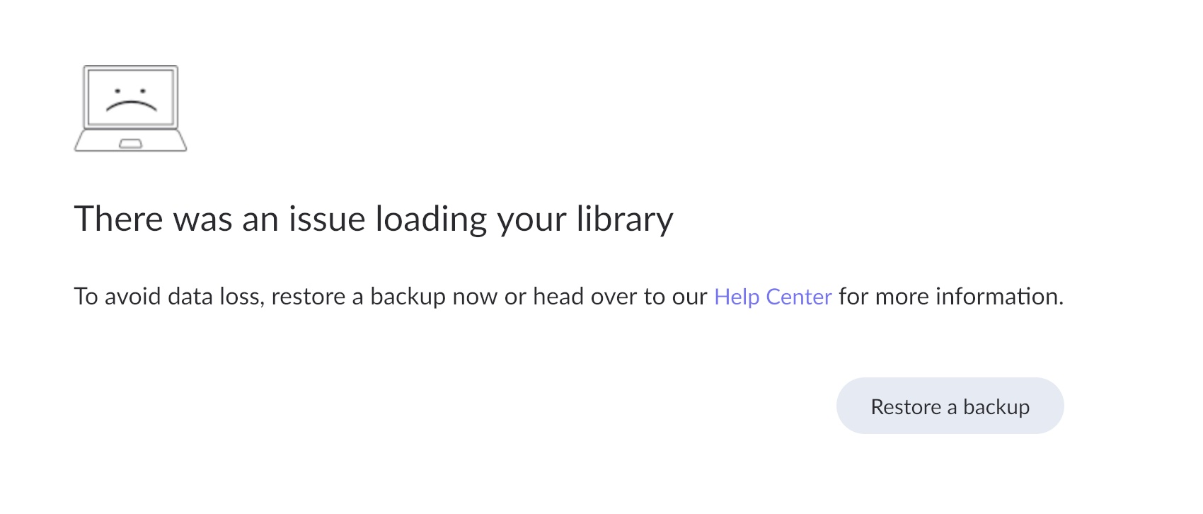

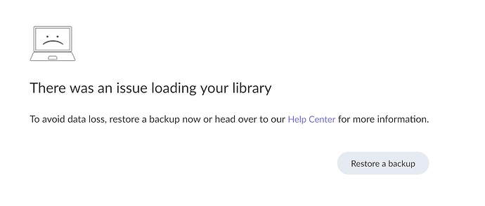

Thanks for that - the 218 is not showing at all on the Roon Settings → Audio page, apple tv and my mac are - but not the 218. I followed the instructions renaming and reinstalling and got the following:
I did not back up as i have not used roon yet - but perhaps this is my error - please advise if i can bypass this. Thanks!
