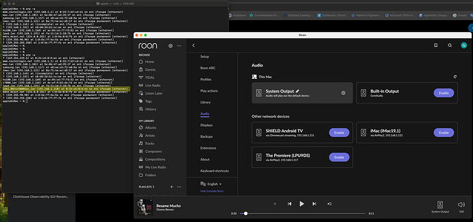

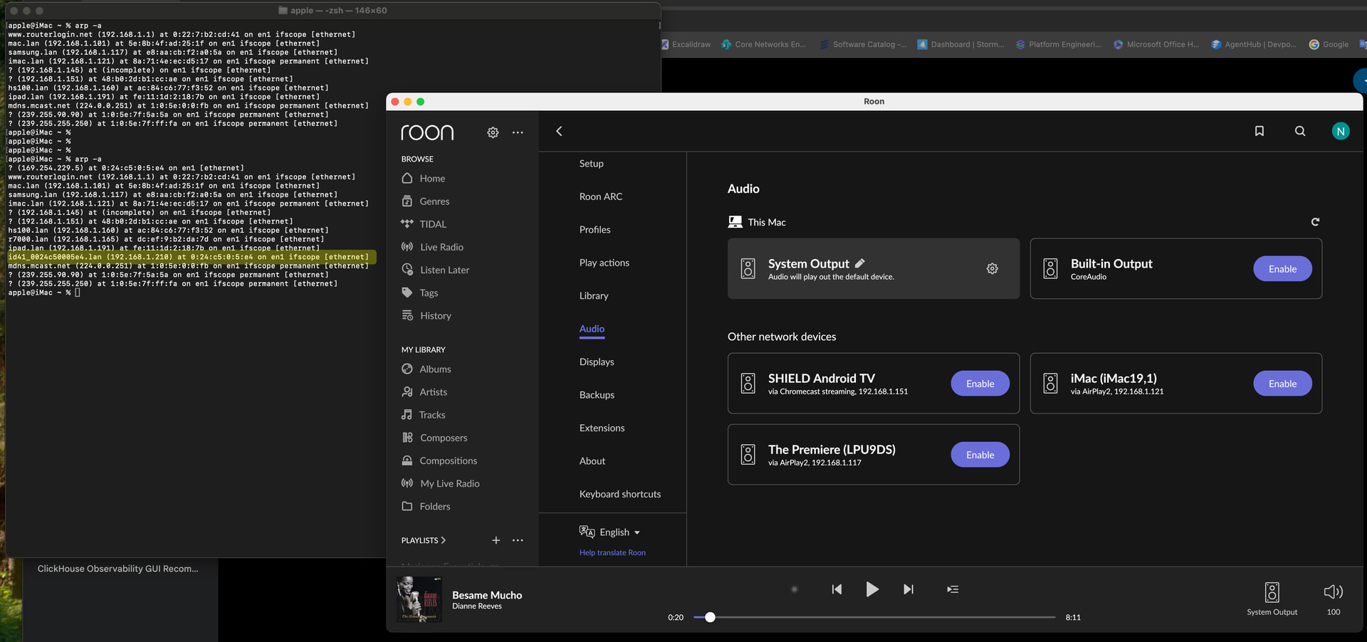

I think I can see the ID41 card with arp command, but still Roon is not detecting it.
I attach a screenshot where you can see arp result with ID41 card not plugged in (first arp result) and with network connected after power cycle of both 818 and iMac (second arp).
Roon restarted too and list of audio device is refreshed.
Cheers

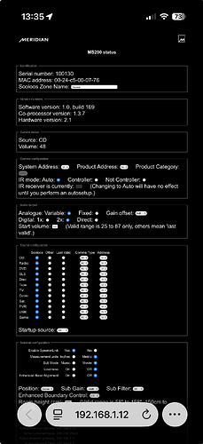

If you enter 192.168.1.210 into a browser do you get the ID41 homepage ?

Following Nick suggestion, I actually had the chance to reach the Meridian 818 home page once.
Shame on me, I did the worst think I could do to check if it was possible fo change anything.
I changed the setting from DHCP to static IP. A classic mistake!
The device disappeared from the network and I have not been able yet to discover its new address… It might be living in a different subnet. The same address did not work.
