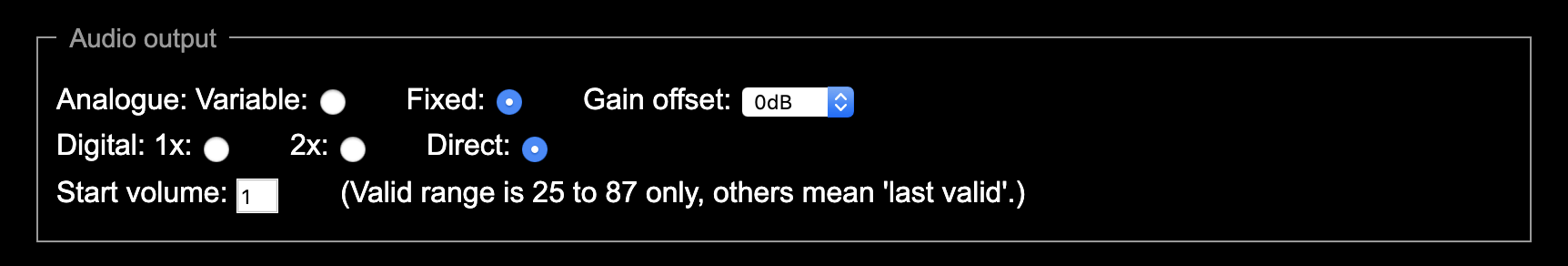

I have several properly working MS200’s. I just added another and confirmed the Volume Control in the Device Setup is set to Device Volume. However, anything I play is at MAX volume and does not change when I turn it down.
Help! My zone is currently unusable :frowning:
I assume you mean Roon Device Setup?
What about the MS200 setup?
Thanks so much! I was under the impression that the device settings would be updated via Roon. I updated the Analogue output to Variable.
I’ll have to test once everyone in the house is awake. Thanks again :slight_smile:
