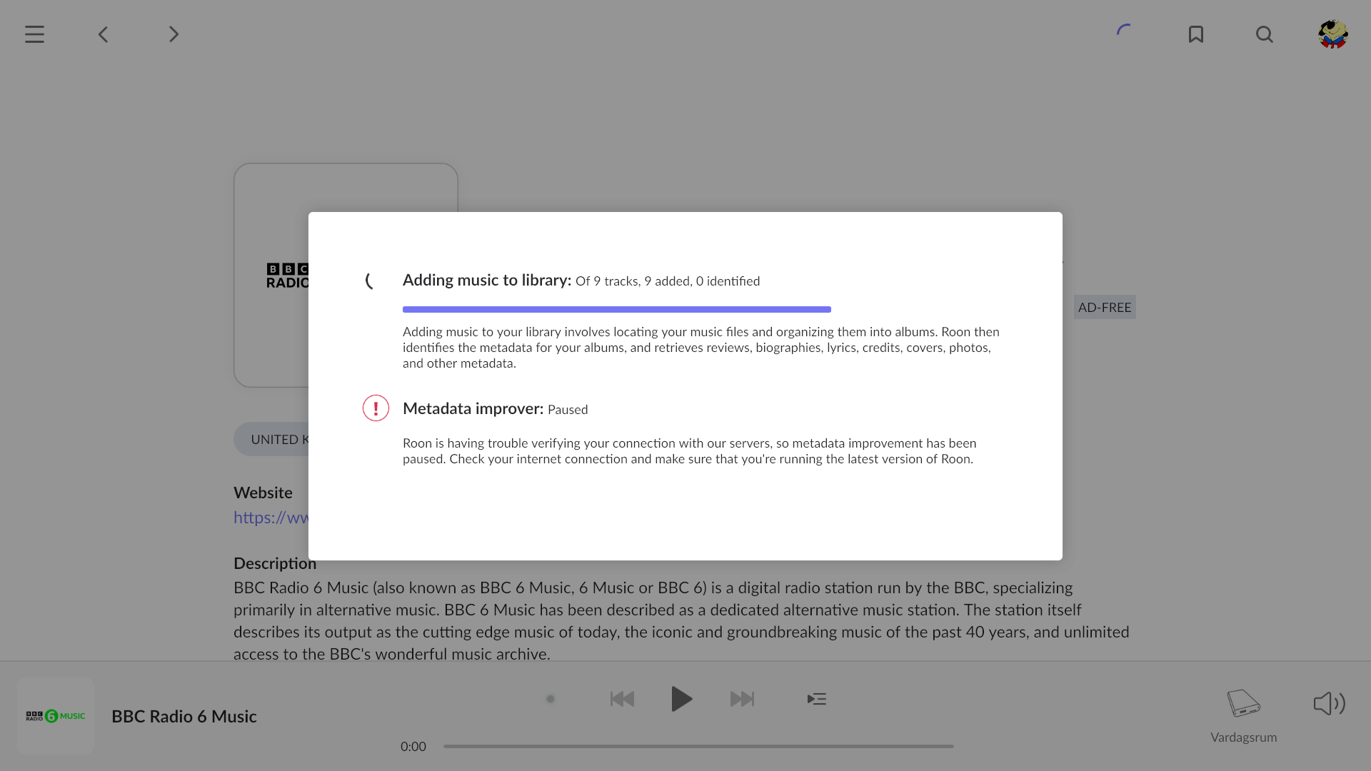

After installing a Wi-Fi extender--now removed--Adding Music to Library stalled and Metadata Improver paused. Roon Core is on a sonicTransporter.
I have deleted/reinstalled Remote; rebooted the Core; rebooted the router; restarted the Windows 10 laptop that holds Remote.
I followed the instructions in this form but the problem persists. Thanks for your help.

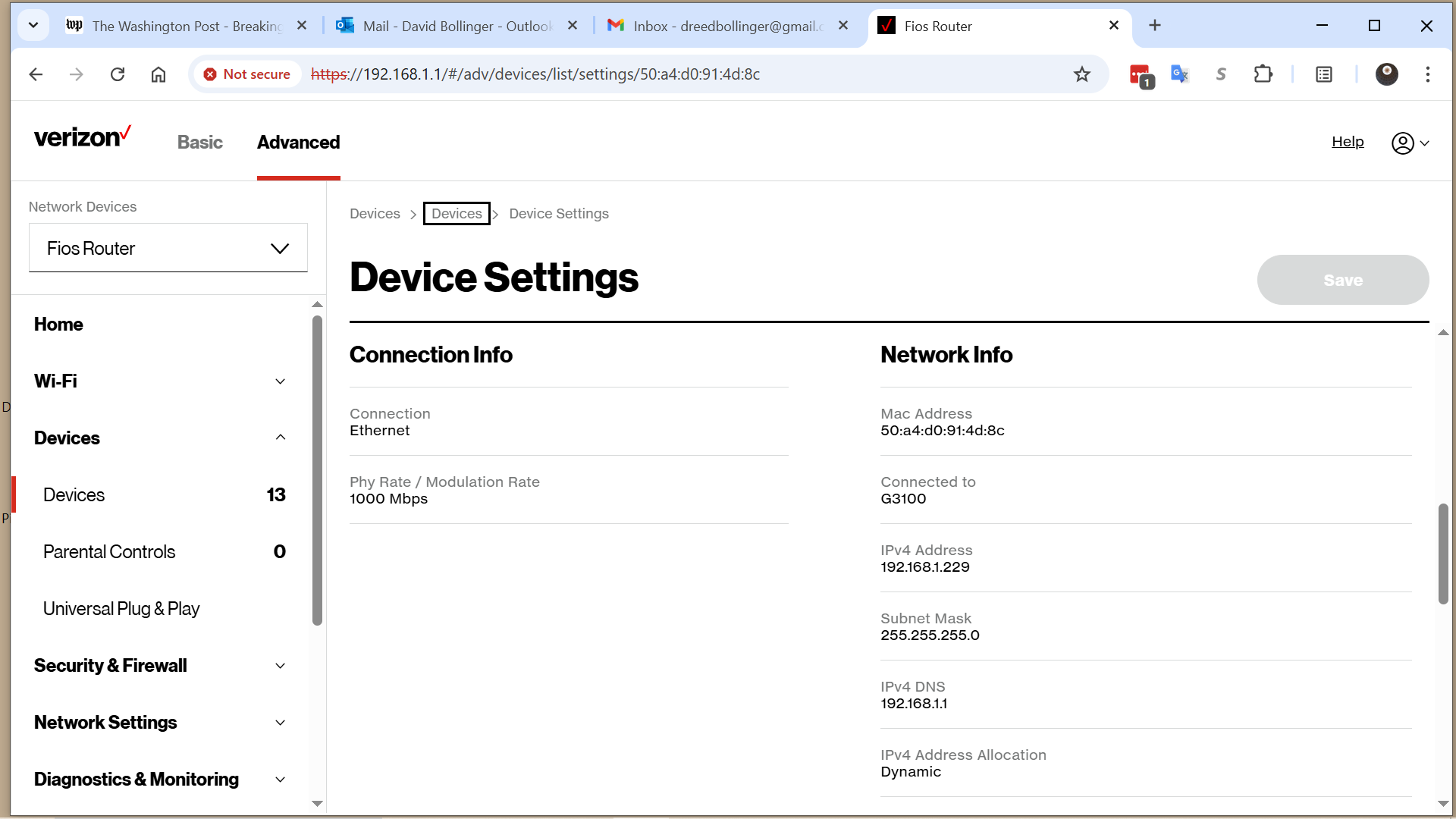

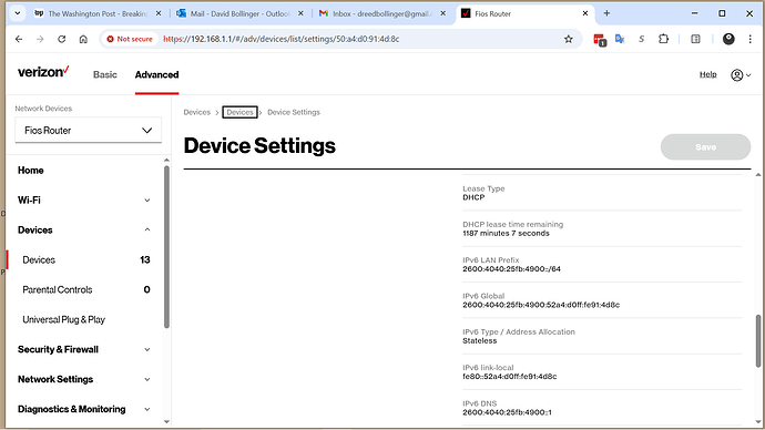

When you access your router settings, are you able to see your Sonic Transport with a dedicated IP? Are you able to access the webUI of your ST?
To confirm, have you rebooted your router as well? It may be worth giving this a second try just in case. Let us know your results! :+1:
Hi Ben,
To your questions: yes; yes; yes, rebooted router several times. Here are shots from router.

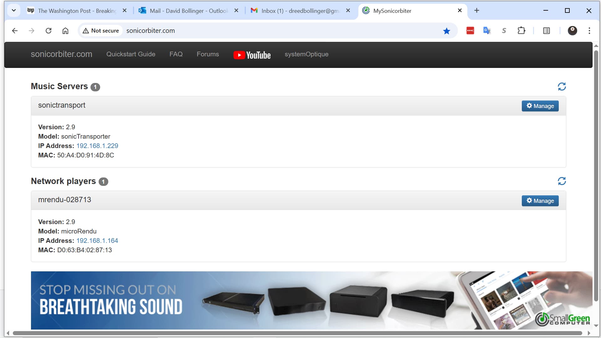

From Sonicorbiter:

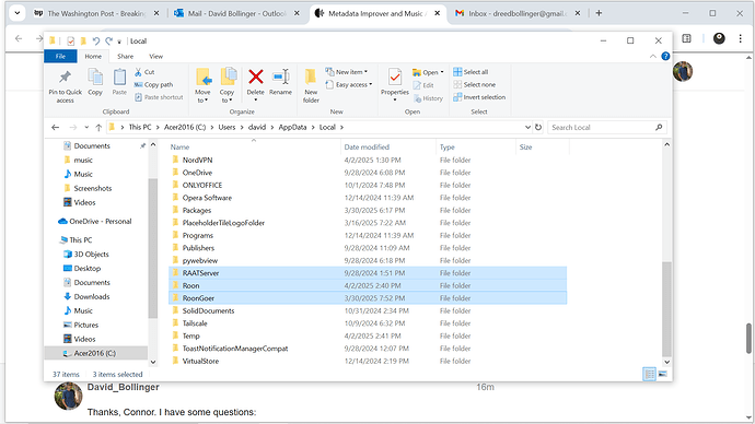

Thanks, Connor. I have some questions:
Do you mean a backup in Backup Manager? I have them.
How/where is this done?
Are the highlighted folders ones to keep? I deleted Roon Server folder.
