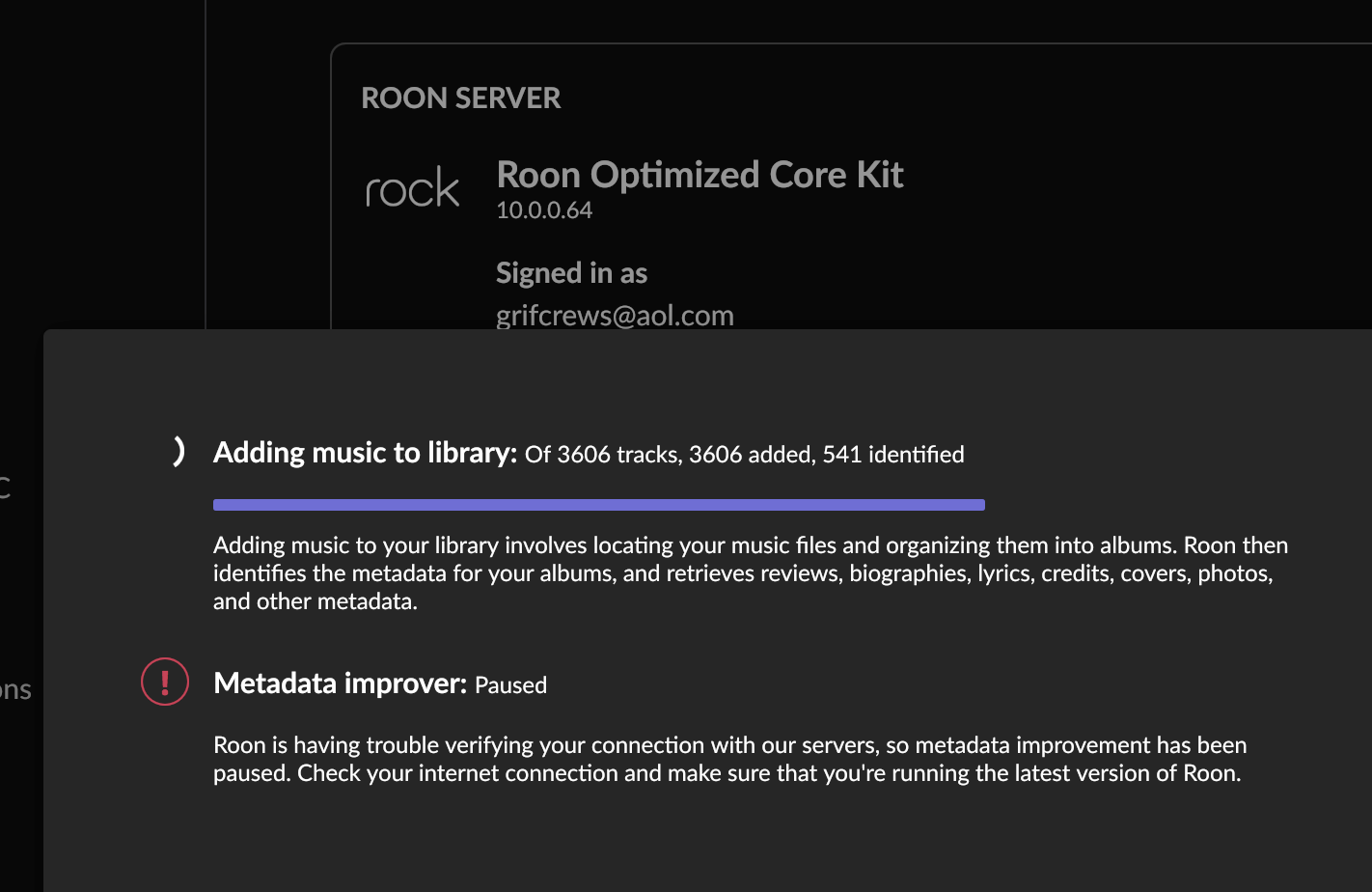

metadata improver: paused - NEVER had this issue till recent (no changes to my system)
Netgear OrbiRBE971 (router + wireless)-Netgear dumb switches - ROCK server (intel) standalone - Purchased patch cables (nice ones and yes swithed em out) - ATT Fiber to router.

Unfortunately did not work :frowning:
I changed the DNS on the Orbi to 8.8.8.8 and matched that on ROCK w static IP and 8.8.8.8
Still shows paused and cannot communicate.
Weird thing is i have NOT changed my network configuration NOR changed my computer configuration in the last 8 months, and until recently (as in 3 weeks ago) this has never once happened to me. VERY baffling. My next step is to shut down my entire system from end to end (and there are about 20 parts) and start one by one booting up the fiber interface, then my 3x mesh system (ROCK is hardwired btw), then the 6 routers, then the NAS, then the ROCK then the computer, then ROON software and see where that goes. Will take me about 2 hours to do all that. I will try this weekend and see what happens.
I am stymied as to what’s going on.
Since you are the experts, can this be caused by some DB corruption? Amount of files limitation? Not sure what’s buried in your software.
In the meantime, if you have any other ideas, please let me know.
Kind regards, Matt

Update since 19 days ago… I went into all my skipped files and fixed all the errors on unreadable files and such. Quick Q as well… So it is skipping some DFF files, and cannot read some jpeg files (even though I cna open them fine and even reformatted some of them ) I moved all the offending files outside of Roon view and STILL get the metadata imporver paused :frowning:
Just so yo know after a total reboot of EVERYTHING, the adding muic to librabry part goes fine. Scanning and IDing seems to go fine and at some point (never consistent) BAM… metadata improver paused (cannot communincate) - Nothing is wiereless, I can see if my interent drops (It has not since reboot yet still says same)
Maybe a different approach is what EXACTLY is the improver looking for? maybe a pathway to connect? (Ip address I can check), what is it doing to “improve” the file? Is there a way to turn it off so that VERY ANNOYING spinning wheel stops? For someone with OCD this literally drives me NUTS. Everything else works excep this improver. Any way to get a list of the files its trying to improve and I can go down that rabbit hole? Thanks for your dillegence in helping solve this annoying issue.
