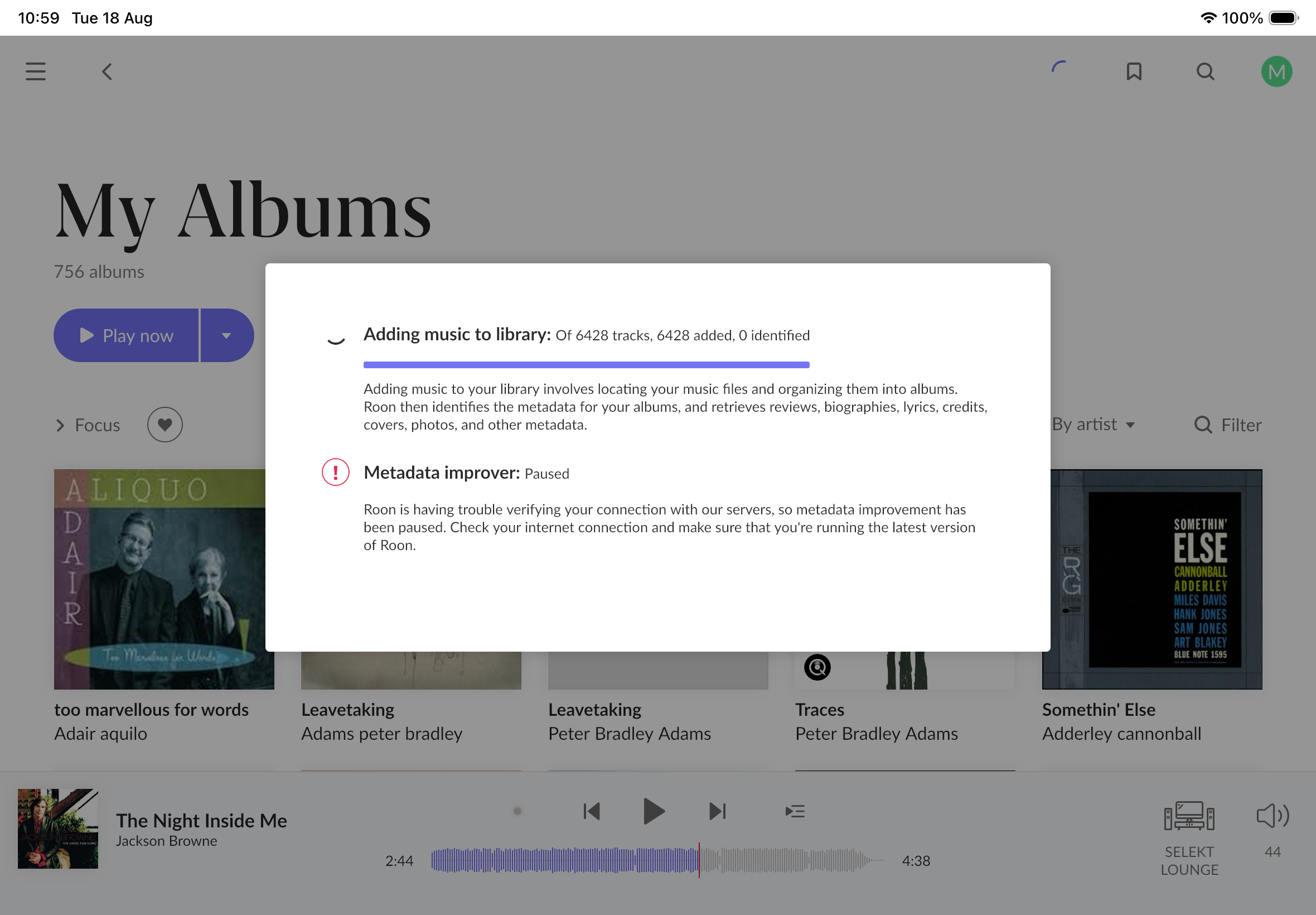

After installing an internal ssd the metadata improver is paused message saying trouble verifying the connection.roon library & Qobuz is working correctly. Unable to use the search function

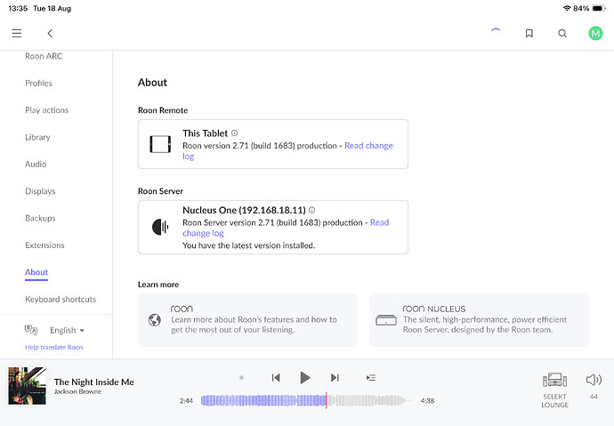

Hi Carl,
Yes I’ve seen that page. I appear to be running the latest versions of everything. I have rebooted several times.

Thanks, and that is a helpful picture. Two things from our side first.
We enabled diagnostics on your account so your Nucleus would send us a log automatically, and it has not arrived. We tried again, and we tested the same thing from our own setup here, which worked. So the failure is specific to your Nucleus.
That is worth knowing, because it is the same shape as everything else you are seeing. Your metadata improver cannot verify its connection, your Qobuz login returns a network error, search does not work, and now your Nucleus cannot send us a file. All four are your Nucleus failing to reach our servers, while your music and your library are fine. Something between that unit and the internet is being blocked or misdirected.

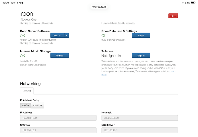

On the DNS suggestion you were wary of: you were right not to start changing router settings blind. There may be a simpler route. Please open your Nucleus web administration page in Safari on your iPad and send us a screenshot of the whole page, including the network section. If there is a setting we can change there, we will tell you exactly what to type, and you will not have to touch the router at all.

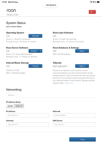

Hi again, thanks for the info. I have sent the log as requested except there aren’t the 3 dots to compress the file.attached is the image of system status as of about an hour ago

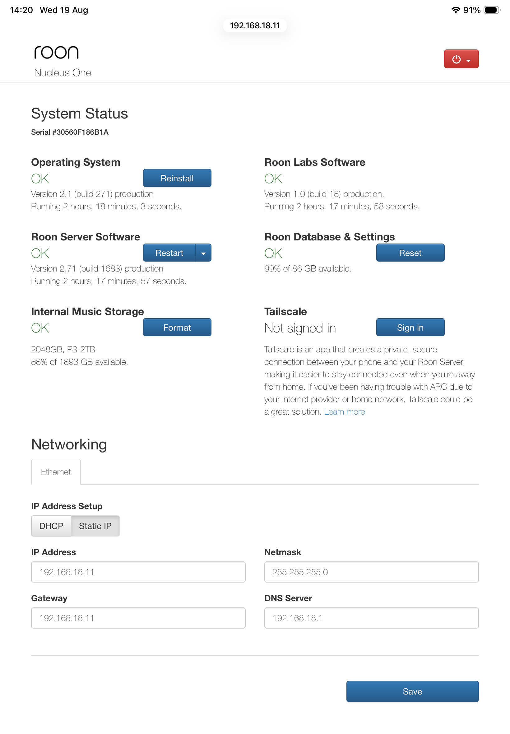

You appear to have set up a Static IP address on your Nucleus One - and you have set the Gateway address to be the same as the IP address of the Nucleus One. This is an error - the Gateway address is usually the router’s IP address.
Is there some reason why you are setting a Static IP address on the Nucleus One? Best practice is to use DHCP and set an address reservation for your Nucleus One in the router, so that it always gets the same IP address.

Well, your first screenshot of the Nucleus Web Administration Interface posted 2 days ago showed the network set to use DHCP, and yet your screenshot yesterday shows it changed to use a Static address…

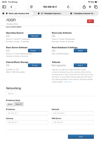

I don’t know if it will help, but as it stands it will never work correctly, so please do this now so it’s back on DHCP.
Afterwards reboot your network router, wait 5 mins (for it re-establish an internet connection) and then reboot the Nucleus. Once back, reconnect and post another screenshot of that page.

I have done as you suggest & here is the latest screenshot.
You still have the Static IP setting enabled - nothing has changed…

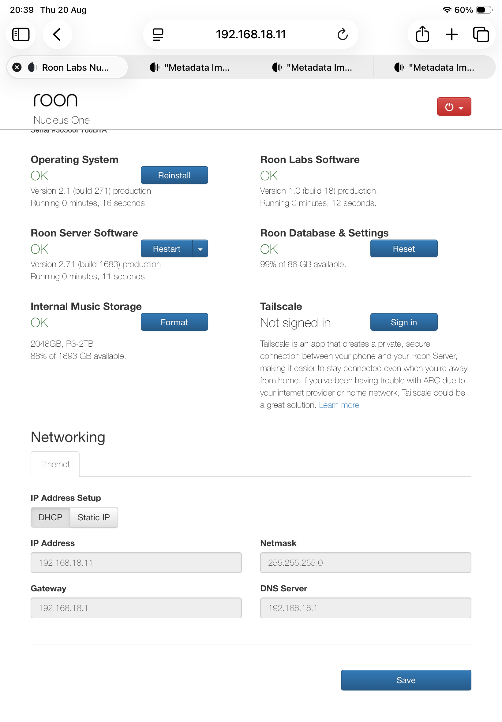

Whoops! Don’t think I clicked “save” after clicking on dchp.
To be fair, the difference between the dark grey button & lighter grey to show which one is selected isn’t immediately obvious to a numpty like me. Maybe green & red would be more obvious?
Yea I know I’m making poor excuses.
Latest screenshot here!
