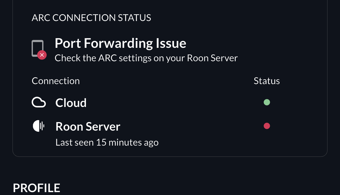

Metadata improver paused, can't log in into tidal and ARC is not connecting
Vodafone UK, Orbi router connected to Vodafone router

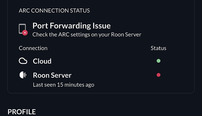

Thanks, since cloud flare fix, only ARC is stuck with the following status -
Cloud=Green, Roon server=Red
I’ve reinstalled ARC and restarted iPhone but hasn’t helped. Can someone please assist.
Tailscale is also showing connected.
I restarted the nuc and not just the rock server and it fixed the issue
