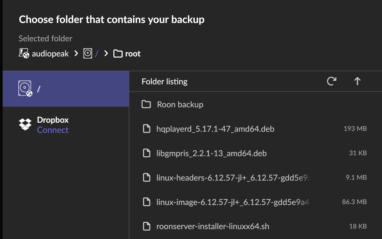

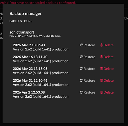

Now I have to find this database in Settings> Backups> Find backups - browse>…no database
The first folder is not the backup of the new database. This folder is empty and ment for future backups.
But as my musicfolder is visible for Roon I installed the backup in this folder and so I could migrate the database to my new server.
In Storage I had to ad this musicfolder to watch and after 10 minutes I was ready.
