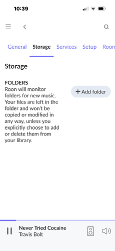

I have received and installed the Nucleus One. I needed to get streaming up and running for a listening event, so used the Nucleus server that showed up when I started it.

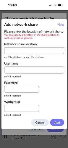

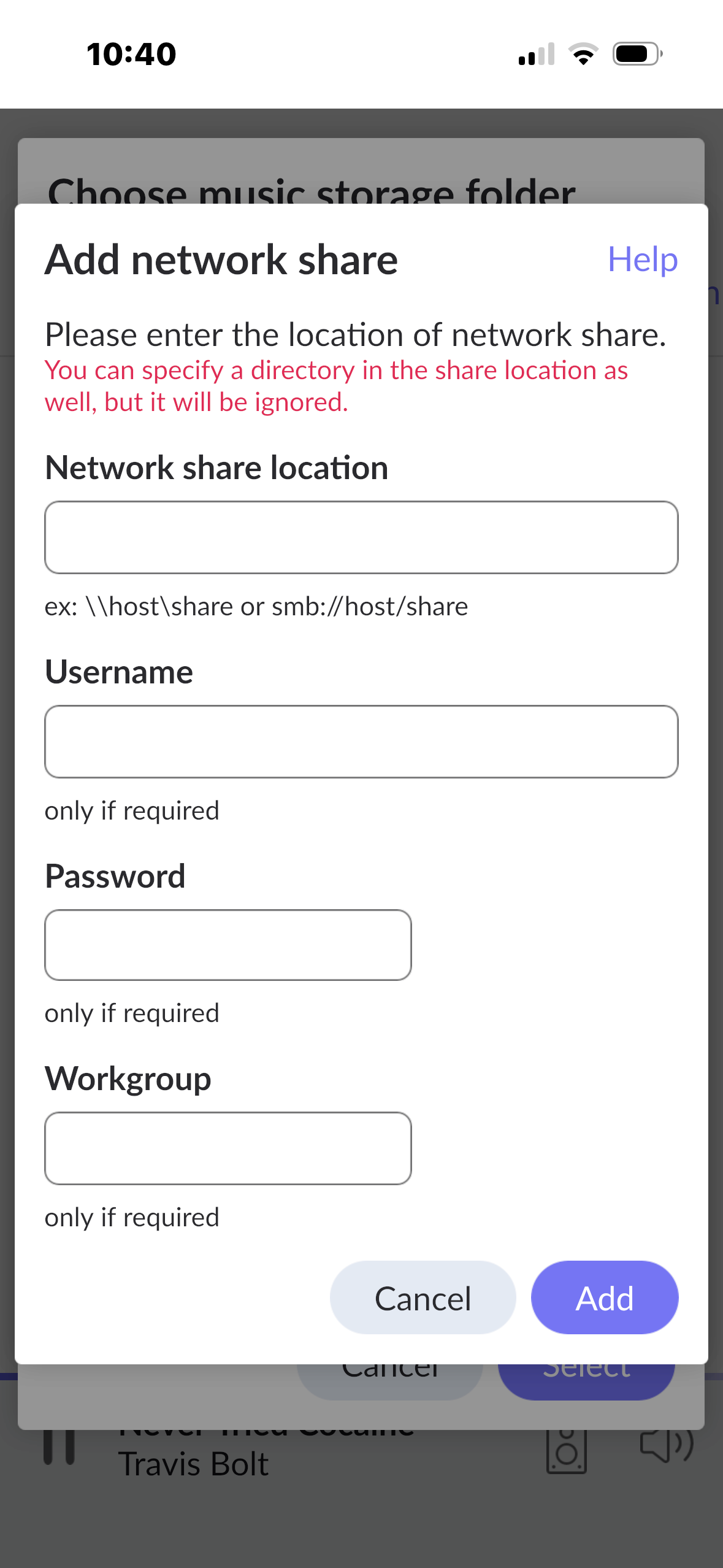

I have not transferred the backup from my QNAP NAS nor pointed to monitor the music files on my NAS. I have taken all the wonderful information you have given me and located the files on my NAS. Please understand that navigating the NAS is a little over my head. The SMB was already enabled. I have put in the path and password for the NAS in the Roon explorer interface and it keeps saying it can’t locate it. I am more used to an explorer tree to identify a file so I am probably doing something wrong even after following examples in the articles.
Ideally, if someone would be able to remote in would be ideal and would probably take a couple minutes to accomplish. However, if that’s not available, then I could put some screen shots up on this post? My skills just aren’t where your’ll skills are. Somewhat frustrating. Thank you!

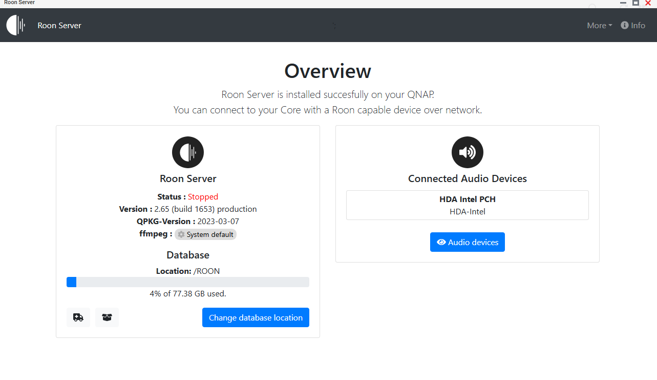

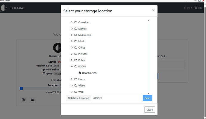

QNAP TVS-682 Screen Shots
Any resolution on the screen shots? I have also included the path to the roon server, but notices a bunch for folders in there that I don’t recognize.

Thank you for your patience. The screenshots you’ve shared show RoonServer still configured on your QNAP as an application (non-Docker).
Our diagnostic servers show a library active on your Nucleus One, hosting several thousand tracks (mostly streaming services).
Did you have backups configured when you originally hosted the server on the QNAP? Where were you storing those Backups? What about your music library; was it in the Music subfolder from your screenshot?

The screen shoots I published should show both the Roon Server folder and my music file location. I have not been able to identify the Roon Core backup files as I don’t know what file name they fall under.

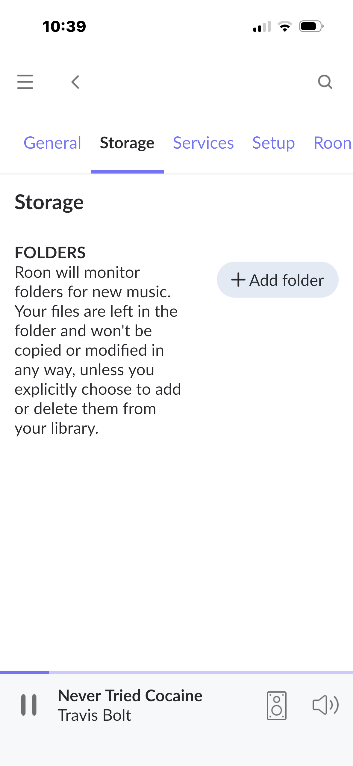

I also have not been able to path the music files using the Roon App Roon path finder (explorer). See attachments.
1. Using various examples from your documents, the explorer can not locate my files.
2. Same with backup with addition that I don’t know where the Roon Server backups are located.
3. I am able to sign into my QNAP NAS and using the file app, navigate to all files. I just don’t know what I am looking for.
4. For whatever reason, when I type (several variations) into the Roon patch explorer, I keep getting the error message that it was not found.
5. My experience on locating files is limited to a hierarchies file tree that you click on end file to locate. Typing it in manually has been challenging, especially when I don’t know where the back up files are.

2. Enter the SMB Path in Roon
Go back to the “Add network share” screen in the Roon app (the one from your screenshot) and fill it out like this:
  • Network share location: Type smb://192.168.2.161/ followed by your Shared Folder name.
    • Example: If your folder is named Multimedia, the path will be smb://192.168.2.161/Multimedia or smb://192.168.2.161/share/Multimedia
  • Username: The exact username you use to log into your QNAP NAS.
  • Password: The password for that QNAP user account.
Click Add. If the credentials and IP are correct, Roon will connect and finally let you “click through” the sub-folders to select your specific music directory!
