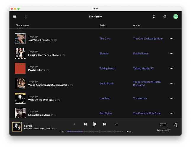

The recently played tracks is missing tracks which are showing up in My History - the 2 do not match

All tracks played are in the same zone - I have attached screenshots. On the recently played screen it only shows the Lou Reed and Bruce Springsteen tracks but in my history there are several others that I played including The Cars and U2. Hope this helps.

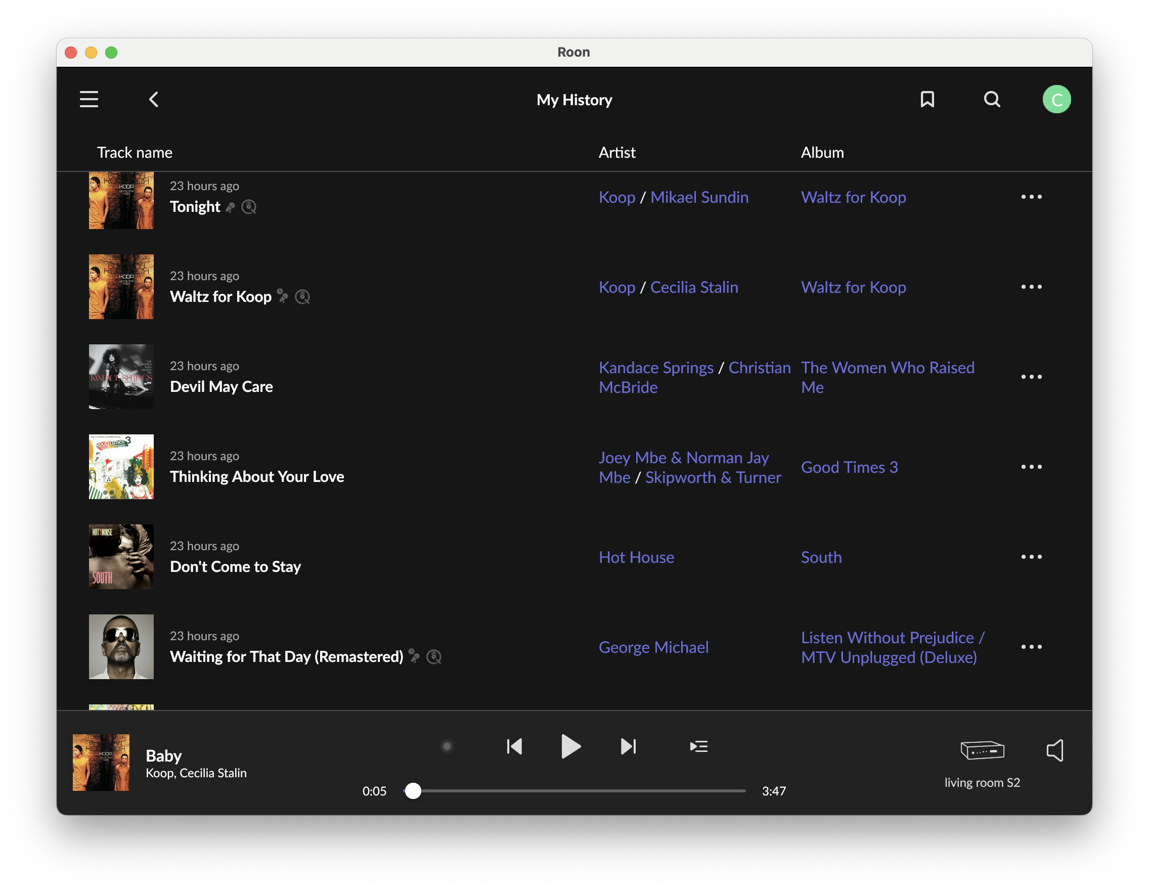

I dont think this issue is limited to Qobuz. Look at the latest screenshots below and you will see that I also played a ripped file (Hot House) from my library that is missing from recently played amongst other streamed tracks. so I dont see the point in following the steps for Qobuz as suggested. Thanks for investigating.
