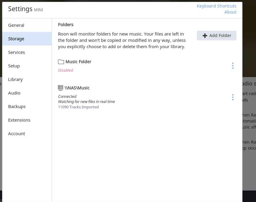

  3. How are you adding the new watched folder? Can you please provide us with a screenshot of your “storage” tab please.

    3)DIdn’t know there was more than one way to add watched folder? See photo.
