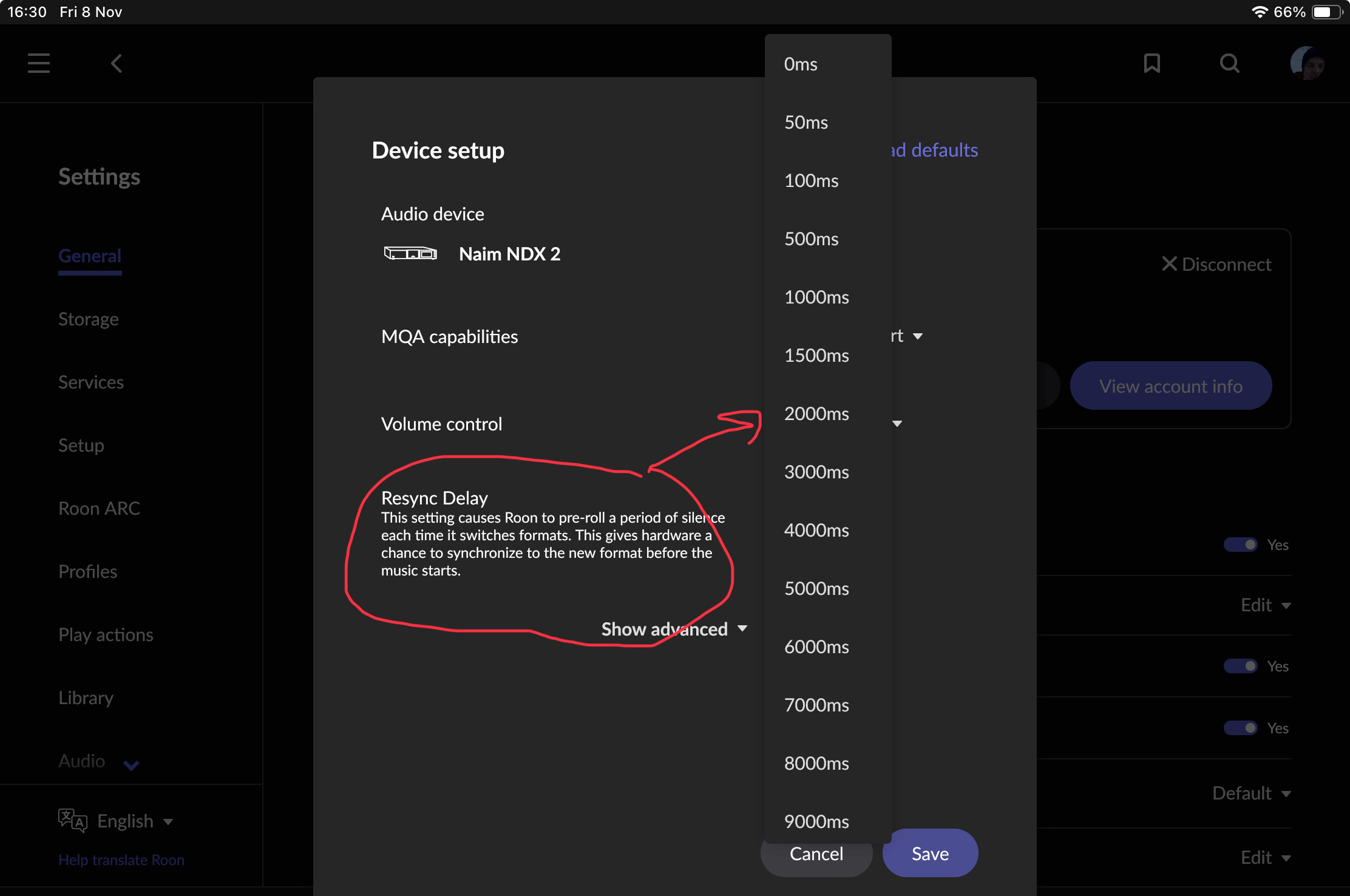

This is already in as “Resync delay”:
But may not work for USB connections (USB not listed) but you can try and report if it helps.

Hi, I have a similar setup as yours, just that I have the Naim NDX2 connected to Roon and to Chord Dave / MScaler. I remember having a similar issue when I first set it all up. I have resolved it by going into device setup and changing the Resync Delay from 0 to 2000ms. Lower values may also work but this one works for me.
I think resync delay only works with optical. OP wants to keep using USB
I’m not using optical, so I think it’s worth a try.

When I asked in another community, someone also told me that Resync Delay improved the situation. It looks like you solved the problem too.
However, from reading Roon’s HELP, it looks like it doesn’t work with USB, and my dealer also told me that this problem is not improved by Resync Delay. In other words, opinions vary from person to person XD
Does your setup look like this?
mac- (Etharnet or Wi-fi) - Naim NDX 2 -(BNC) - M Scaler
From the image you attached, it looks like the Resync Delay is done to the Naim NDX 2, but it may have an effect on the M Scaler connected beyond it.
