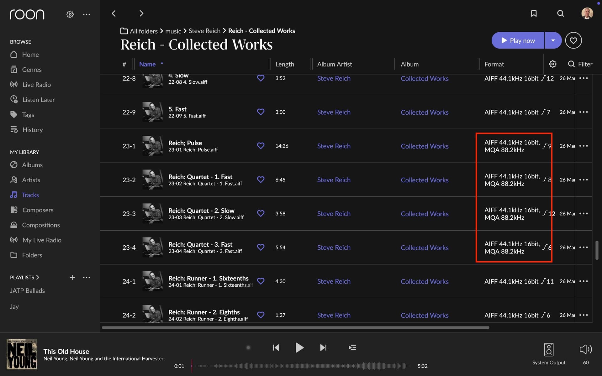

I posted a similar question in 2020 and was advised at the time the my mixed track format was due to different sampling rates of the download. Okay, that makes sense.

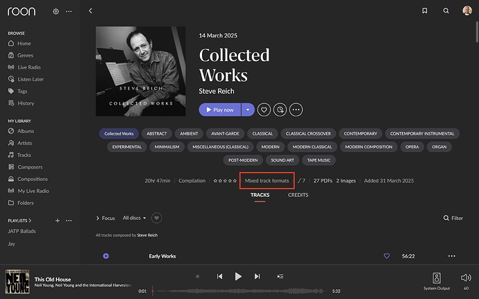

In this case, I ripped the new Steve Reich box set using dBpoweramp and got a mixed track format response:
but of course was puzzled as this was a CD rip in AIFF and not a download with different sample rates or other variables.

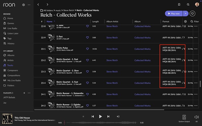

I dug down a bit deeper and see in the folder view (thank you Roon for the folder view!) and see that on disc 23, the result is both AIFF and MQA!

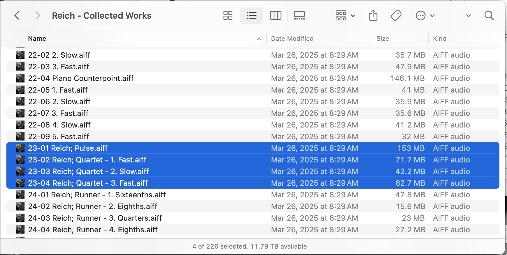

I then looked at the same tracks using Finder and see that disc 23 (as are all the discs in this box set) are all AIFF:
So how could Roon interpret the AIFF ripped content of disc 23 to be both AIFF and MQA?

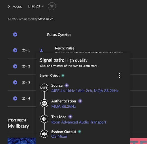

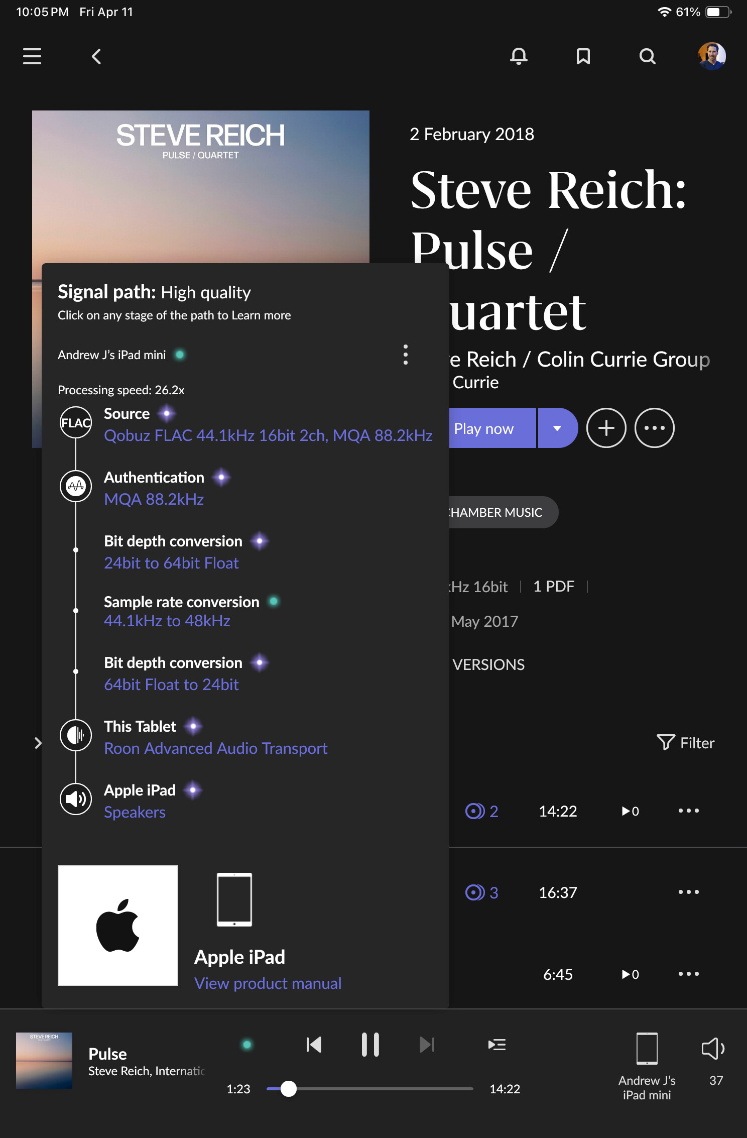

What do you see in Roon Signal Path screen when playing those track? That’s the true measure S this info comes from the data stream itself (not the metadata).

The signal path for disc 23 shows MQA where all other discs are AIFF:
Showing my naiveté here, but if the disc is ripped to an AIFF wrapper, the lossless content could still be MQA??? Also, why would the source show both AIFF and MQA?

I always understood that a FLAC or AIFF or whatever rip would mean that resulting content would then be in a *.flac or *.aiff format. That is why I was surprised to see MQA and AIFF for that one disc but not the others.
David

I do find it odd that self ripped music turns out to be MQA. My guess would be that the original disc, that you’ve used to rip, is an MQA CD itself. I don’t have MQA CD’s at home. And all my ripped CD’s (in FLAC) all show up as FLAC.
It definitely is an MQA CD, probably unlabeled as such. See the screenshot above. Even on the standalone digital album on Qobuz, the 16 bit 44.1 kHz version is MQA encoded.
