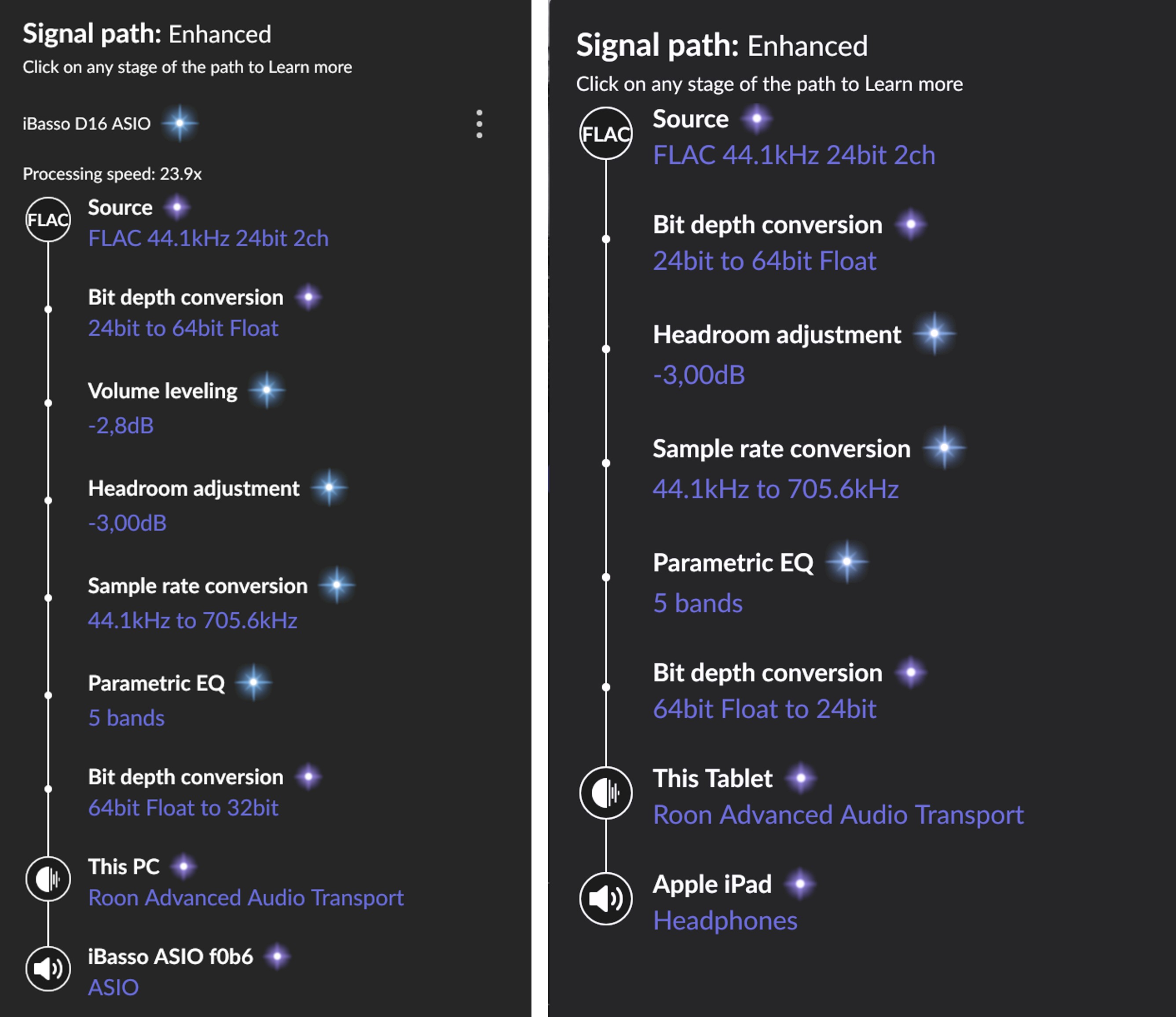

A small signal path comparison - both with my iBasso D16 DAC/AMP
Torben
PS: Did forget to set volume leveling on my iPad
