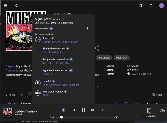

Aliexpress fanless N100 running MOCK here with 16gb and a 128mb NVME. Copes very well with DSD 512 upsampling on one zone.
