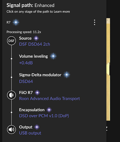

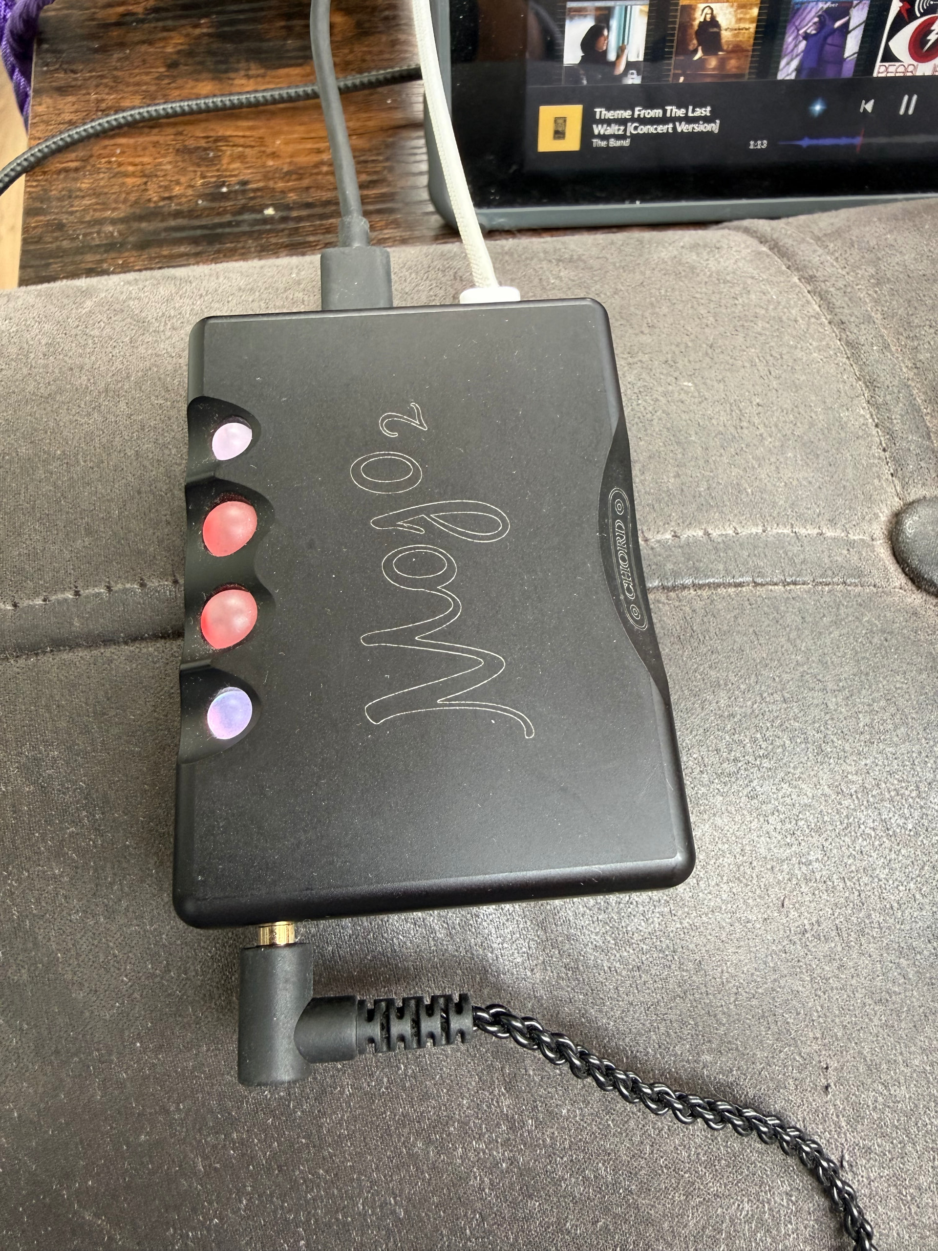

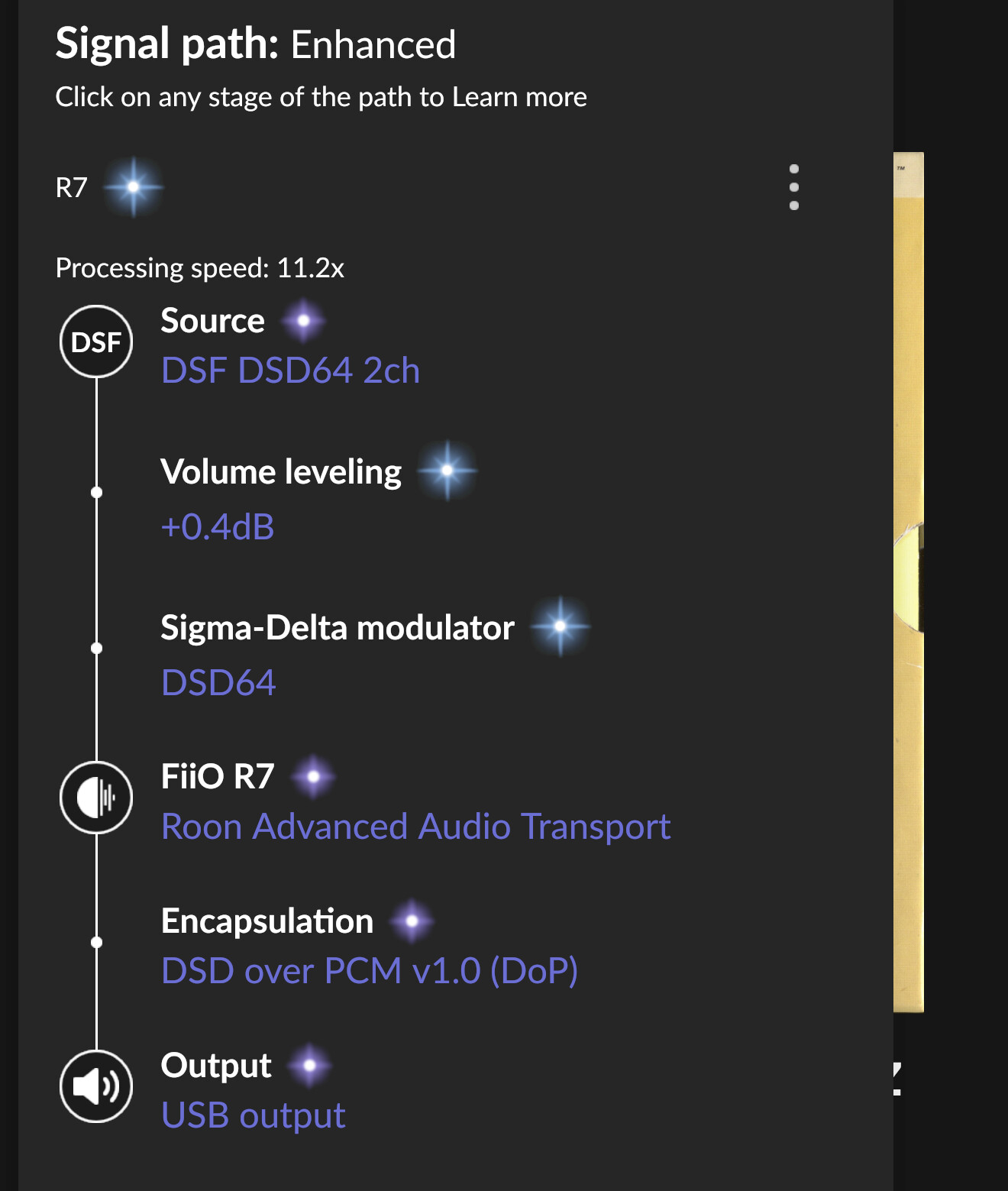

Currently testing from my FiiO R7 > USB C > Mojo2
Are you using the USB-C port or Micro USB?

I tried both USB entries. The DAC is in desktop mode and powered by an Ifi iPower2 5V converter.
Note that you are also processing the signal before sending it to the Mojo (as in my current workaround).
Yes, as @mjw mentions, the Mojo2 doesn’t support native DSD, so the DoP is needed.
