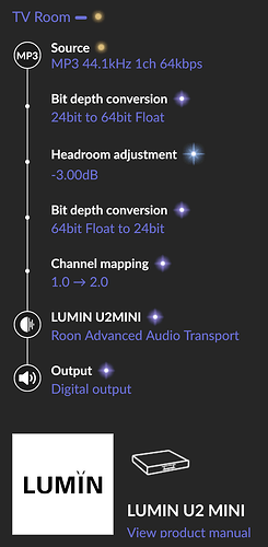

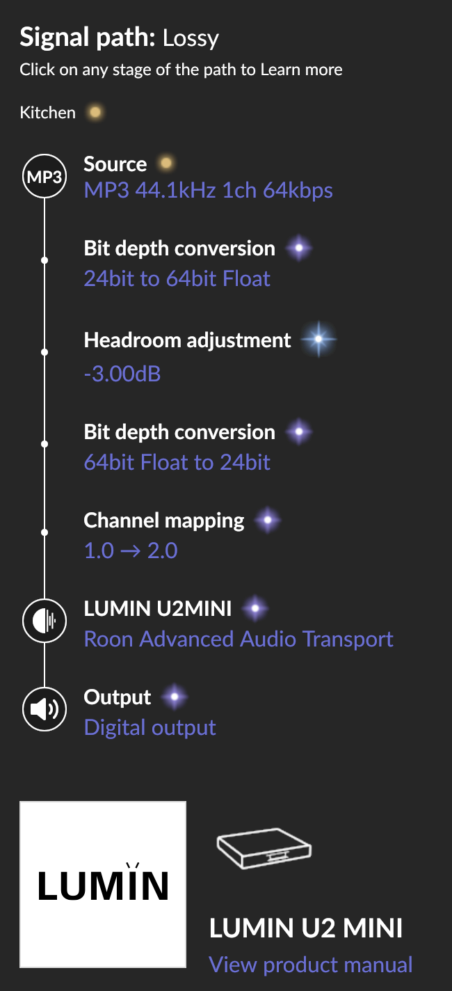

For this zone, the mono source file gets mapped to stereo before sending to the Lumin U2 Mini, and the sound plays as expected:

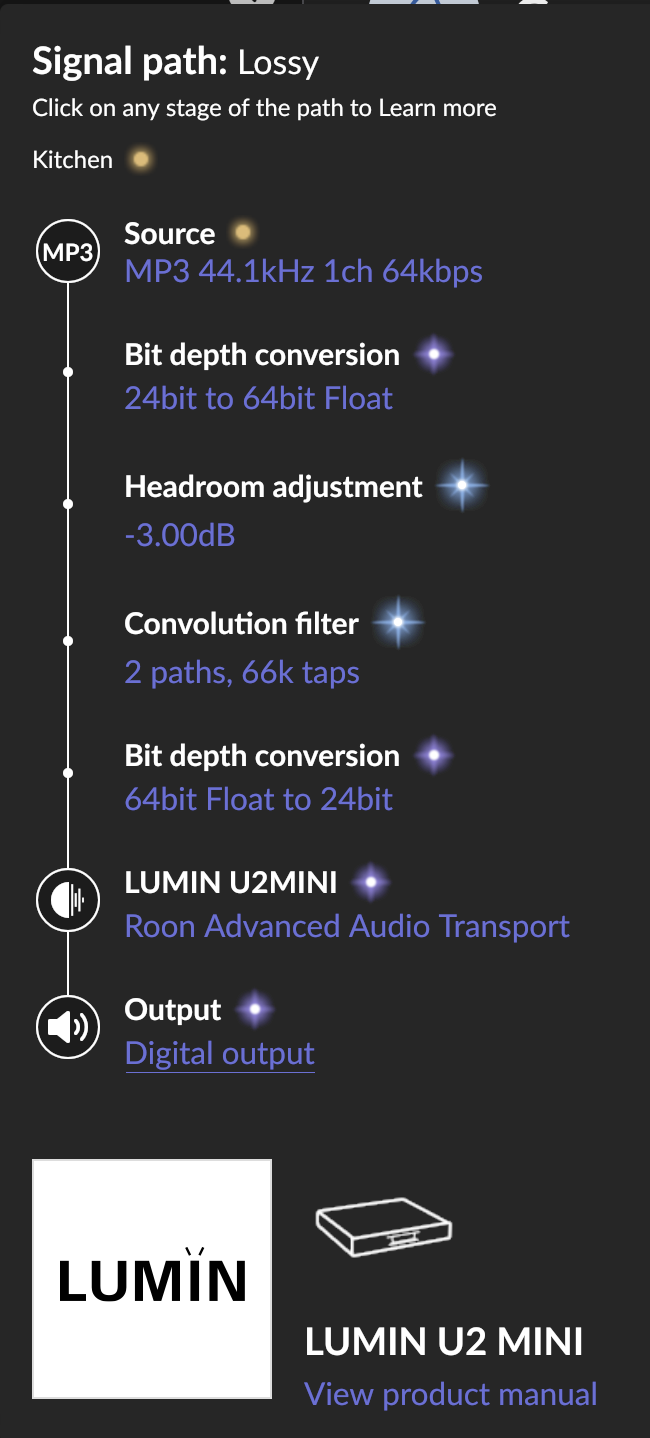

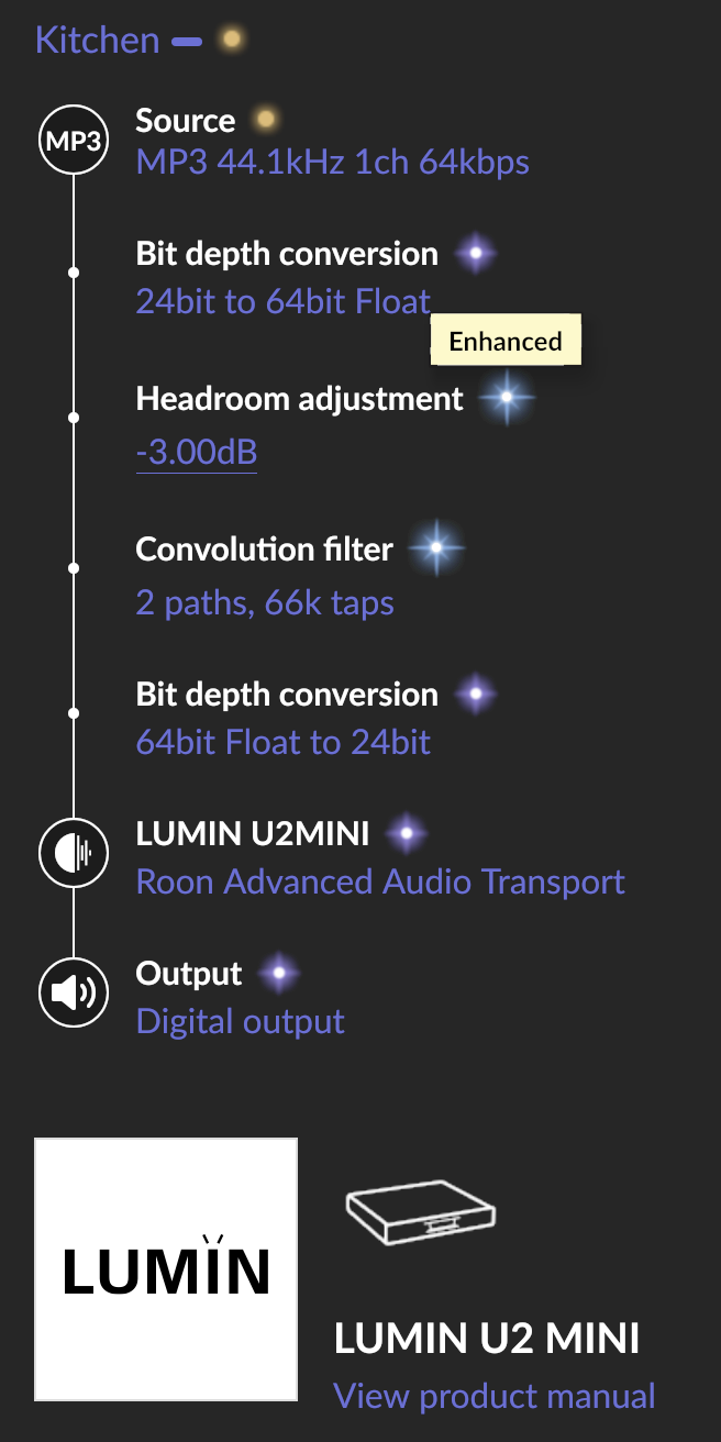

For this zone, the mono source file does not get mapped to stereo before sending to the Lumin U2 Mini, something downstream is unable to handle mono digital play, and this zone mutes for the duration of this track:

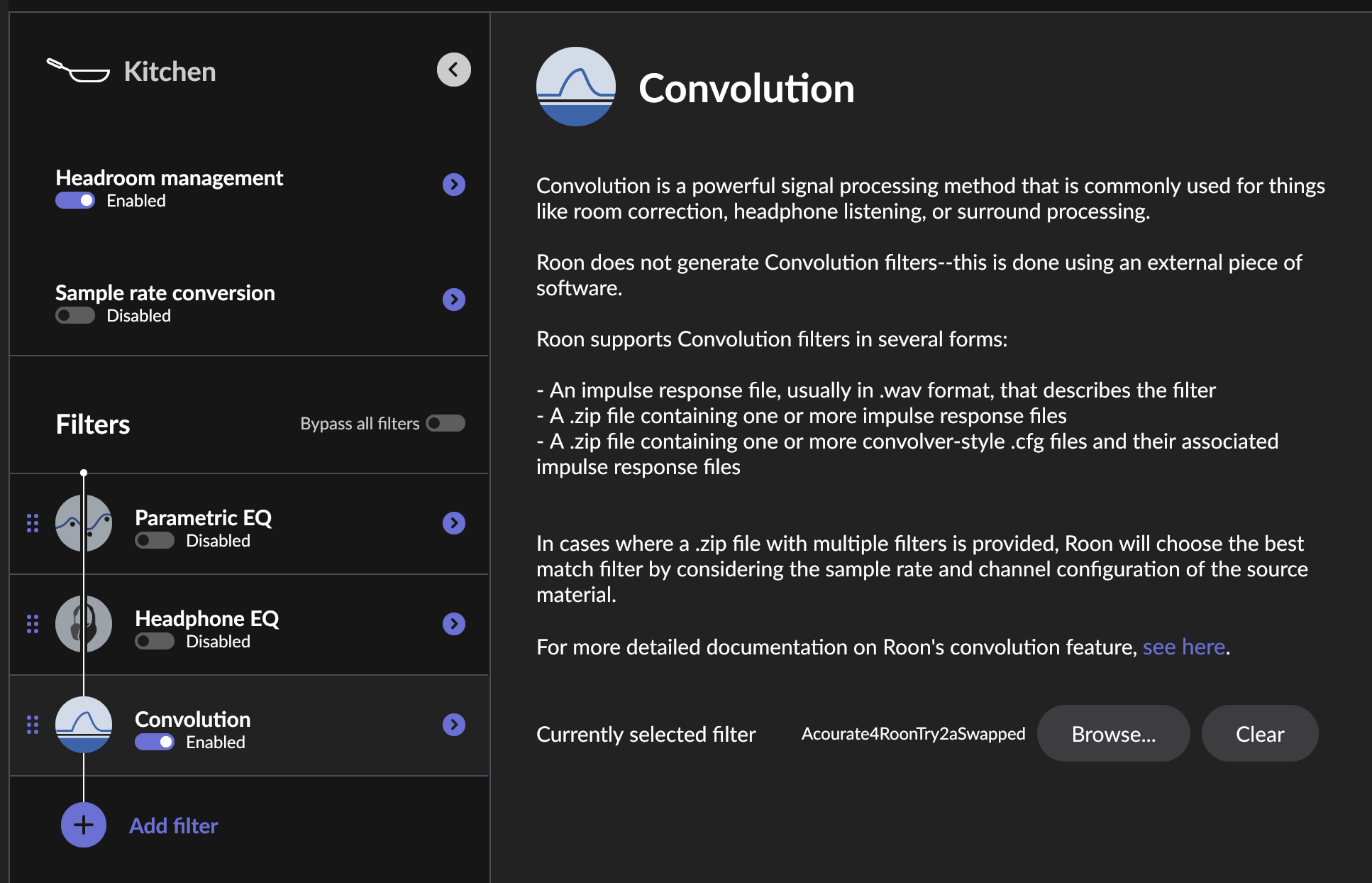

Aha! One of the zones, the one not working properly, was set up to run through a convolution step (which I always leave active, because it corrects for the bass issues from this zone’s speakers being too close to the wall behind them).
So I turned off the convolution step temporarily to simplify the comparison I was going to send you… and without that convolution active, the zone automatically maps mono to stereo and plays correctly.
I apologize for not having tried that before opening this ticket! It’s an obvious thing to try; it’s the only major difference between the zones.
It’s such an obvious thing to try that I could swear I already tried it (a few months go, when I first encountered this issue but didn’t have time to file a trouble report). But I guess I must not have.
So. The trouble I’m looking to resolve is now not a mysterious difference between zones, it’s that the automatic mapping from mono to stereo happens if there’s no convolution step, but fails to happen when the convolution step is enabled.

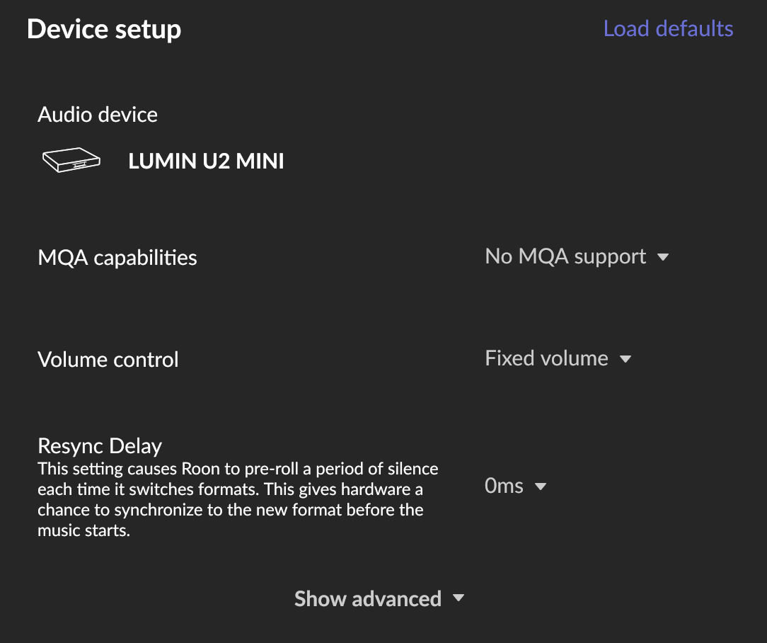

Here’s the main device settings page:

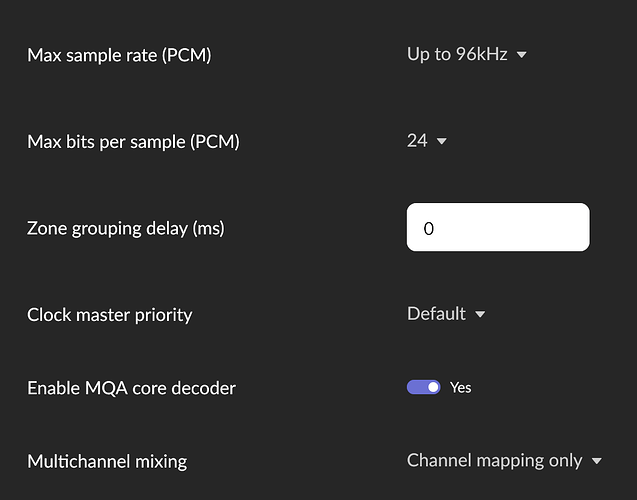

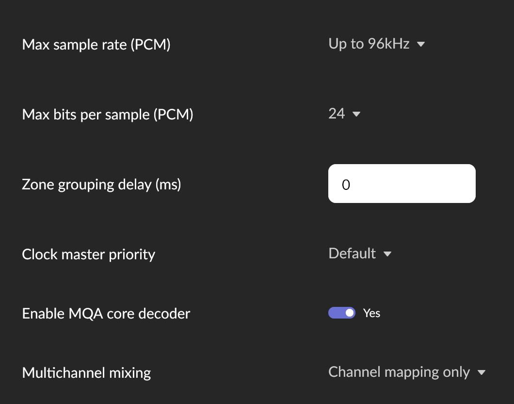

Here are the advanced device options:
Here’s the signal path (WORKS CORRECTLY!) with convolution disabled:
…and here’s the signal path (OUTPUT STAYS MUTED because unsupported mono sent to device) with convolution enabled:

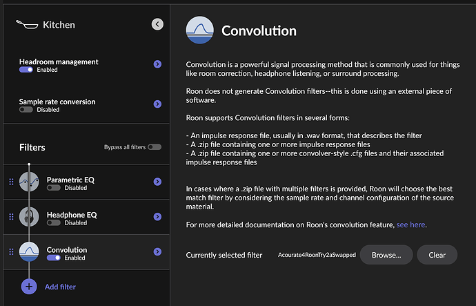

Here’s the MUSE setup with convolution enabled:

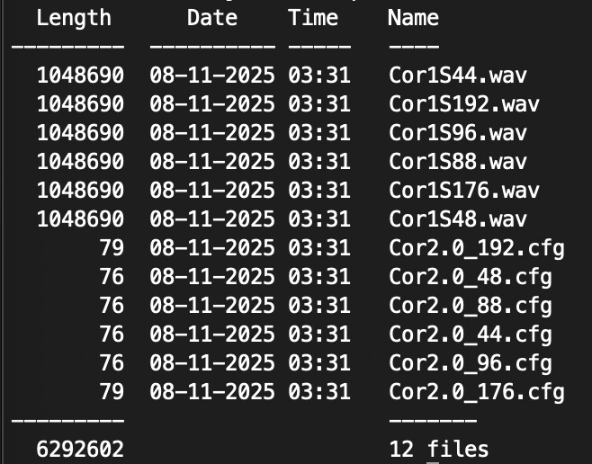

Here’s a list of the contents of the Acourate-generated ZIP file for convolution:

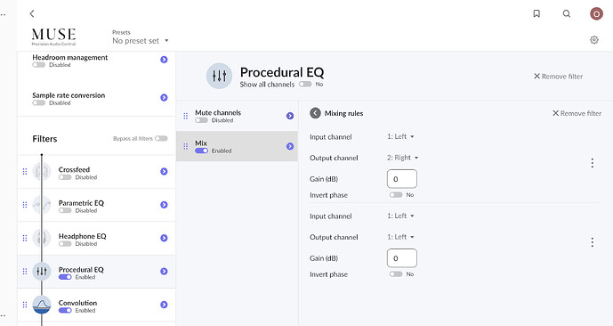

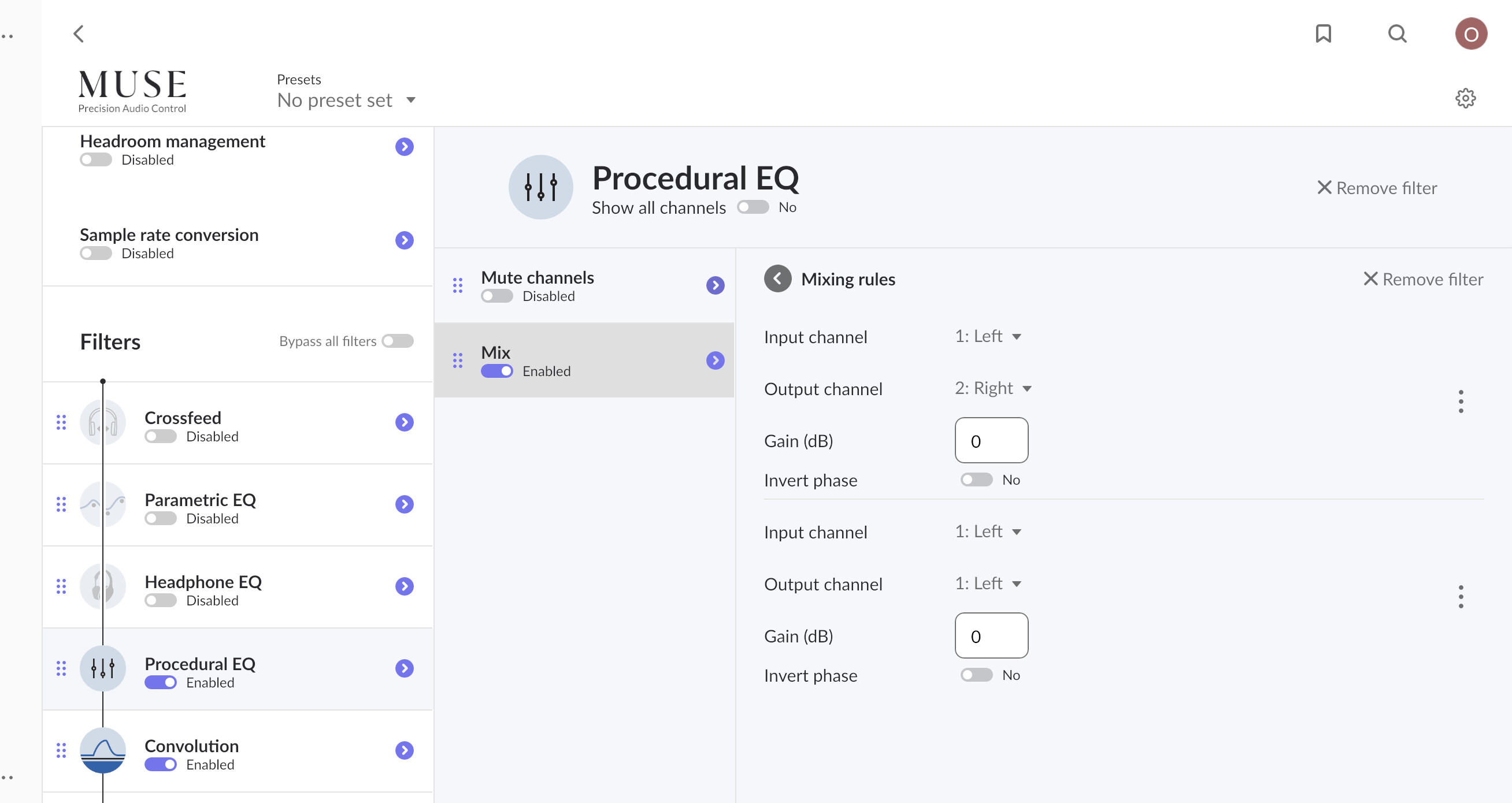

Based on your setup, I recommend using the Procedural EQ to manually map the channels.
Please try the following:
  1. Open your DSP settings.
  2. Enable Procedural EQ.
  3. Add a Mix filter.
  4. Map the channels exactly as shown in the screenshot below.
Let us know please if that helps in your situation.
