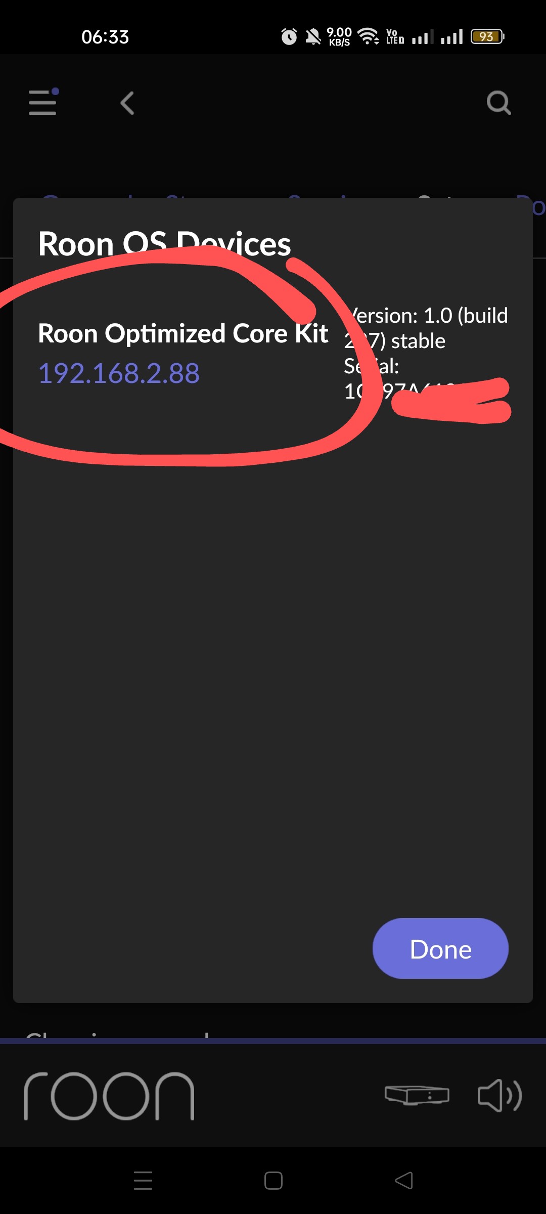

You need to Access Roon OS WebUI from a browser like Chrome or Edge etc. Use the IP address of the computer that runs your Roon core.
In my case, the IP is 192.168.2.88 as seen in the image above. You could find the IP of your Roon core from the setting menu, Setup, and click “Find”.
It will show you the IP and use this IP address in your browser.
But, remember to do it from your “Old” computer to make sure thame backup size is ok.
You could see that in my case I have 94% free of 232GB. So the database is about 6% of 232GB, roughly 13.9GB. If I do a manual backup (only 1 backup), my backup size is about that size.
