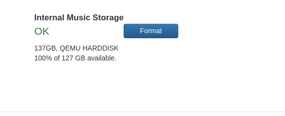

Good news. I took out the 4Tb SSD of the Grimm, booted up Linux Mint off a USB thumbdrive on my PC with the SSD connected, renamed HEAP back to ROONSTORAGE and put the drive in the NUC it was originally in. Roon didn’t notice it was ever gone- it recognised all my music and didn’t even have to rescan or redo audio analysis. Worked straight away. Thanks for the advice here!
Glad that it worked!
I even added a new disk, that I partitioned, formatted (ext4) and renamed before from a live system with some files, it was also recognized as internal storage. So it seems that it is not necessary that internal storage be initialized by Rock, i.a.w. you can add a disk that contains data.
