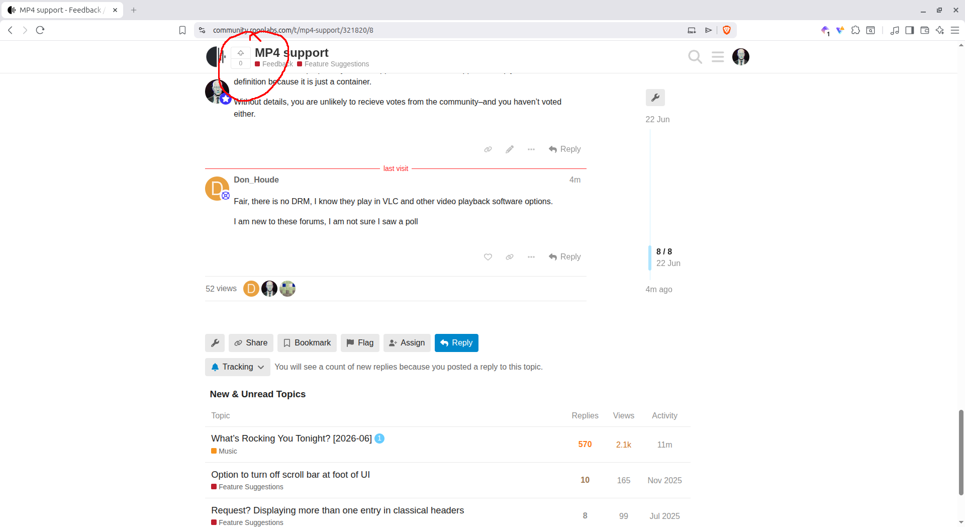

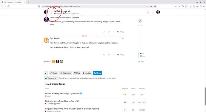

Without details, you are unlikely to recieve votes from the community–and you haven’t voted either.
Fair, there is no DRM, I know they play in VLC and other video playback software options.
I am new to these forums, I am not sure I saw a poll
You should to try them in another music player.
Voting is at the top of the screen.

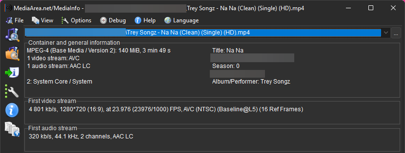

Here is a sample file, and Jamie was right AAC is in this file. But with 10,000 files and multiple sources, I don’t expect that to remain the same.
Hopefully this is enough to prove I actually possess MP4 files that could be playable with no DRM mjw.
