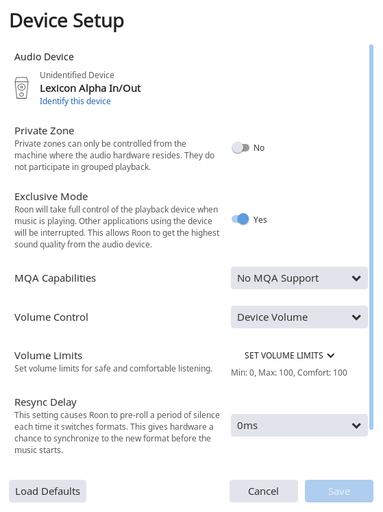

Hello. Having trouble MQA Tidal songs not playing sound through a Lexicon Alpha. 24/48 is as high as this piece of equipment goes. The same song played just fine via the MacBook’s built in speakers. I don’t really care about getting MQA sound that much. Just want my songs to play in 16/44 or 24/48 without me having to worry about them – well – not playing due to this MQA business.

That option outright does not appear where it would for other devices (such as my built-in output)

  • The reason you are not seeing the “Enable MQA Core Decoder” option in your Device Setup screen is because Roon has detected that your device does not support 2x sample rates (88.2 kHz & 96 kHz).

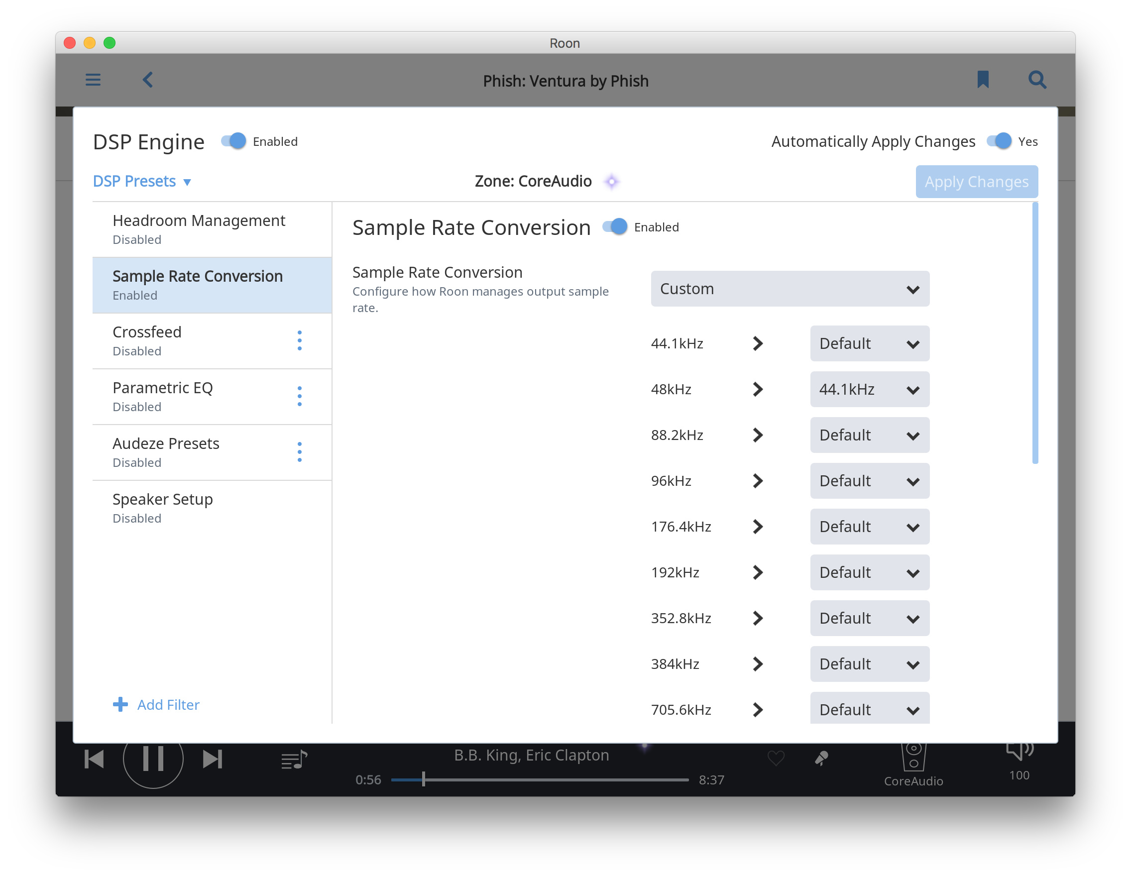

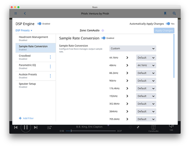

  • Try enabling Sample Rate Conversion in the DSP Engine with a rule to re-sample 48 kHz to 44.1 kHz. The screen should look like this
-John
