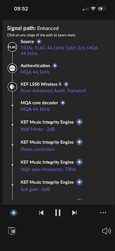

I have the exact same problem on a Kef LS50ii. Just started to fail to decode MQA files from Tidal when previously was fine. Digital distortion / drop outs, cuts in and out very rapidly.
No change in set up. No firmware update. MQA core decoder has always been enabled.

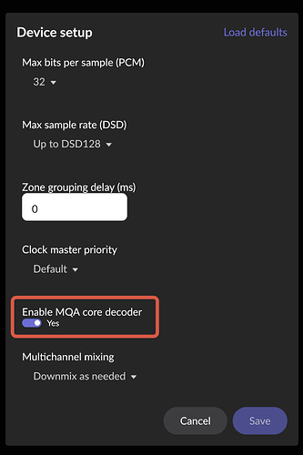

Could you also please try enabling the MQA decoder in Roon settings for the speakers and let us know whether that has any effect?

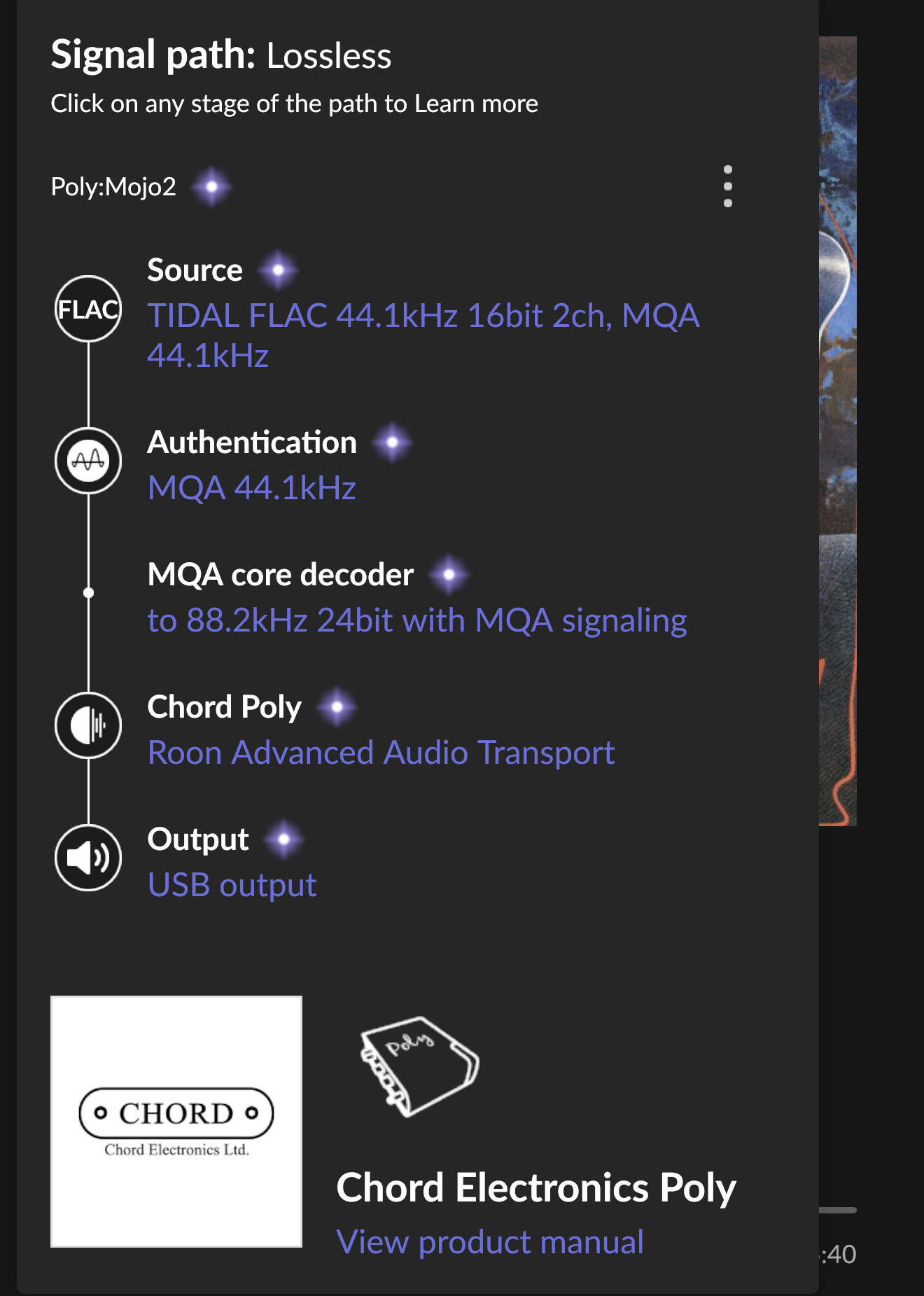

The OP’s screenshot showed that MQA decoding was taking place entirely outside of Roon. There have been no changes to Roon’s MQA support in any recent release. Tidal hasn’t officially supported MQA content since 2024, although they still serve much of their catalog in MQA as they transition to different high-resolution formats.
If you have a different device from the OP, then you’ll very likely require separate troubleshooting steps. If you can share a screenshot of you Signal Path, we’ll split your post into a dedicated troubleshooting thread.

If your setup is the same as the OP, have you also tried switching on Roon’s core decoder?
Yes, i have switched off KEF MQA to use Roons MQA decoder, the sound is slightly better but still the same rapid digital drop outs occuring.

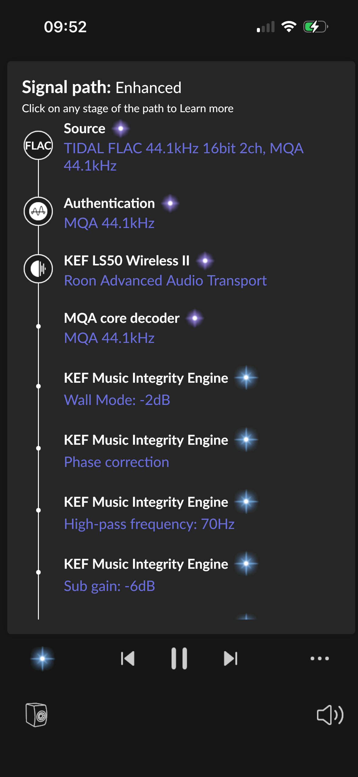

the KEF is decoding MQA

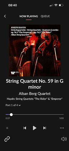

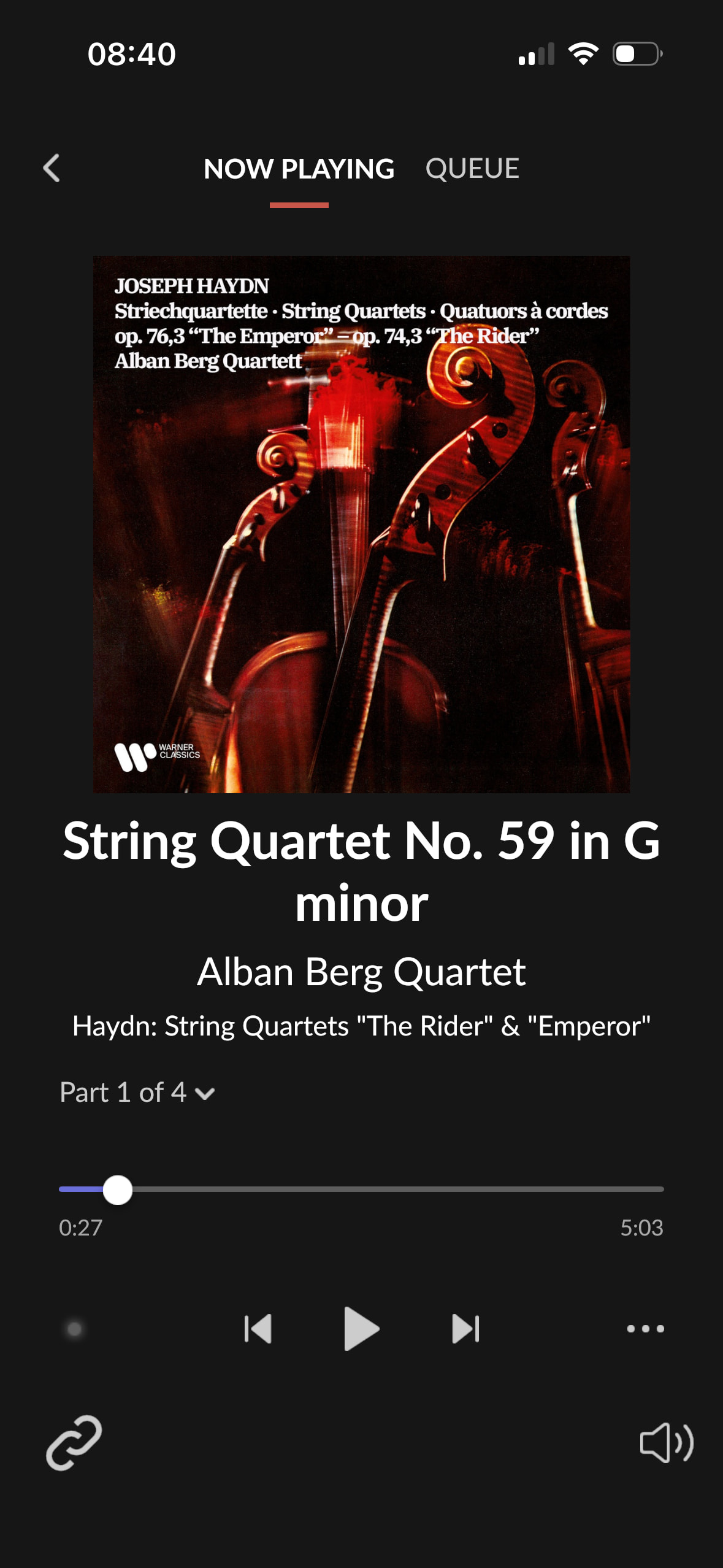

This screenshot doesn’t show Roon decoding MQA.
This is what it should be like.
Have you set Roon to decode in the endpoint settings?
Ensure Roon is doing the decoding and I’d also disable the Kef DSP options one by one to see if one is the cause.

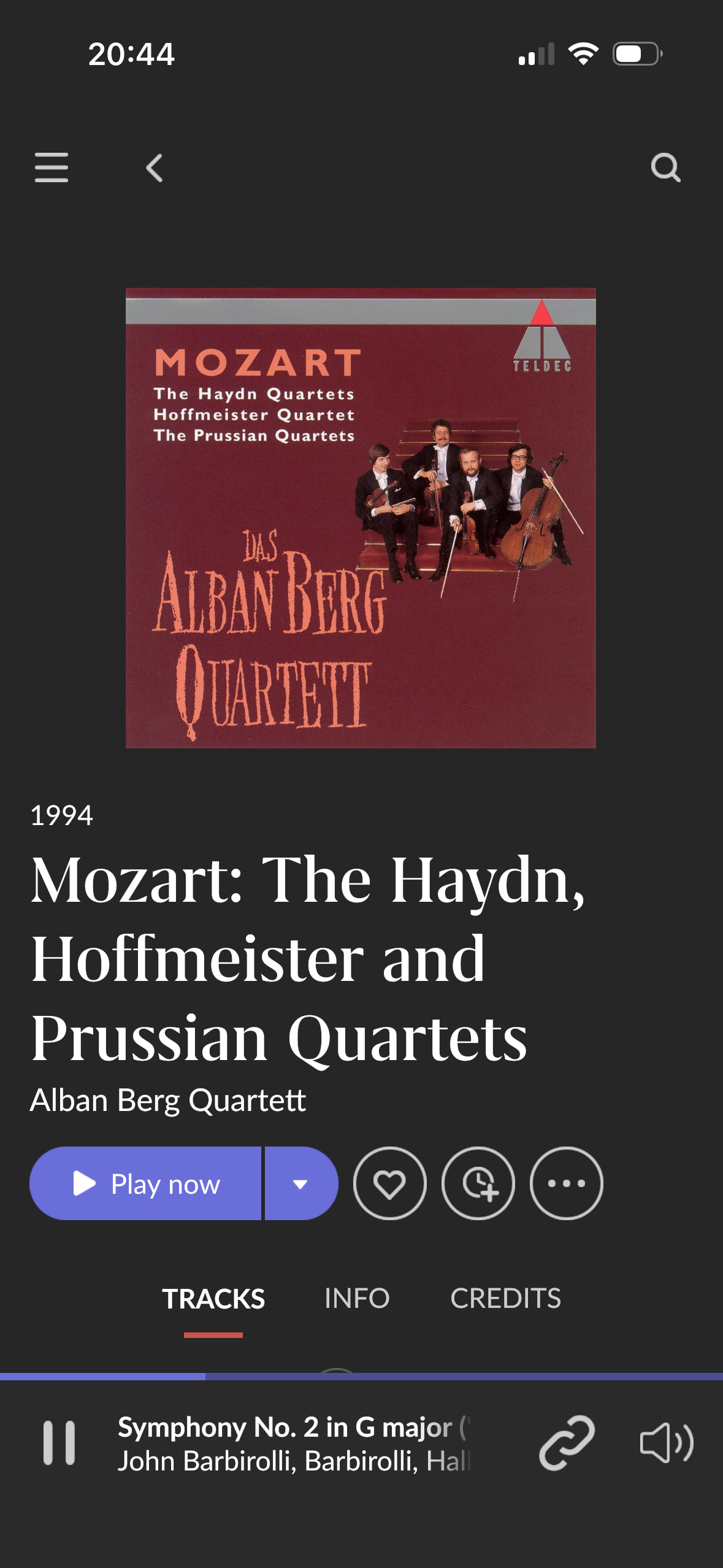

Also which version of the above mentioned album. The 2011 Remaster? If so, when I applied volume levelling, it applies a -6.7dB to the album. The other version -1.7dB.

I fully appreciate your response, however MQA handling inside the Kef’s is most likely the issue here. More specifically, your Kefs.
