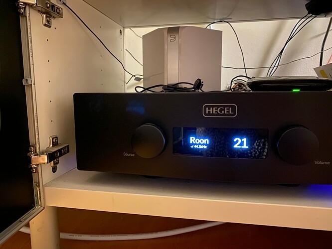

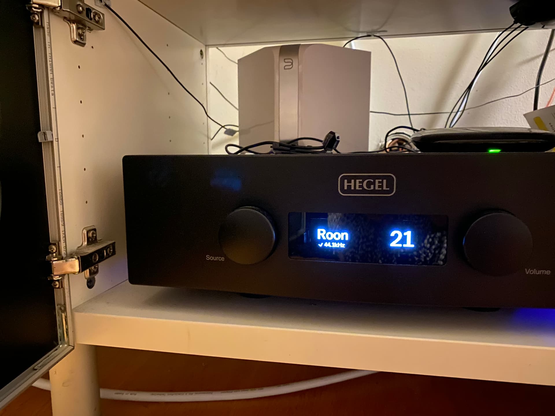

When I started to play an MQA track on my Hegel H390, I couldn’t get the amplifier to recognize the track as MQA. I only got it to decode it as a basic 44.1 kHz track.
I tried to switch to my Bluesound Node, but also here I only got the amplifier to decode it as a basic 44.1 kHz track. Previously when I have checked, playing over the Bluesound always resulted in the amplifier recognizing the track as MQA but not this time.

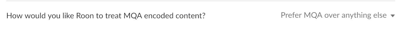

I went back to check my settings, googled a bit, and found the setting “How do you like Roon to treat MQA coded content?” that I hadn’t seen before. I changed it to “Prefer MQA over anything else” and retested. Still no MQA indication.

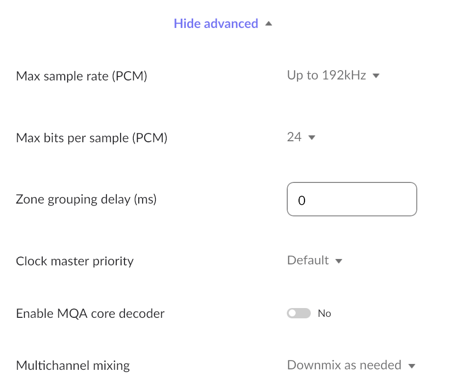

Device Setup (1 of 2)
Device Setup (2 of 2)

Amplifier display

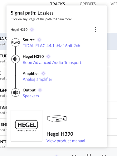

From your signal path you are playing a nonMQA file. Pick a file you are sure Is MQA and try that.

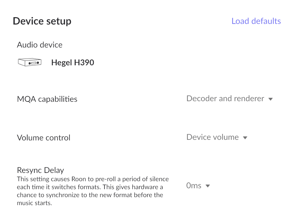

Also in your device settings for the Hegel try setting it as renderer only. Looks like for you that is enable MQA decoder.

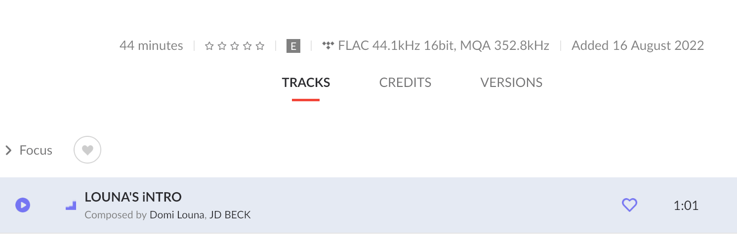

I am playing an MQA track, please see image #1.

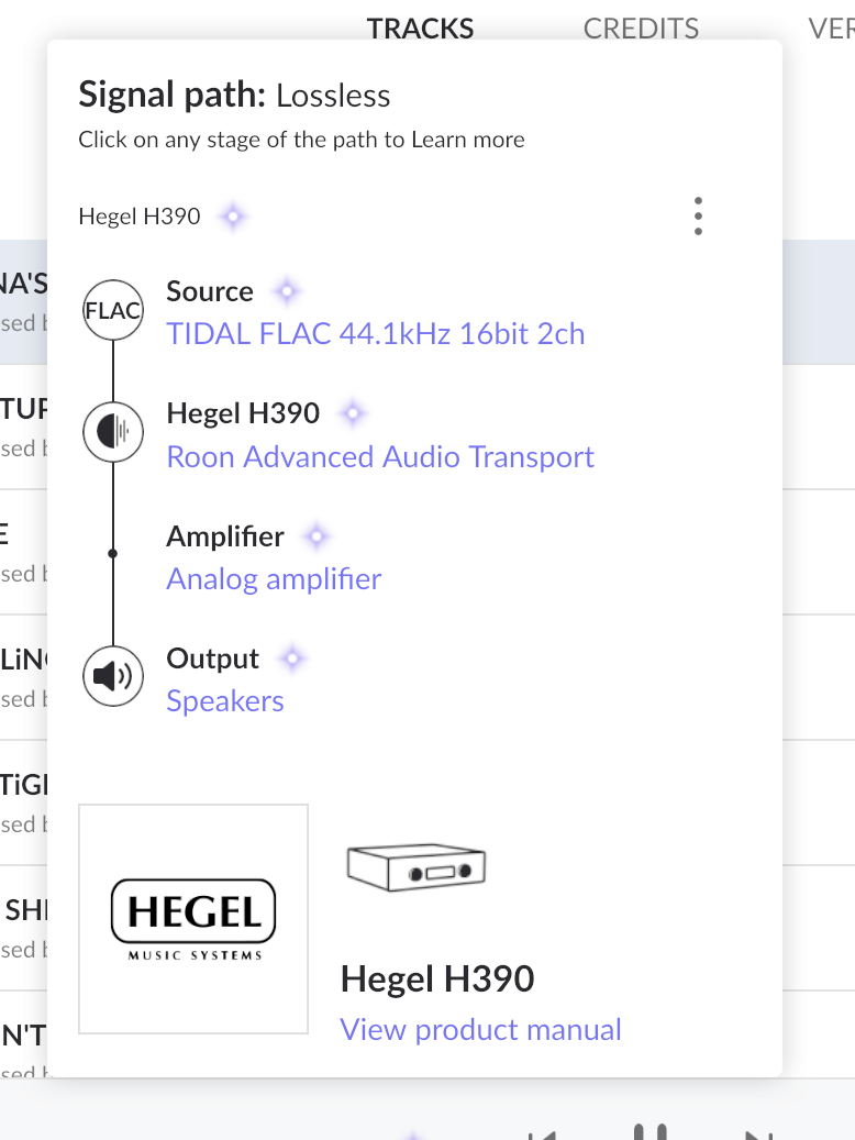

Image #3 shows the Hegel set up as Decoder and renderer. Are you referring to some other setting?

Yes is there a render only option? Try that.
Despite image 1 your signal path in image 2 says it is not an MQA file. Try something else.
Yes, there seems to be some kind of tagging problem in Tidal. Even though the album is tagged as MQA, the tracks are not.
When I test with another MQA track, everything looks OK.
