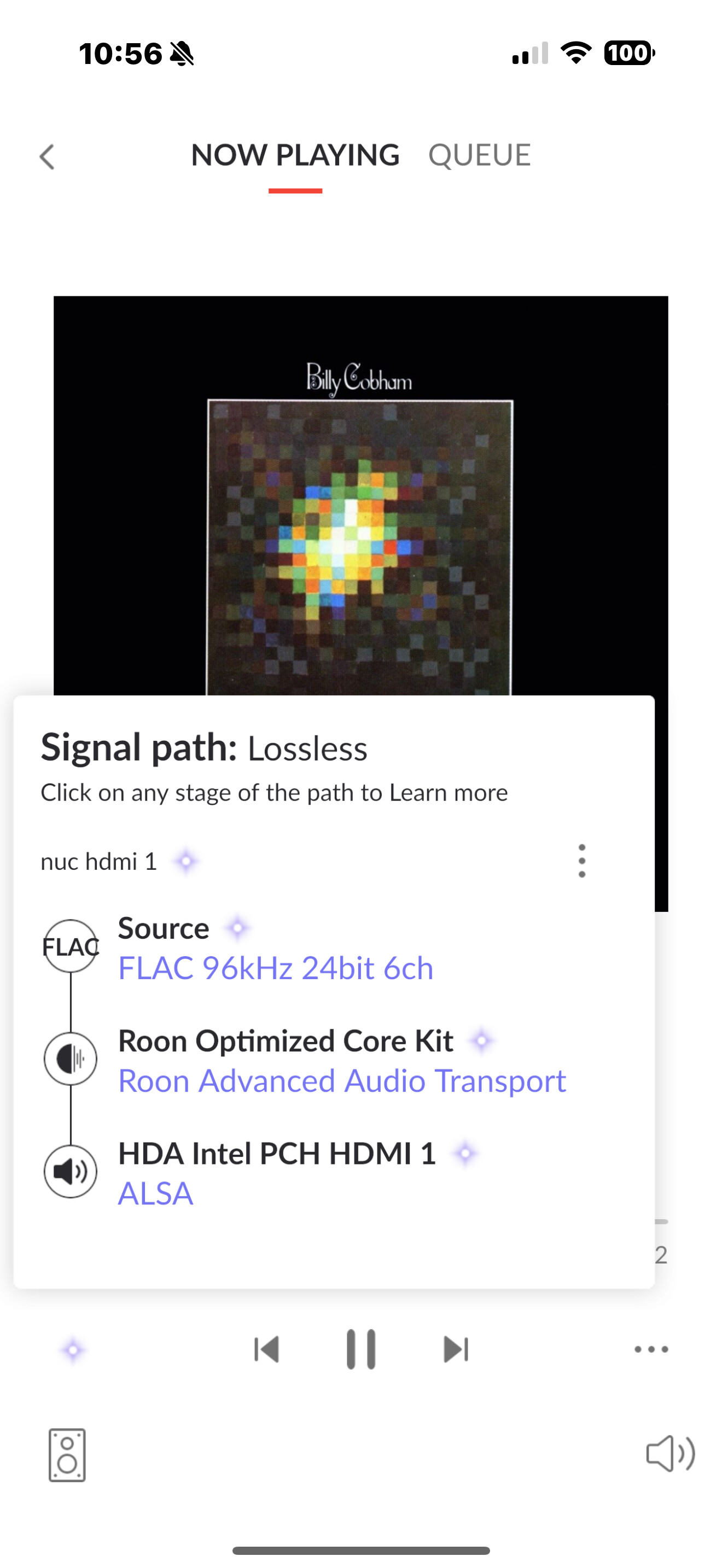

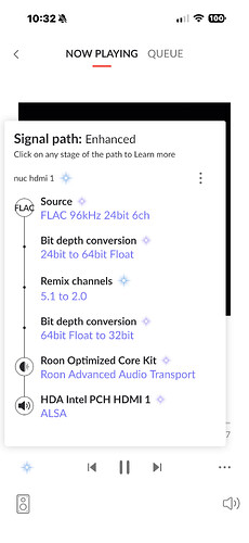

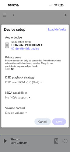

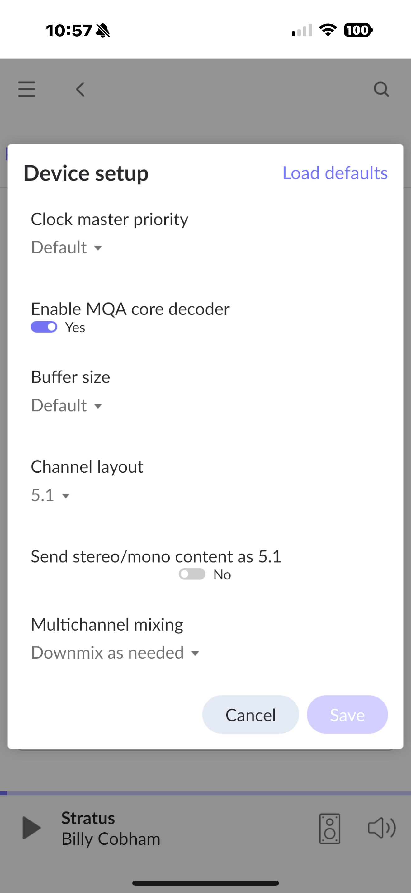

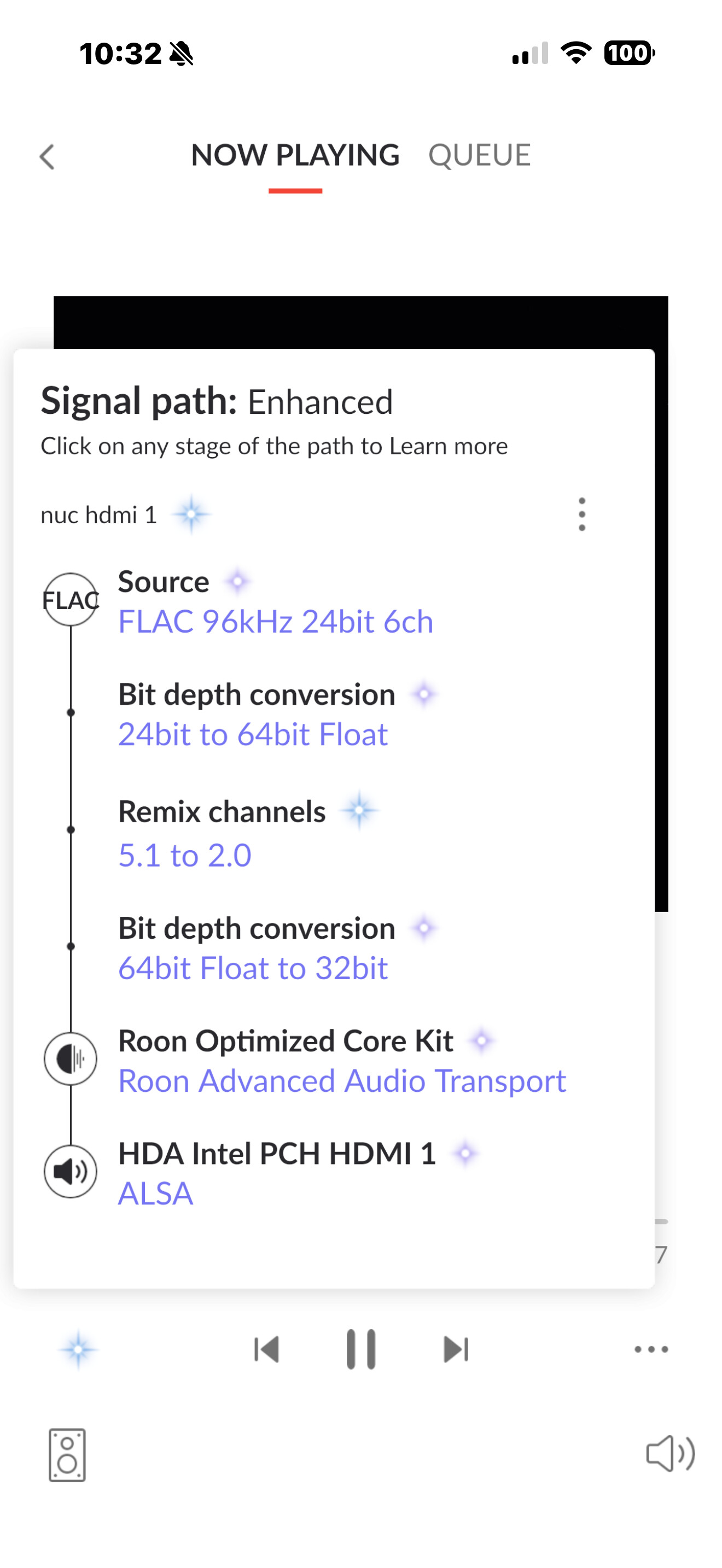

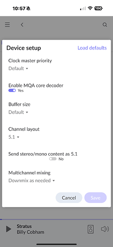

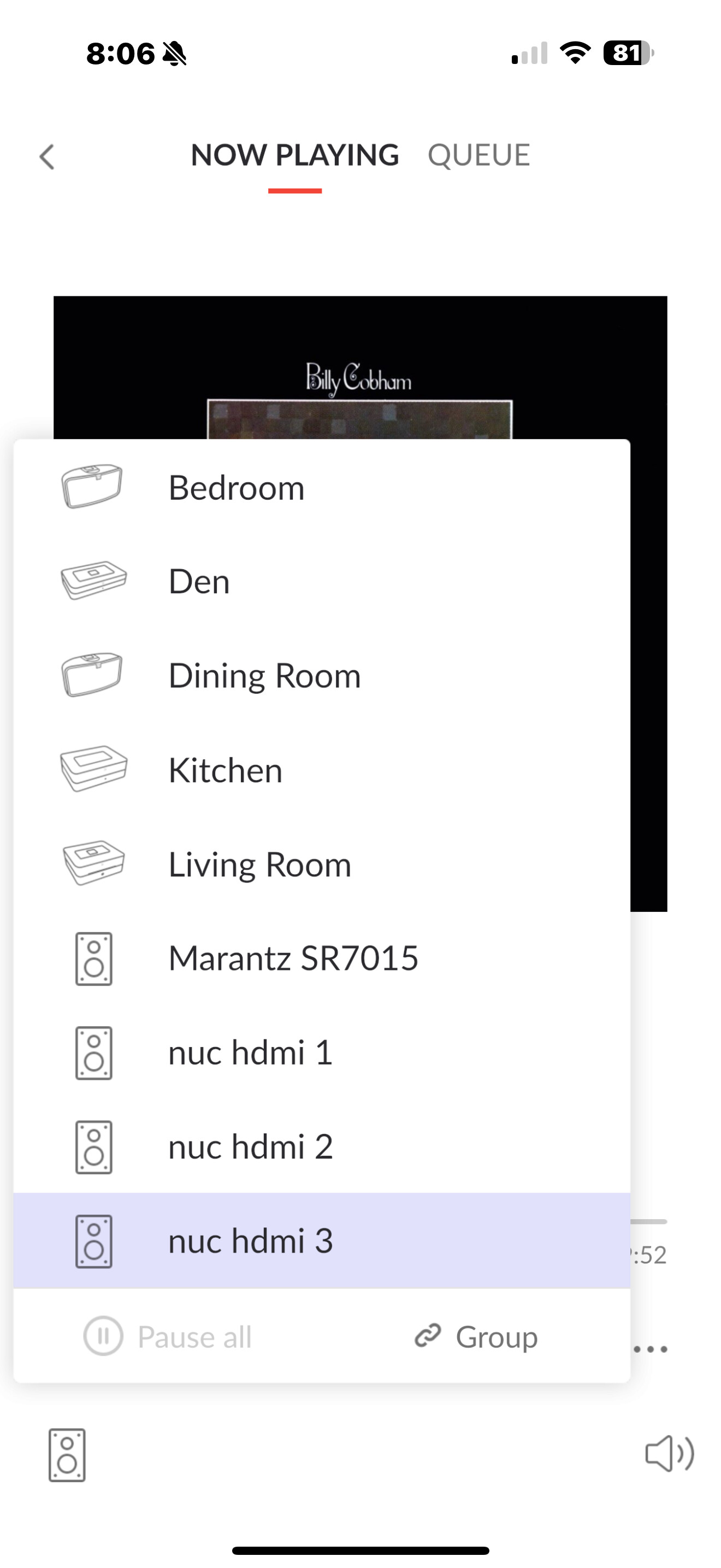

Hi. I’m not sure why, but it started showing multichannel output on HDMI 1. (May I disable MQA decoding without causing problems?) Please see below photos. In the first, you can see that it was down-converting to stereo. The last four show multichannel. Thanks for your help.

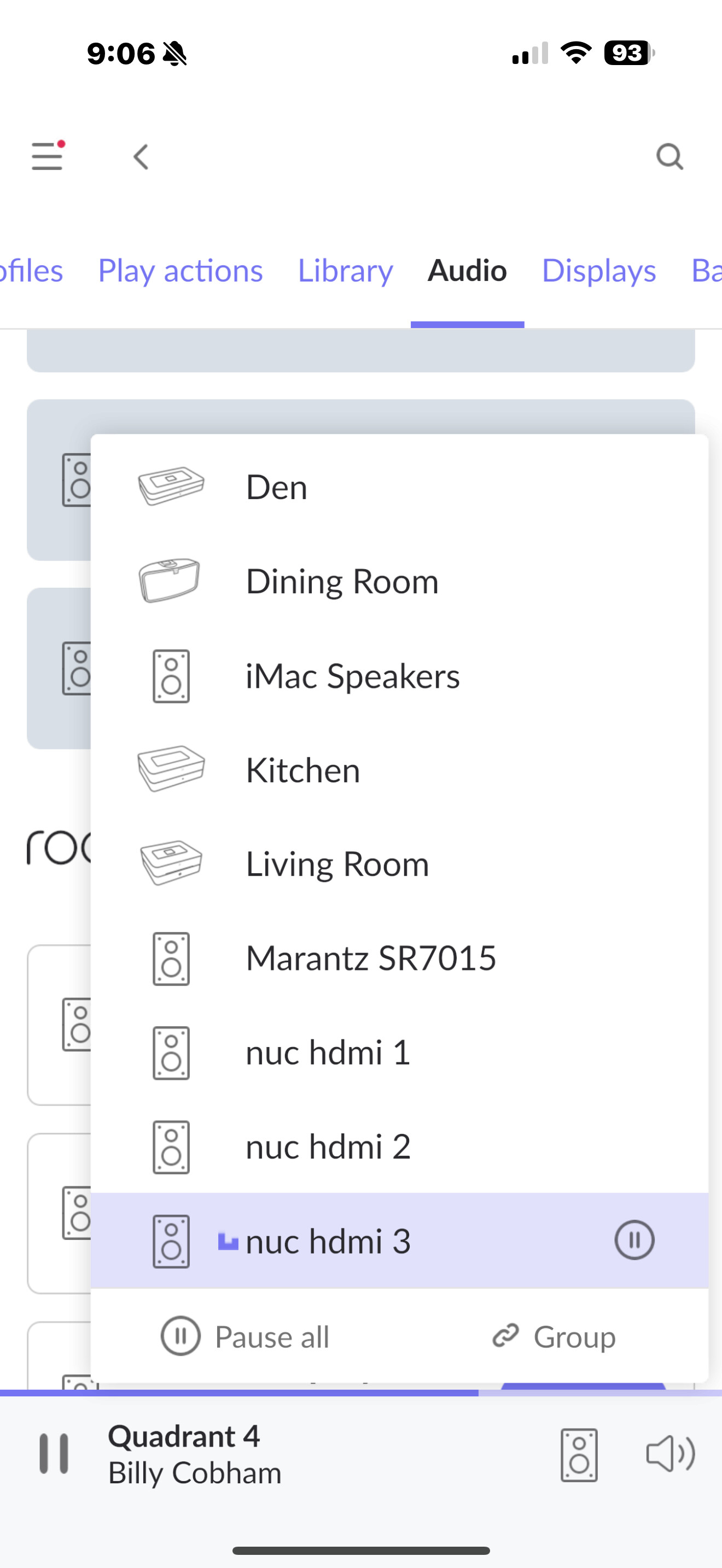

One minor issue: though Roon shows 5.1 audio playing, I get no sound. I have tried HDMI 1, 2, and 3 of the NUC’s outputs, and the Marantz displays the NUC’s ROCK boot screen, so the Marantz appears properly configured.

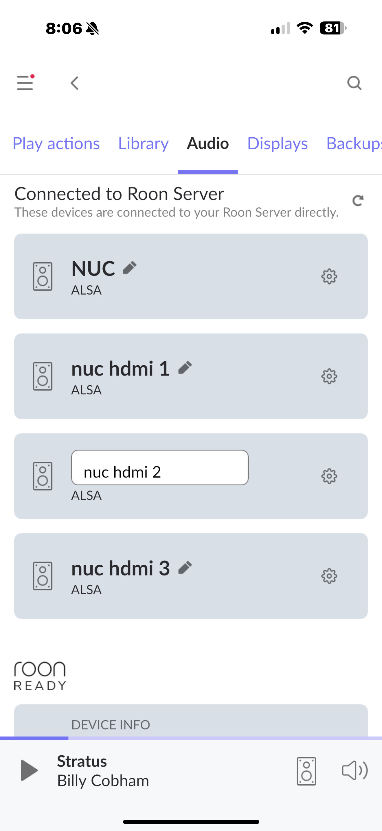

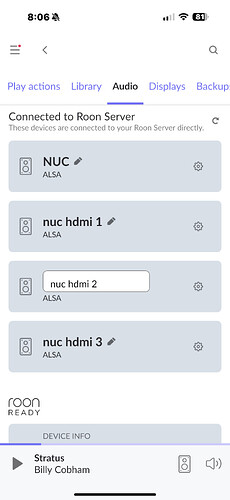

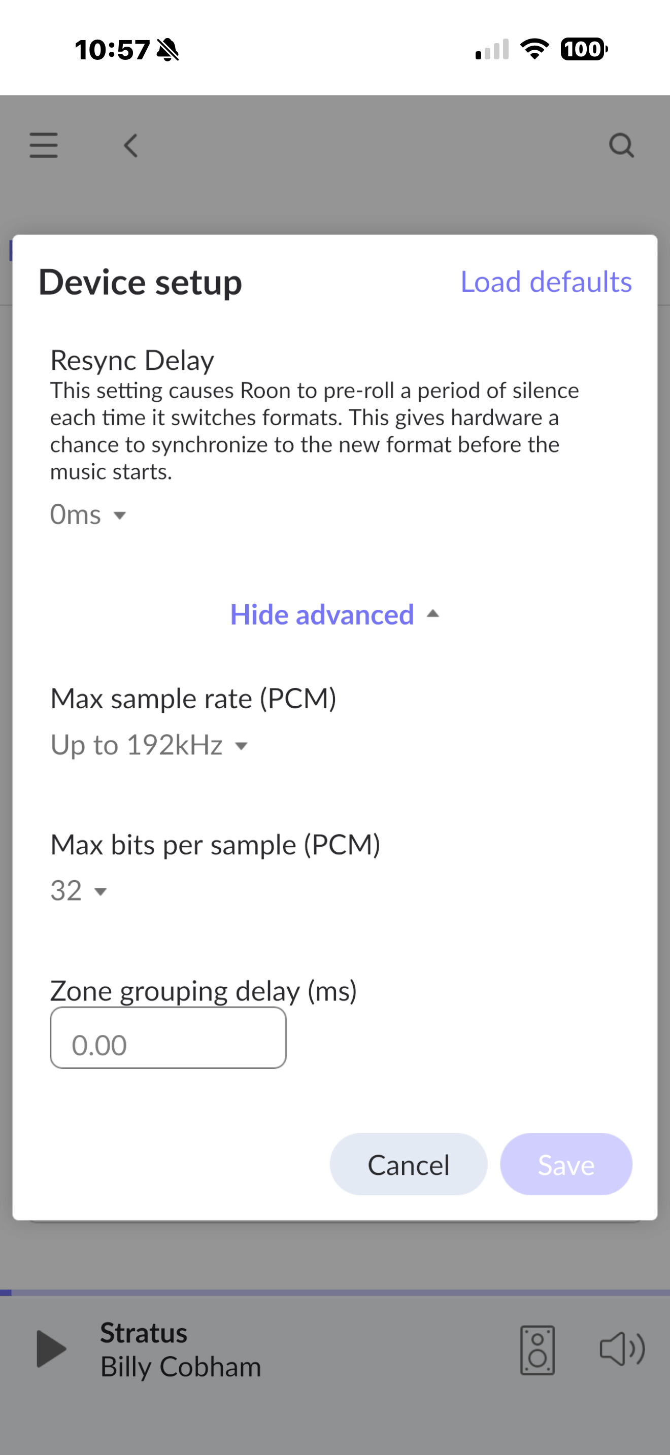

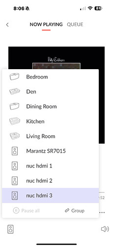

I tried disabling CEC on the NUC, to no avail. Some have suggested that multichannel works only on HDMI 0, but Roon does not show HDMI 0 as an option. Roon’s Audio setting shows a plain “NUC,” without “HDMI,” but I can’t select “NUC” as an output. Please see below screens. Thanks.

I finally solved the problem by renaming “NUC” “NUC HDMI 0” and plugging the cable into the 2 port. I disabled CEC, too, but I don’t know whether that move helped.
Seems strange that renaming the output apparently solved the problem.
