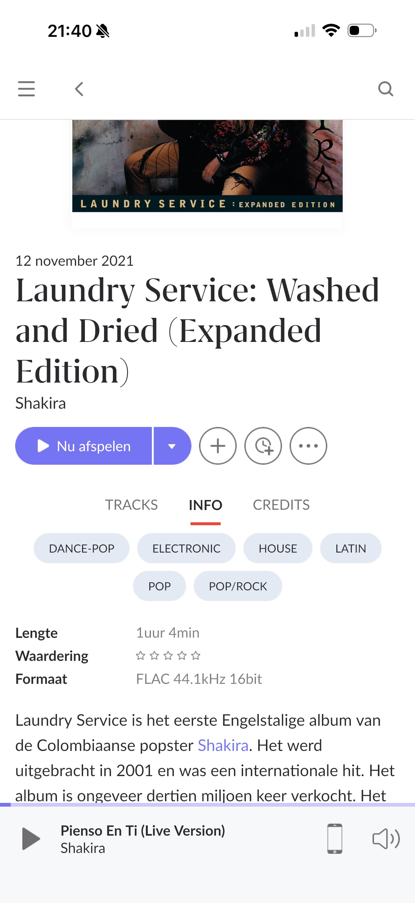

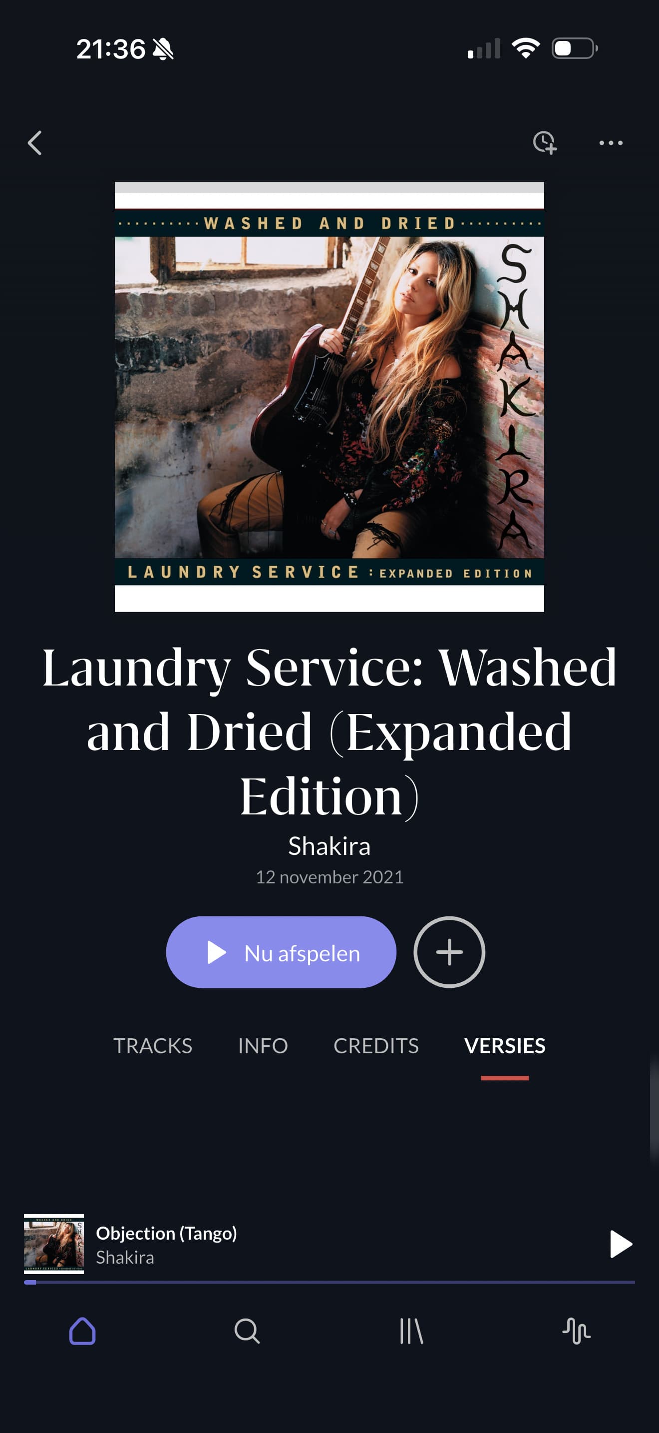

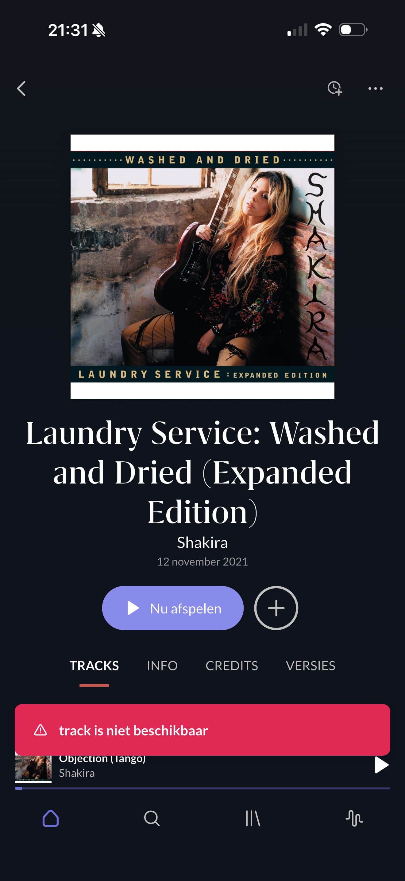

Several albums are not playable via Roon arc. Therefore, no albums are visible in an album on the versions tab. In the Roon remote app, these are playable. But not visible is of the album a Qobuz or a Tidal album is. See an example of an album below.
I figured out that when I add the album to my library in the roon remote app, I can play the album in Roon Arc.
So via Arc I can only play albums that are in my library and no other albums.
I note that all these albums are not in the Roon library. I also see that the Versions tab is empty.
Try to add them to the library by clicking the (+) button. Most likely, the Versions tab will populate and the albums will became playable.
