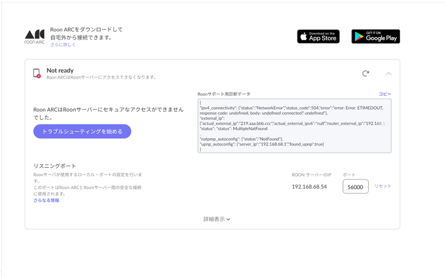

Please share a screenshot of the Settings → ARC page within Roon where the diagnostic snippet related to port forwarding will be displayed.
I have changed the port to 56000 from 55000 manually using deco app. I think the messages are the same as port 55000. ARC is working fine at home but when outside it is not working with the error of “port forwarding issues. Check your setting of the roon server” .

If you’d prefer to continue troubleshooting port forwarding, that’s completely fine too. In the screenshot you shared, we see the message MultipleNATFound, which usually means there are two routers in your network. Placing one in bridge mode should resolve this error.
