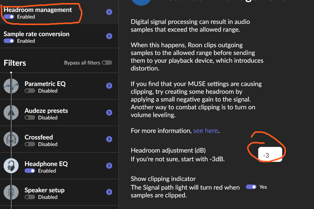

My Intel nuc is the 12th generation Corei5, but if you upsampling to DSD512
“Processing speed: 2.0×” is displayed, and a clipping error occurs in rare cases.
Whatever sounds good to you. That option is for stability of the system, if your soundpath can handle without crashing and it sounds good. Go for it.

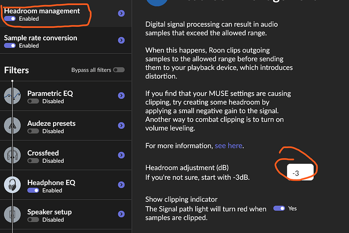

As for the clipping issue, I’d recommend “turn on Headroom management” See below, hopefully this would get rid of the clipping.
