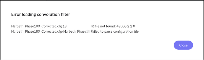

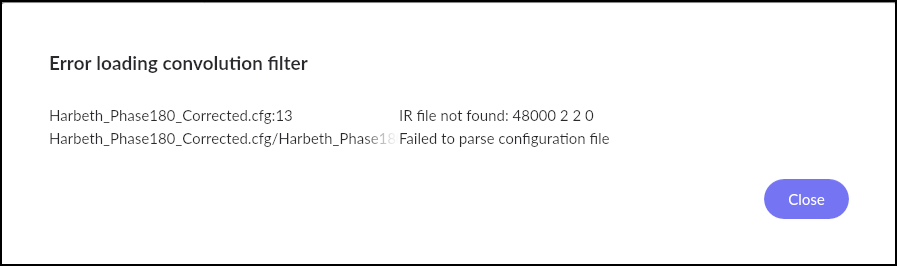

I’ve been trying to load a multiple filter convolution file into MUSE but I keep getting this error:

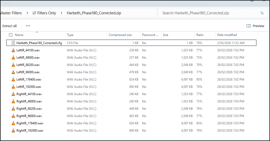

Here is the content of my zip file:

I have also tried including full path to the wav files in the cfg file but still got the same error. Any advice on what I’m doing wrong and how to fix it would be appreciated!

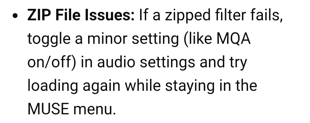

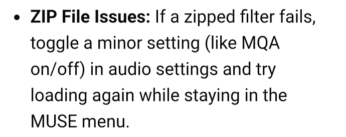

Just found this titbit , not sure why it might work but I guess you could try it.

I tried the “titbit” trick but sadly, same error :frowning:

Here’s the latest update. After much trial and error I worked out that what was causing the errors was the zip file itself. I had been creating the zip file by highlighting the cfg and wav files and using “Compress to” in the Windows right click menu. I began to suspect there was something wrong with the internals of these zip files so I decided to try the same process using 7zip. Highlight the files, and select 7zip from the Windows context menu. This produced the same error. Then I tried opening the 7zip app, adding the files straight into it, and creating the zip file that way. Much to my surprise, this created a zip file that Roon was happy with! I have no idea why but for now I’m just going to enjoy the music!
