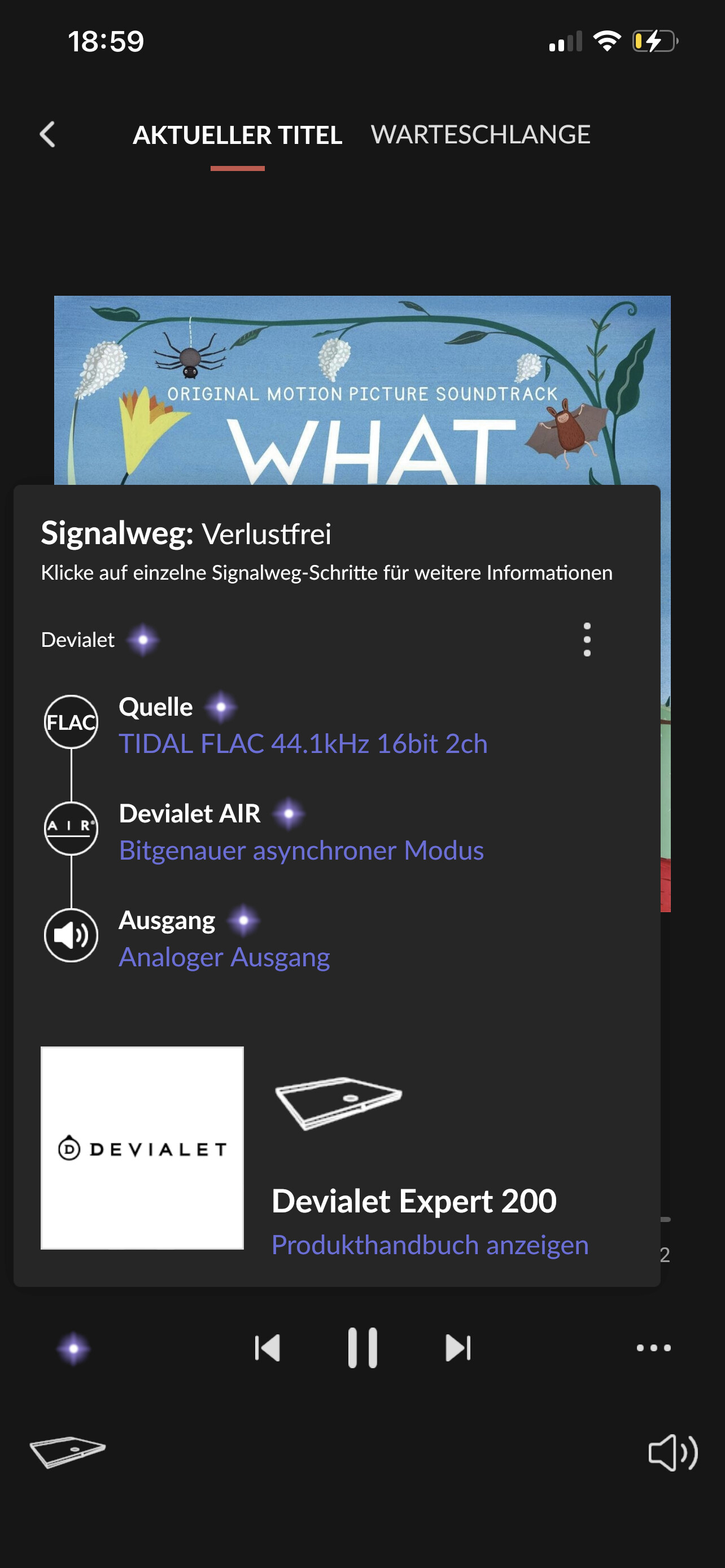

Music sounds quite often totally broken or even stops playing. Or can’t make it to start playing.
But sometimes I can play for days or weeks without a problem.
Sometimes I think the problems comes from the internetconnection or from the Wi-Fi - I tried to connect the devialet amplifier direct to the core via Ethernet, but I couldn’t get it working together.
I run Roon since 6 month and the problems are there since the beginning. I can’t fix it.

The issue is not limited to the Devialet, but all the tother speakers are on Wifi as well. I still have dropouts. Last time only a restart of the mac mini helped.
I have a long crossover ethernet cable, but couldn’t make it work that the Devialet plays music with it… Do I need a normal one ? or any tips ? (between Router and Devialet is a PowerLine LAN) …
Thanks. Tillmann
