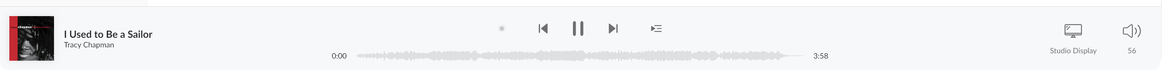

Photo of player
The play head is stuck to 0:0 min, the play animation “plays”, but no sound is to hear.

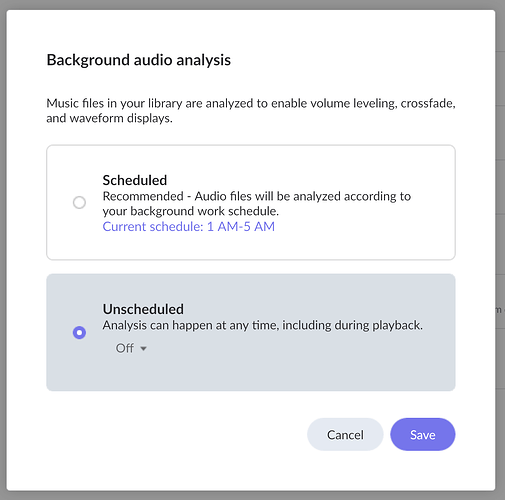

I have set the Analysis to Off:
