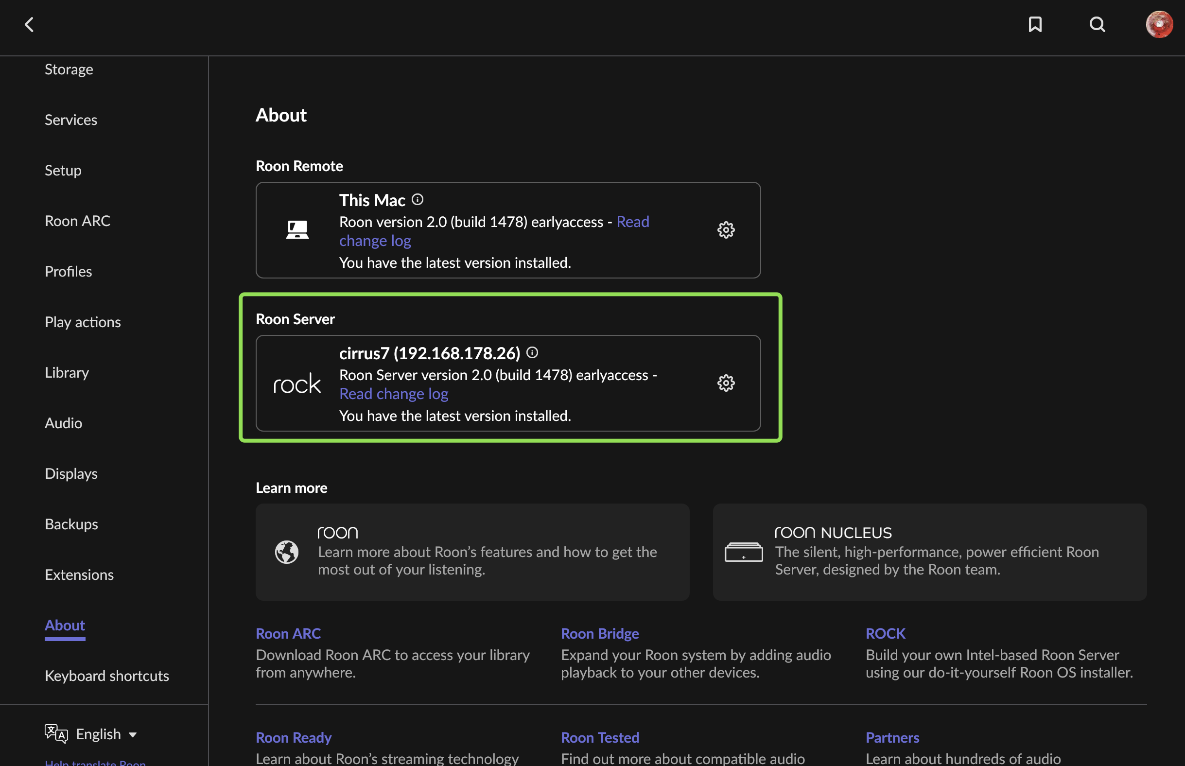

It’s the final step of the installation instructions, “6. Installing Codecs and Setting Up For First Run”. The first sentence is about the codecs. The second sentence is “Be sure to also confirm that ROCK is on the latest version. You can trigger ROCK to update by selecting Reinstall from the Web UI.”
It’s a bit strange to me, if your ROCK isn’t up to date. What does it show there?
