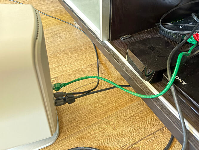

Hi @vadim thanks for the reply.
I factory reset the speakers to make sure all trace of the wifi is gone.
Retested and same issues.
I then moved the speakers to the lounge to connected them directly to the EdgeRouter X and also connected the Mac Mini directly to the EdgeRouter X.
I re-tested and had the same issue at these times today (NZST):

Yes I did test bypassing the switch with wired connections as the above photo showed.
